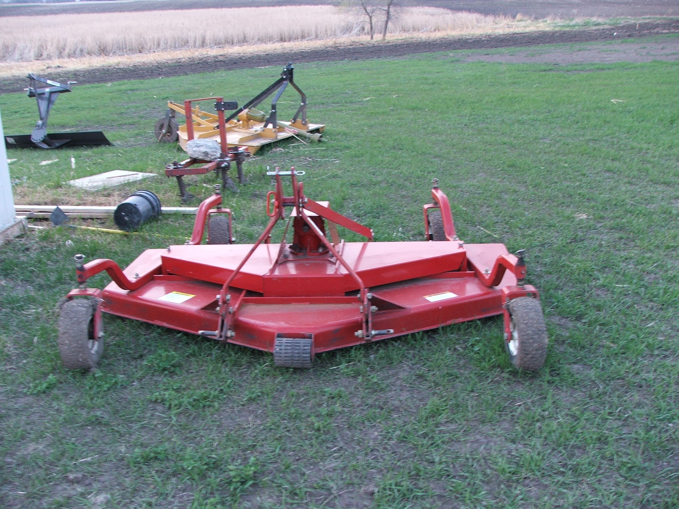

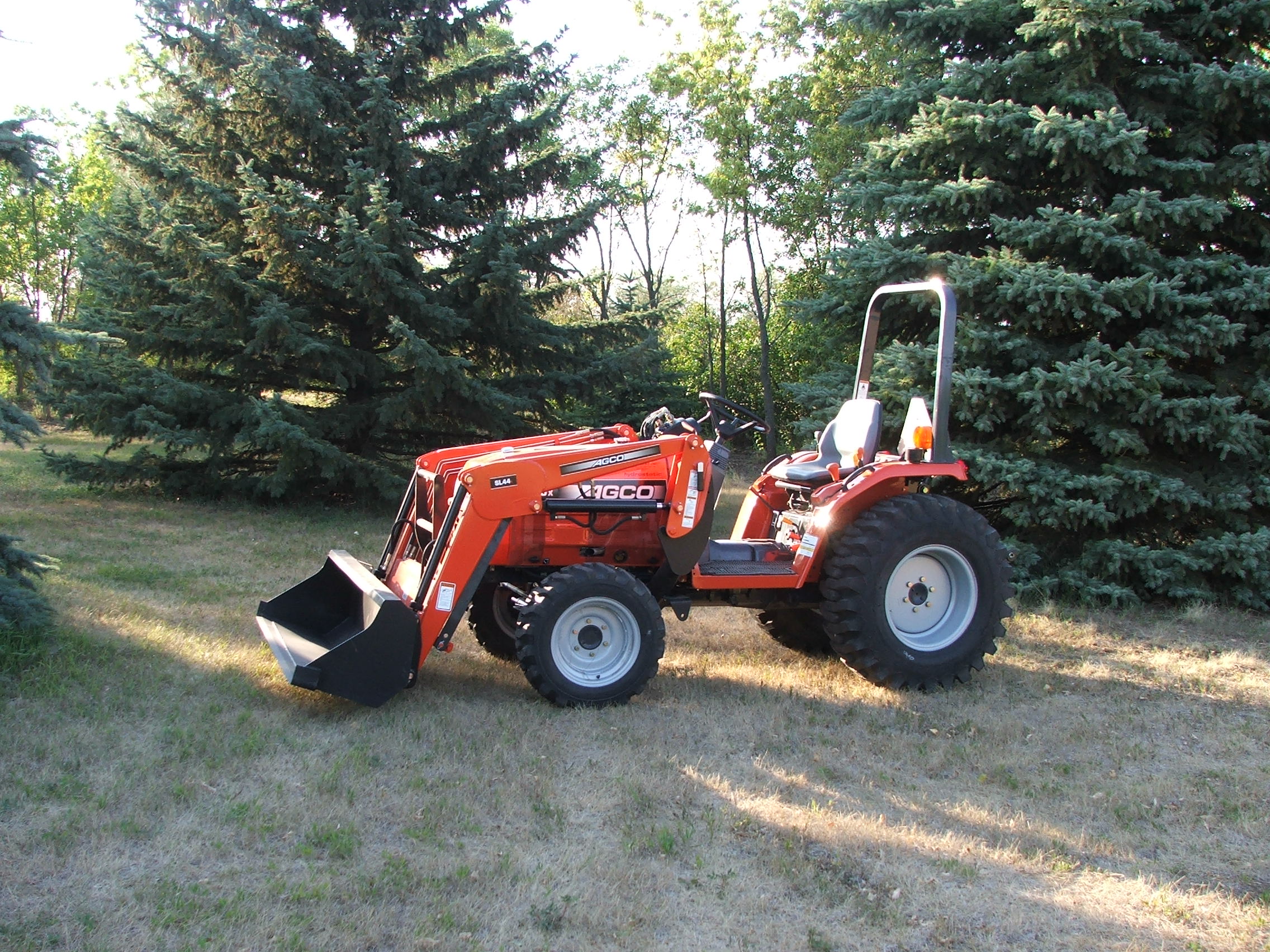

/ LandPride Finish Mower #18
I use a Buhler (farm King) 84" behind a AGCO ST30 (basically a massey 1428) 28.4 engine horsepower i beleive. and i have no problem, I only mow the grass in the yard and i use my 5' rough cut mower for anything over probably 6 inches. the tractor will lift the mower alright but i rarely lift it because the front end gets light without the loader on, usually i dont even hook up the toplink.
