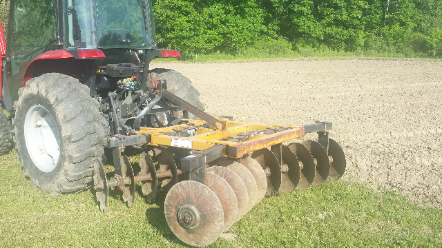

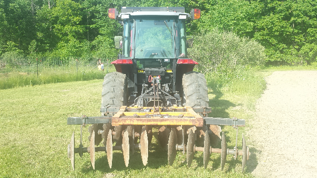

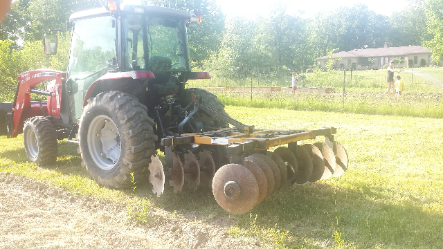

Well, picked up a 6.5' KK box frame disc today. Weighs around 800lbs. I had never priced them out at the store until now ... this thing sells new for around $1500 !!! Crazy
Picked this up for $700 ... pretty happy about that. It could use a sanding & fresh coat of paint, but otherwise it's in great shape.
