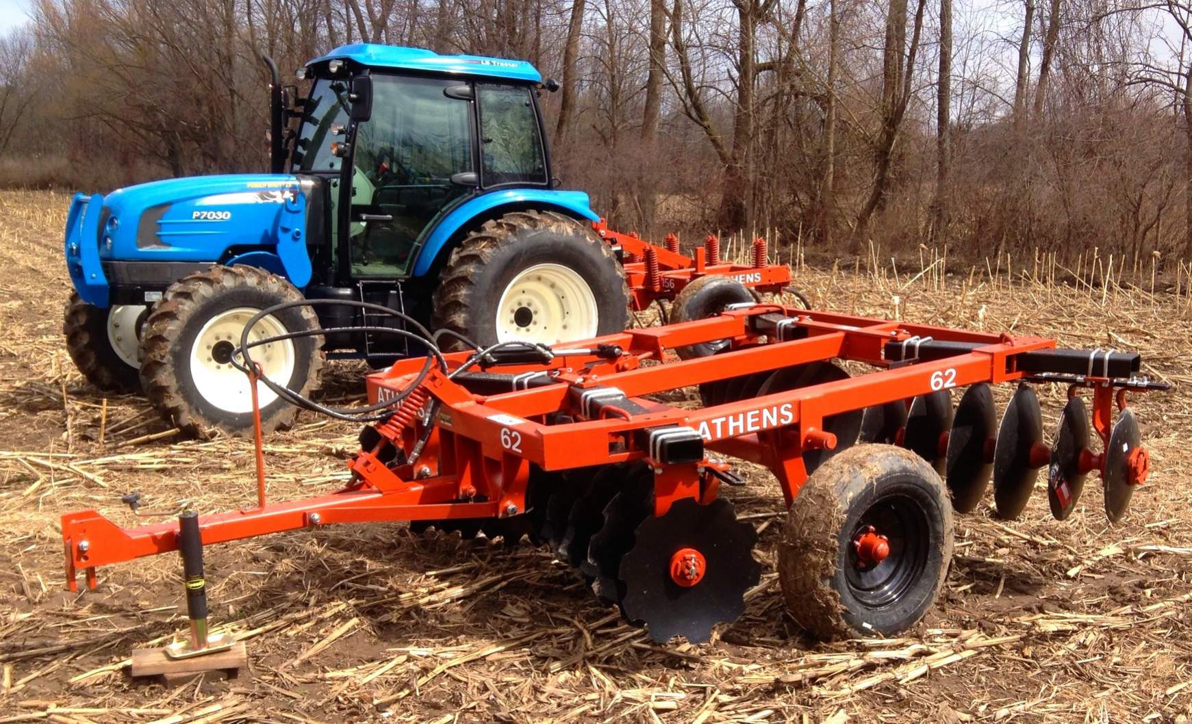

TSO,
I just did a little over 10 acres of what you are doing and chisel plowed in the direction of the tracks followed by a disc with drag harrow at a 45 degree angle and it worked great.
You can get it done with a disc alone but depending on the wetness/hardness of the soil you might have to make lots of trips.
I spent months looking for a used chisel plow and transport disc and ended up buying new. I have an 8'6" Athen's disc that I can pull behind my pickup for road trips. But I think it would be a little much for your tractor.
I would Round-Up all you wanted to do a couple weeks before hand and go at it with the biggest disk your tractor could handle.
Or you could always get a bigger tractor so you could pull the big toys! You know you want to.....
Dave
I see you've got the gangs in the least aggressive position. That's the difference in a heavy duty disc like that one versus the lightweight ones. The lightweight ones have to be in the most aggressive position to do anything on unbroken soil except just roll along on top of the ground.

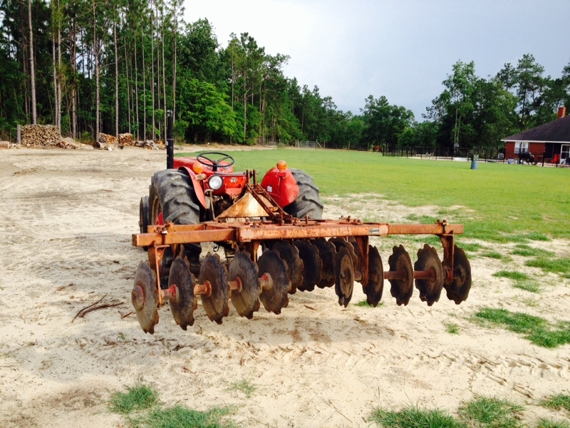

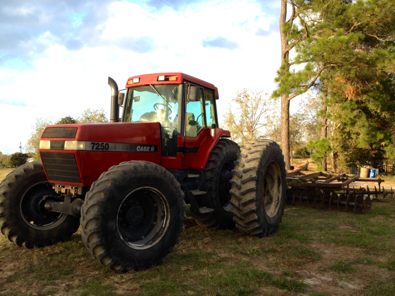

My 135 pulls my 8 foot disc just fine in the sandy top layer of dirt we have around our food plot
Of course if it was me I'd use my big 21 foot disc
