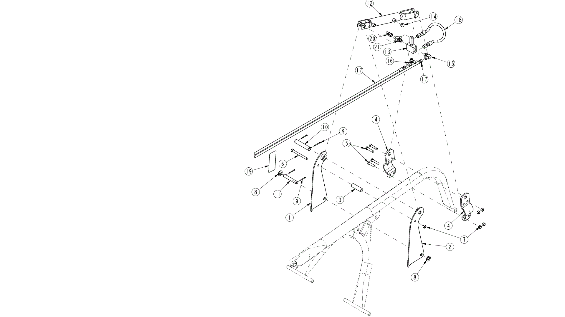

My neighbor has a Land Pride PD-15 post hole digger and it doesn't work too well in our hard clay. Land Pride sells a hydraulic down-force kit for it (317-027A).
Anyone have any experience with this setup? I'd sure like to hear from anyone with experience before I shell out $700+.

The diagram is showing what looks to be a hydraulic top link with a a few brackets. I bet you could make one for alot less than $700.

I have one on my speeco post hole digger, but mine only cost me a little under $300.
it had to be plumbed in a bit different than a top link, as it opens under pressure, but retracts by itself , when you raise post hole digger, and dumps into hydraulic tank. I was able to do this pretty easy on my kioti by adding the backhoe adapter to hydraulic fill port.
all i can say is whenever my post hole digger gets stopped, a tug on my rear remote and its back to digging. I dont recall what force it added to digger though.
also you will need to have at least 1 rear remote available.
