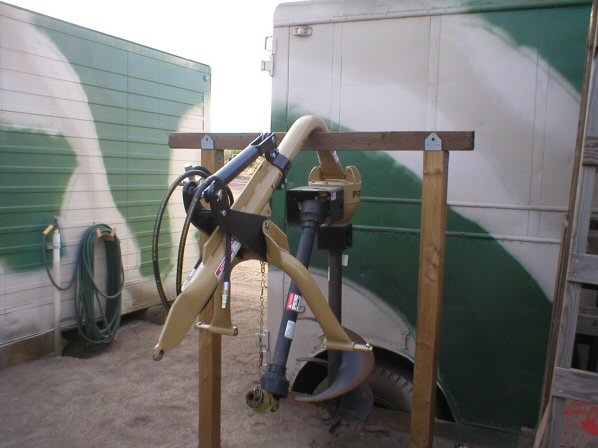

I need more down pressure on the Land Pride PD10. They make a down pressure kit for it.
Anybody know if I have to also install an additional valve to actuate the down pressure cylinder on a Kubota B7510?
Yes you need hydraulics from somewhere.

I understand I need to hook up to the aux hydraulic port, but I didn't know if the down pressure kit had its own control valve.

yes you need a valve.
   / Land Pride PD10 on Kubota B7510 #7
It is a single acting hydraulic, so you will need a drain to tank connection also. The kits are great, but you do need all the correct connections.

I knew I had to supply the return line but now I'm going to have to find the appropriate valve as well.
