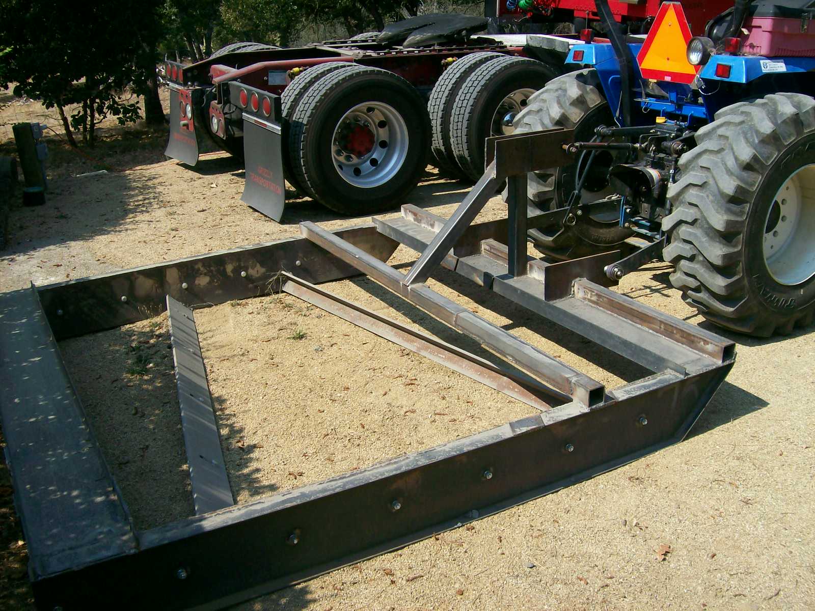

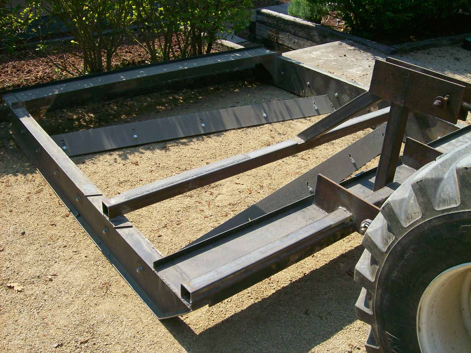

Pic's of the one I built last year . 7' wide x 7' + long pulled behind a New Holland TC 30 HST with loader . Driveway is 800' + feet with at least 1/3 being a grade of 7 to 8 % . Crushed Shale , ( not 3/4 minus river rock but actual crushed shale ) is our road base . Blades are just 1/2" x 6" flat stock that I beveled on the lead edge with plasma cutter . They are attached to 3/8" 3"x3" angle that is welded 1/2" above the bottom of side skids . Slots in blades allow for 0" to 3" cutting , but 1/4" to 1/2" is really all I needed . Pictures were taken before I added additional cross braces , beveling blades , and something else I did (???? ) , But dang thing works and tractor pulls it great .
Fred H.

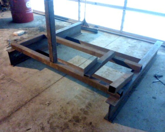

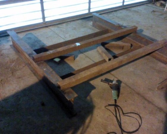

well here's today's build progress, went and borrowed a plasma cutter and wow does that do a heck of a good job. going to go hunt down some cutting edges tomorrow, a local welding shop is big into handling plows and he always has a little of everything. but im just going to do a happy medium and go half an inch below the skids and later down the road build something else for it. but in really dreading drilling that 1/2 angle iron for the bolts. i just got the two pieces of tubing welded on before i ran out of gas for the welder :eek: should have looked before i started. should get more done tomorrow. :)

If you borrowed the plasma cutter once , try again . Rather than drilling , plasma torch will blow threw your holes in just a few minutes . I did all my holes and slots in blades with-out pre-drilling . Just hold torch at a slight angle pointed away from you and squeeze the trigger . Took less than 2 seconds to blow threw 1/2" plate . Sure hole will not be perfectly round , but mine are pretty close for farm implements .
Fred H.

When I drilled the holes I used a small pilot cnc bit 1/8" then ran a 5/8" bimetal holesaw. Works well enough and the advantage of using a hole saw is that it doesn't have to remove all the metal, having the slug or core makes it easier to drill. To assure proper fit and alignment I first clamped the grader blades in place and then used the graderblade holes as my giuides. Took about 1 1/2 hours to drill all 16 holes in the 5/8" flatbar. Just keep the bits cool with cutting oil and the holesaw will work fine.
I just checked the holes in my new grader blade and there is just enough play I will try the holesaw without a pilot bit, thinking that will save some time.
Looks like you are off to a good start.:thumbsup:
If you are not planning on rolling the ends as I did then recognize that you will need to put stiffeners in from flange to flange. I rolled the ends of my skids because that makes them ride over the ground better and also makes the flanges stiff.

Since I haven't welded the angle iron on yet I was thinking of using the drill press, once I mark up the holes for the cutting edge. I got C channel to build up the ends and then roll it out of 1/4 steel and make it look like yours.
   / Land Pride grading scraper #249
I have a 1hp drill press I was going to use but didn't have anyone to help tail it or help hold it. So I opted for the 1/2" corded drill. Make sure you check the fit for the plow bolts when setting this up, save enough room to get a socket on the insde.
Hope to find some deals on shorts/drops tomorrow at the steel place. I am hoping to find some rectangular tubing suitable for skids. This new landplane I hope to eliminate most of the horizontal surfaces that holds the gravel, it can be a pain to have it fall off on the roads or lawns.
