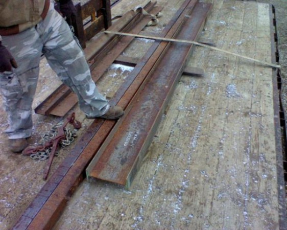

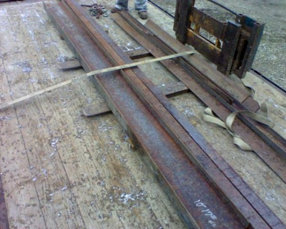

Picked up some steel from my uncle!! It's going to turn out pretty good, about 13ft I-beam. 40ft of 3 in square tubing, 12ft of 1/2 think angle iron, flat steel, 4ft 3/8 angle iron, and C channel for the skids. I'm going to incorporate a little of everyone's landplane including the frame of Jenkinsph, then the hitch is going to be like the leinback with angle iron, and the blades are going to be like Mtviewranches, unless I come up with a quick adjustable skid type. But here's some pictures of the steel!!!

My back hurts just looking at that. Unfortunately it reminds me of work that I need to get done. ;)
