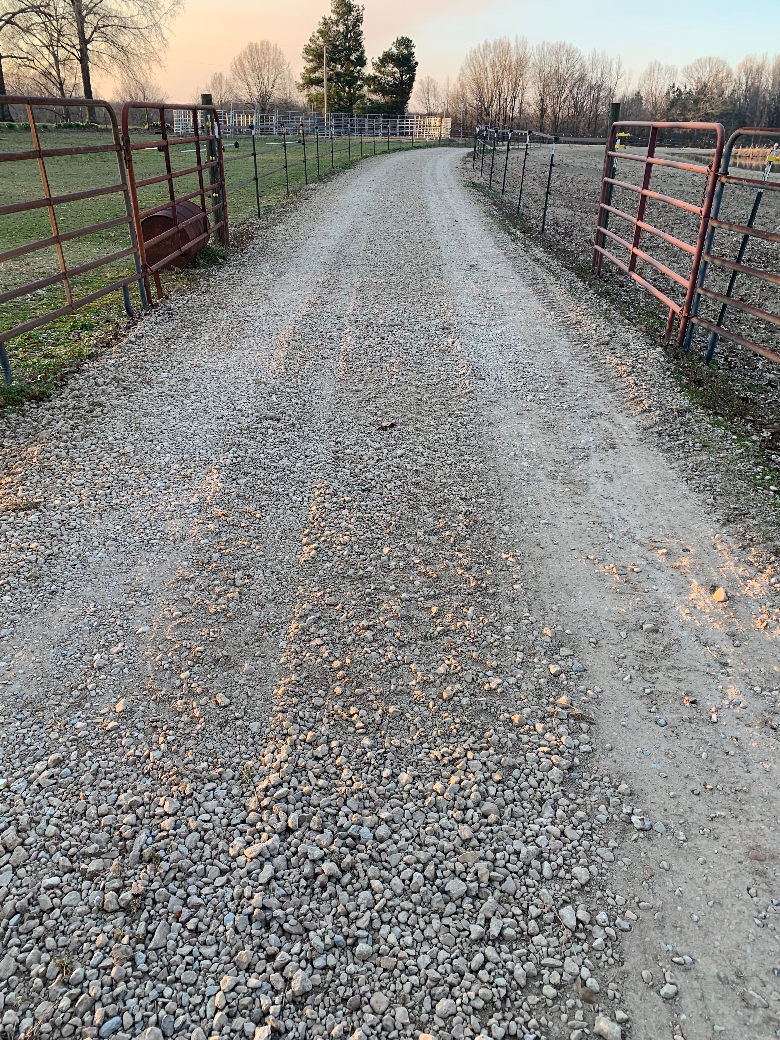

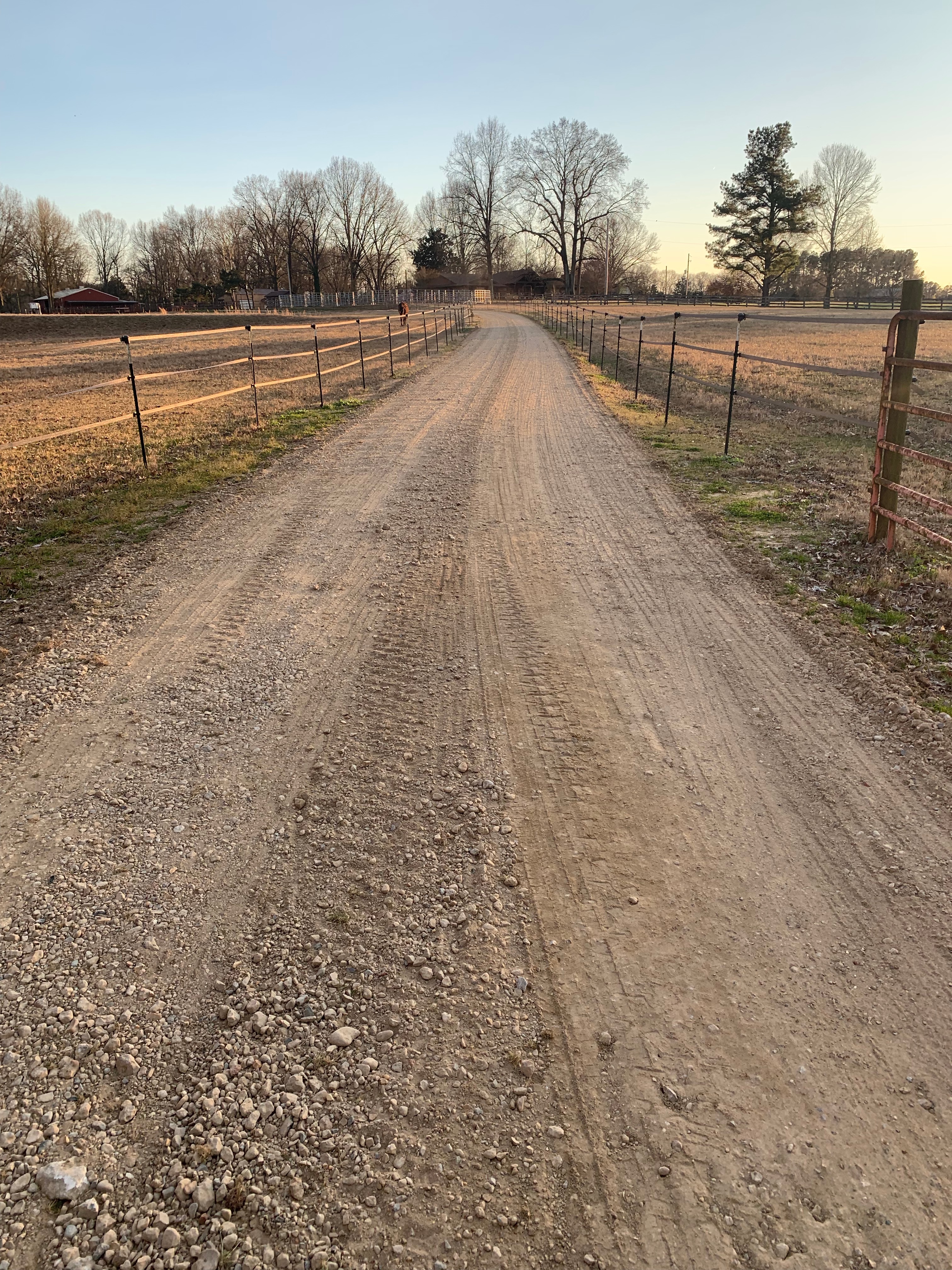

Here is my driveway after attacking it with my Woods GSM84P. I did not need to use the scarifiers at all. Also, I added NO new gravel...

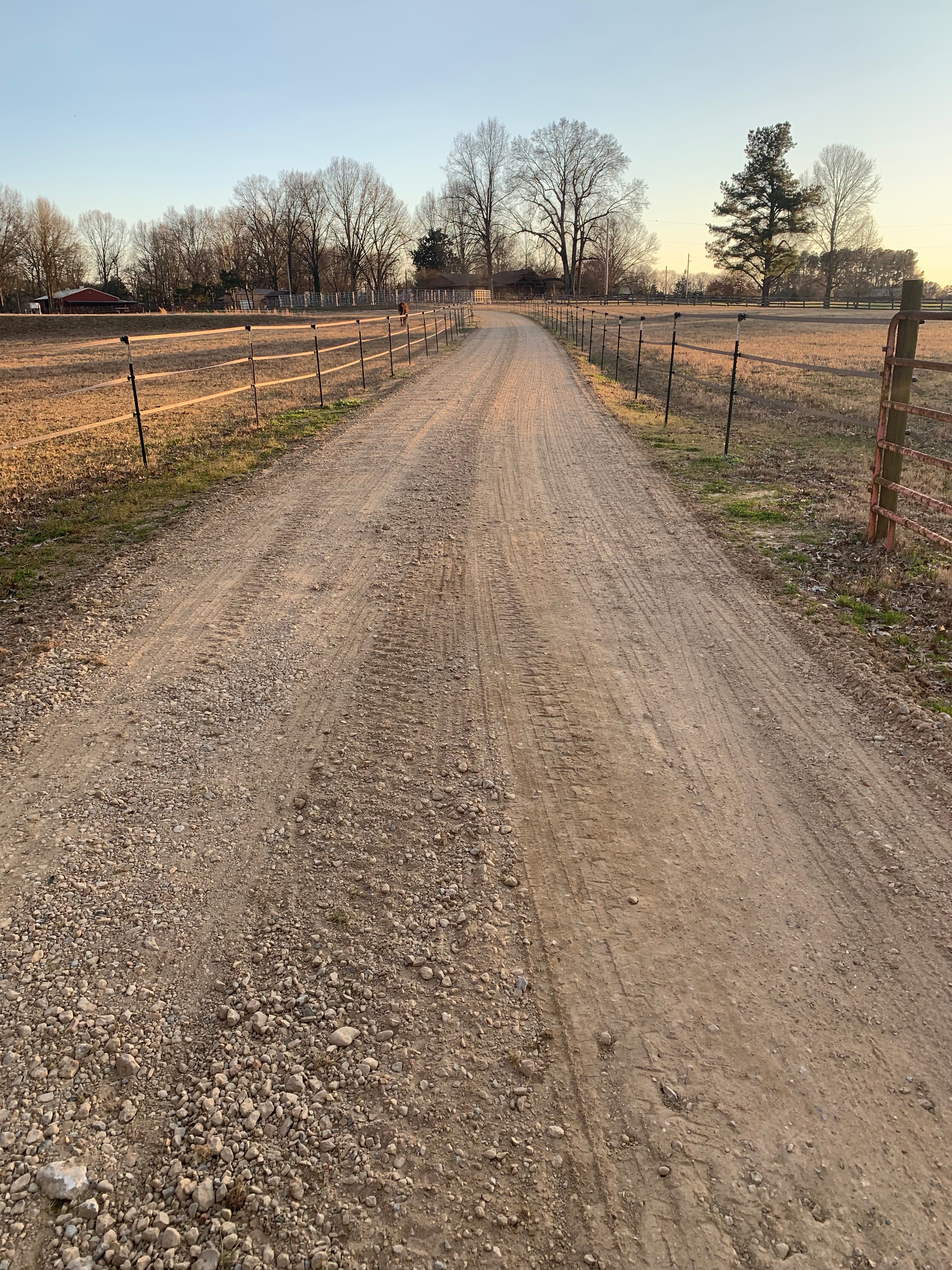

Looks to me like your gravel is migrating to the edges, against your fence.
A rear blade would pull that gravel back onto your roadway surface, and give you a crown.
Good point and a good reason to have a new toy...um TOOL ;-)
