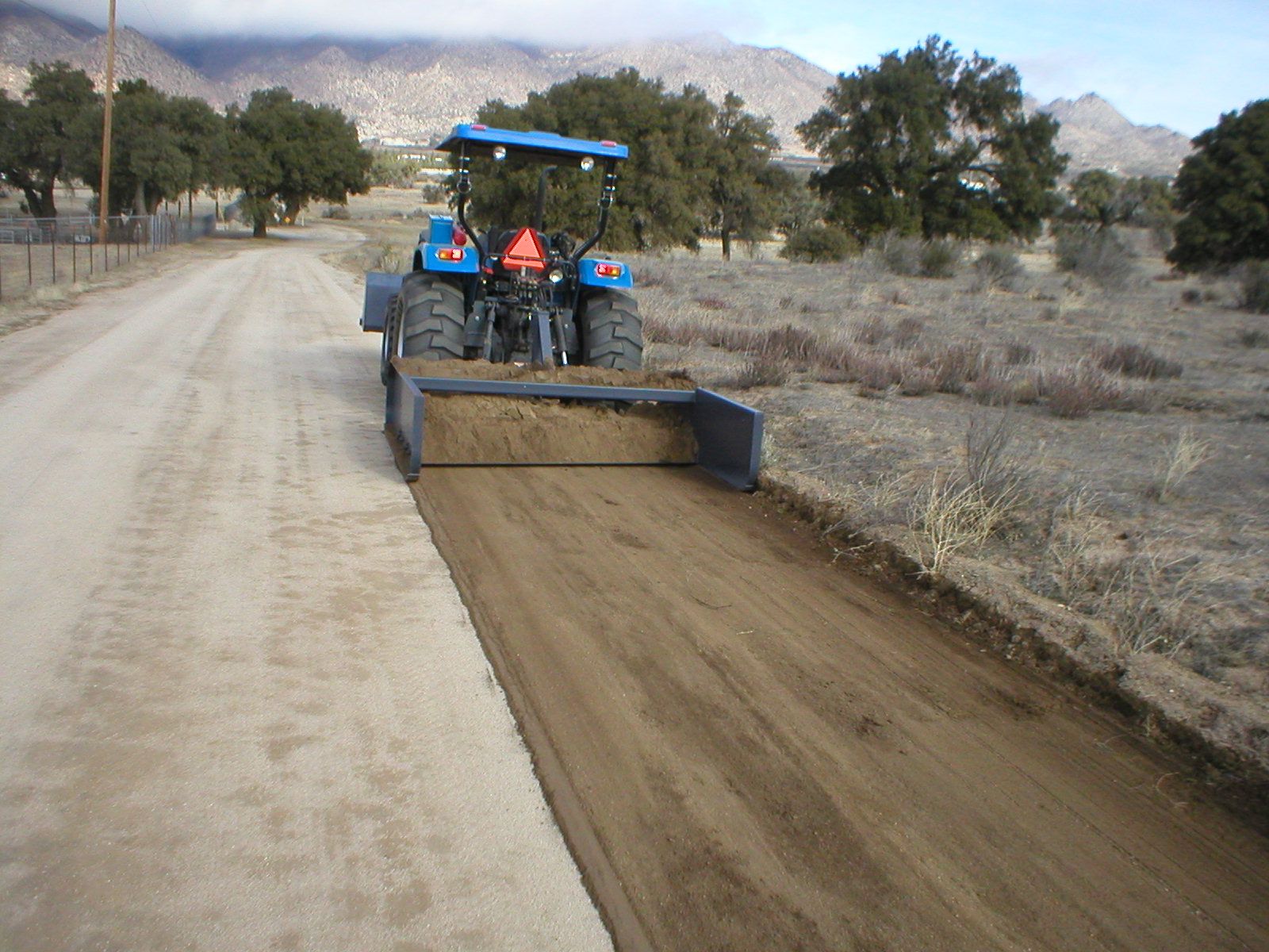

It seems like everyone has different conditions that they work with, so no correct answer for anyone without knowing ALL THE FACTS. Is your tractor ballasted, how much does it actually weigh? I have a 7 footer that weighs 1400lbs and at times it is all my 13,000lb tractor wants.
Now knowing that your tractor is over 6 foot wide (AG tires at full width?) I now recommend a 7 foot unit, but probably around 1000lbs. A heaver unit would work for you, you may need to hold it up though vs just letting it ride on the ground.
It was mentioned earlier that these LPGS don't carry much material. If the moisture content is right, mine will easily carry 1 1/2 - 2 cubic yards of dirt.
While a rear blade is a great implement to have and the best implement to shape a road, I have found that for me anyway, my LPGS cuts my general road maintenance by more than half.
Just another :2cents: ;)
