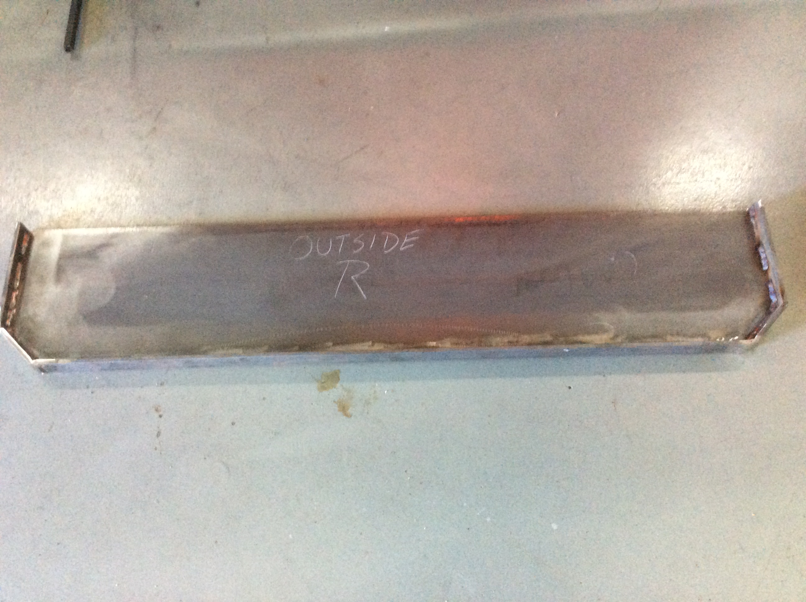

Afternoon #1 of grader project started with a visit to the steel yard where I picked up materials using Gordon's list. $460 which included probably $50 of extra materials for another project. Back to hangar to unload and begin. Pulled out the plasma cutter and first made the 3x3 triangle cuts on the side boards. Using a Hypertherm 1000 and a Miller 350P on pulsed spray for the welds (MIG), getting good results. Cutting and welding runners. This is going to be so useful. Mine will be 6' wide x 5' long, using used motorgrader blades. The upper structure I did not have to buy as I had scrap tubes for that. Although I was once told there is no such thing a scrap metal!! LOL

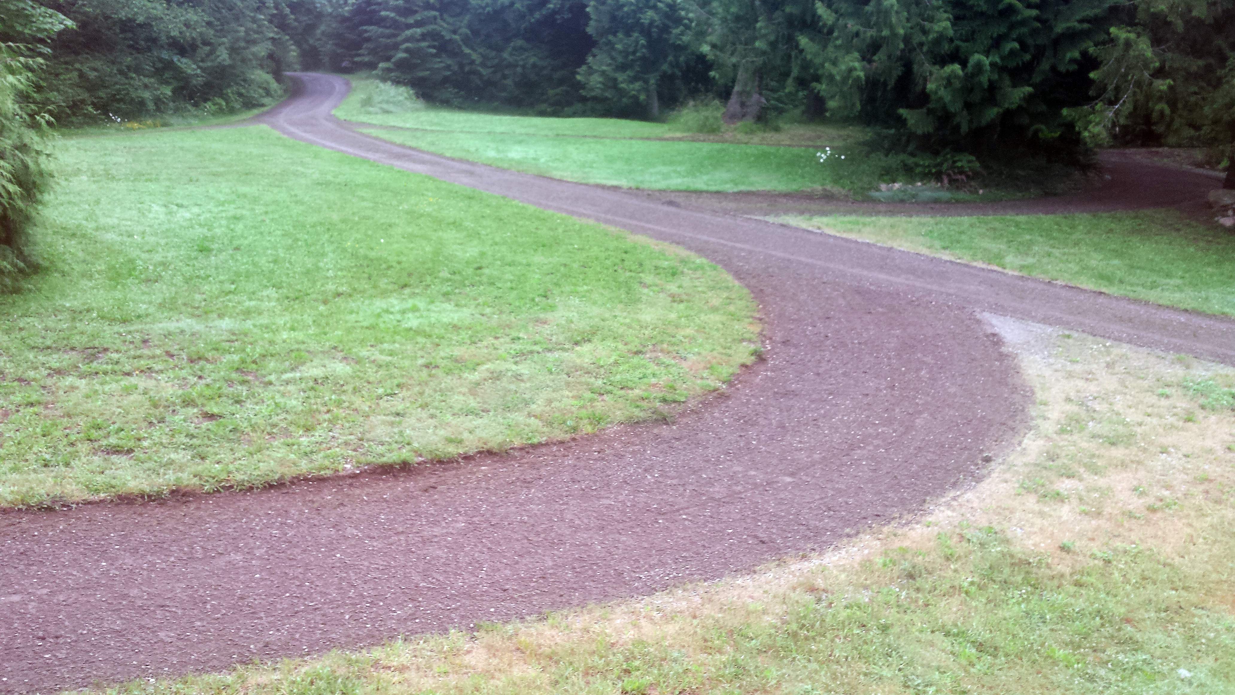

I am surprised that no one else has tried the ridiculously simple train rail solution to grading (see post #63).
Here is a picture of my driveways after yesterday's 'tune-up' of my hard packed gravel during some damp weather ...
The dark fines will be washed down during the next rainfall so the gravel will look like gravel ;)
