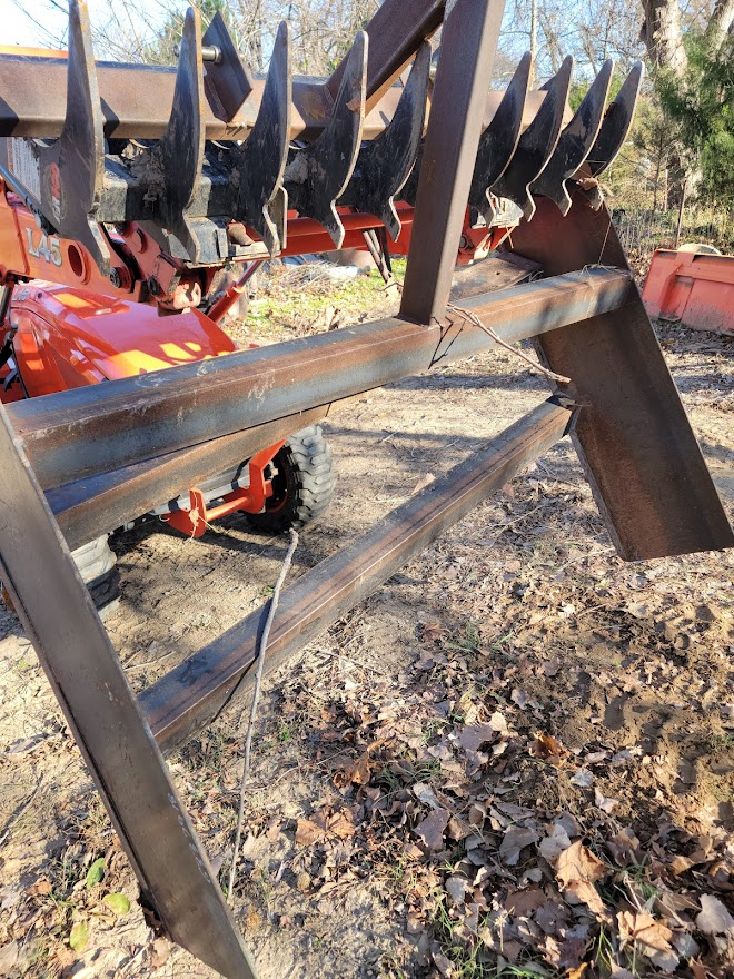

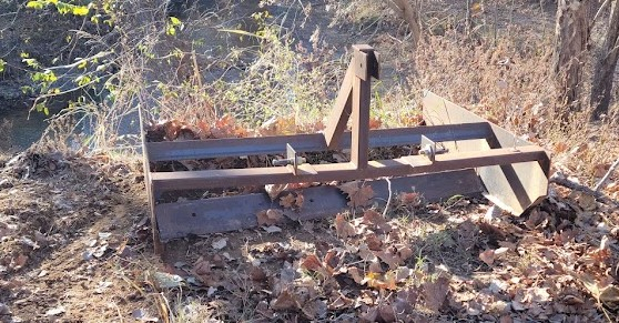

here is how it turned out, noticed today while taking the picture the welds on the cutting edge have broken loose in all but 2 spots. penetration was good but, you can see the holes where the weld penetrated the edge but they have still broken loose.
I am not sure if heating the edge with the torch first will help or not, maybe just bolt it onto the angle iron. I was also thinking of making a serrated edge to go in its place hmmmm.
