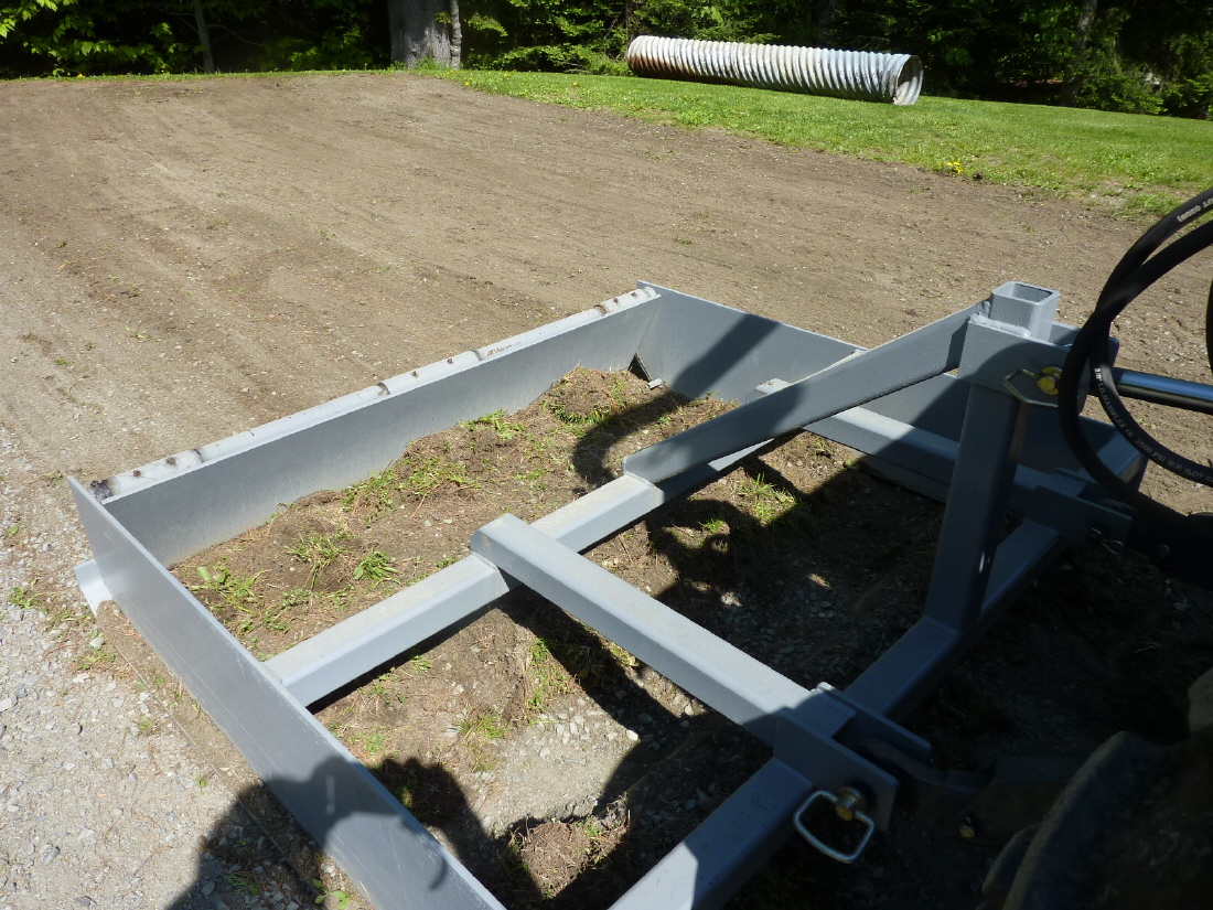

My blades are straight. I do crown and contour work with a rear blade and maintain the contour with my land plane.

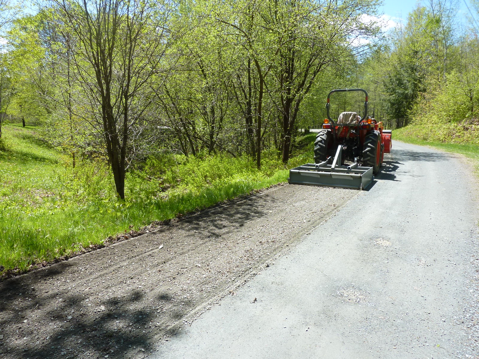

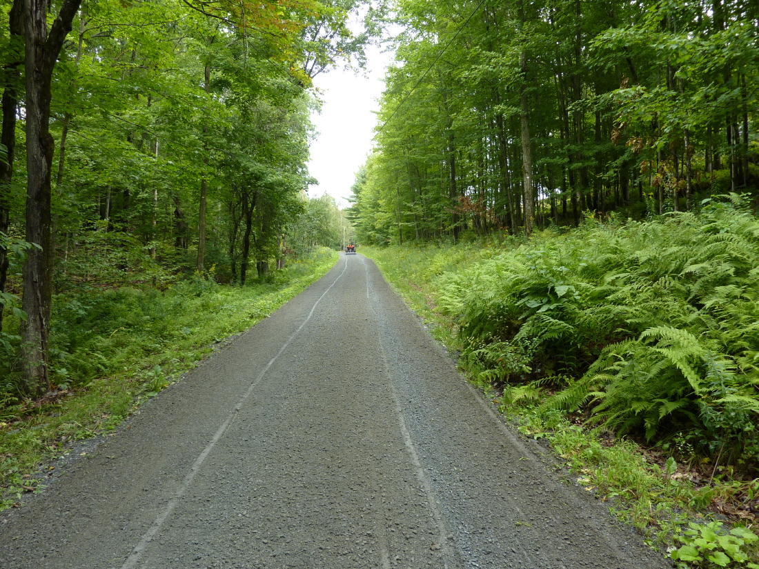

Start on hard packed gravel road
Finished
gg
/ Land plane blades straight or angled ?
Looks like yours is doing a real nice job! Does the hinged back flap fluff it out?
Just finished one side of mine today and it will look like a Land Pride and I
may steal some of your design also.

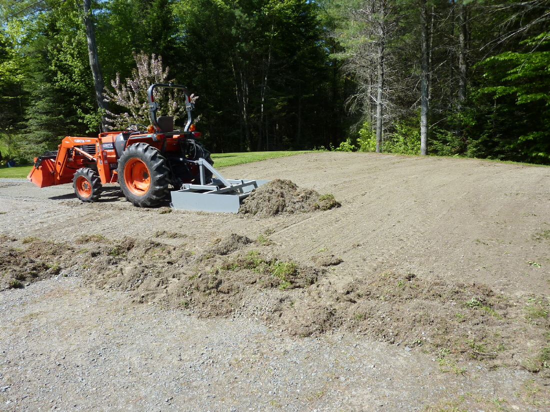

/ Land plane blades straight or angled ? #8
It doesn't do much in straight gravel. But it traps sod and other light debris if you have that in the road.
There is a stop pin at the bottom so I can use the tailgate as a blade to push sod piles off the road. If I hang the tailgate inside the pin by flipping it up and over it will hold gravel in the box like a box bade.
gg
