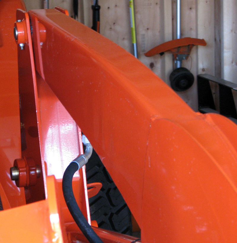

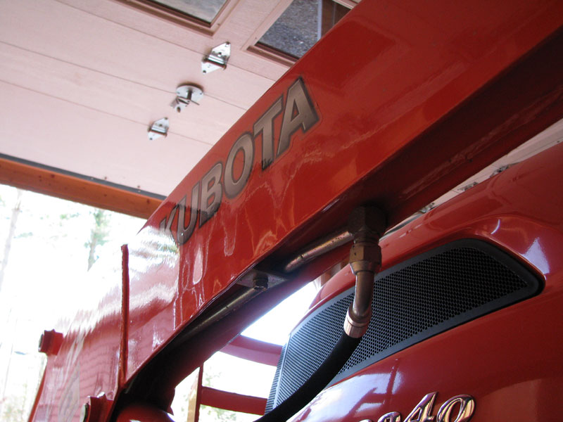

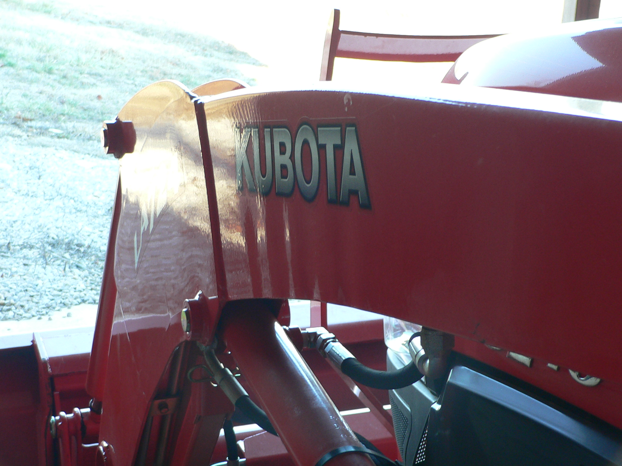

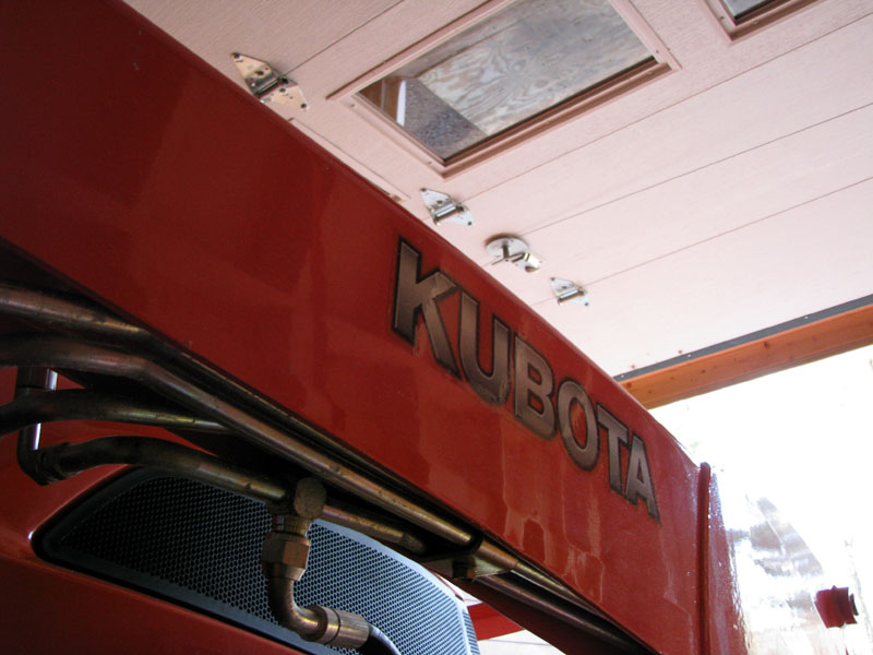

I just purchased my Grand L 3240 less than three weeks ago. When I first took delivery it was covered pretty well with ice/snow so I could not give it any type of real inspection. I gave it a once over today and I noticed that there are some waves in the metal of the FEL arms. I don't recall seeing anything like that on my LA403 loader that I had on my old B3030. Is this normal?
I only have about 5 hours on it. The only loader work I have done is floating the bucket on my tar driveway to remove snow. I have never hit anything with it.
Please see attached pictures.

Wow! It is looking like someone in quality control at Kubota is not doing their job. (Sloppy welds, wavy metal) IMHO, that loader should have never been painted much less shipped to the dealer. The dealer should not have installed it on your tractor. I don't know about you, but my tractor was a significant expence and it should be perfect when new.
/ LA724 loader concern #3
What's up with Kubota and shipping these things out. The middle picture really shows it well, the picture shows that the metal is warped, it's not just a surface defect. I would want another loader.

I don't think this is a production defect - I think it's damage. It's hard to be sure without seeing it in person, but it looks like the tractor ran into something, buckling the loader arms. My bet is it was a hard hit - not the kind of thing a new owner would do, but easier to imagine at the dealer's yard.
The loader arms are the curved design with formed outer channels straddling a reinforcement inside. Instead of a box cross-section, the legs of the outer channel extend down making a space at the bottom for the hydraulic tubing. The fact the free edges of the outer channel are buckled differently below the inside reinforcement indicates the shape change occurred after the arm was welded together. It's hard to imagine it could be buckled this way before being installed on the tractor. And being the "new curved look" I can't imagine Kubota would allow it to pass production inspection. The bad part is they are now yielded and permanently weaker for pushing - you'll always worry about them. Sorry to see this - I hope there's a good solution.

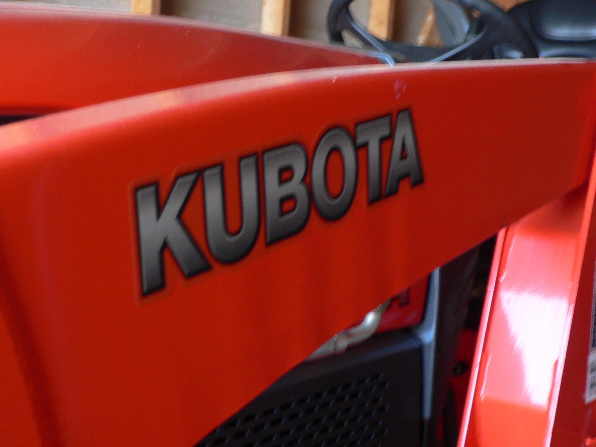

Don't know if it makes you feel any better but my L3240HST bought this summer also has the waves on the arms. Can only see them at an exact angle and they disappear from view when you move the least amount of angle. I'm not the least worried about mine. Couldn't see them when I pulled the tractor out of the building.

That basically confirms what the dealer said. All the units on his lot with tha LA724 had similar waves to mine and yours. I guess there is no problem then. The dealer said he will stand behind me. My tractor was also built/delivered to the dealer late in the summer.
I also did not notice them at first. I only picked up on the issue today because of the angle of the sun on the machine.

......being the "new curved look" I can't imagine Kubota would allow it to pass production inspection........
It's hard to imagine Kubota is ok with these looking like this - but if they are using lowest-bidder fabrication techniques the design invites trouble........ It is tricky to control cool-down shrinkage when applying a weld an inch or two back from the free edge, but it can be done, and should have been. In JOHNTHOMAS's pics the compression edge of the channel is all wavy - not just near the weld. The forming dies weren't set up to restrain the material - or the material was wrong for the process. The fabrication is so lame, I was sure it had to be damaged. Live and learn.......

doesnt look like a big deal to me, I've seen these waves before on brand new straight steel. I think it's from the heating and cooling process when the steel itself was made at the mill.

I just looked at my loader. It has the same waves. (had it 2 years and never noticed till this thread) They seem to be warped a bit at the weld line for inner box plate inside the curves. If you put a straight edge on it, it is only a few thousands of wave. I do not see it as a weak area, has a lot of steel and it looks like the strengh is from the weld up. The wavy flap below the weld is just to hide the tubing. I have done a lot of hard digging and tree moving in the Michigan red clay without any sign of damage.
