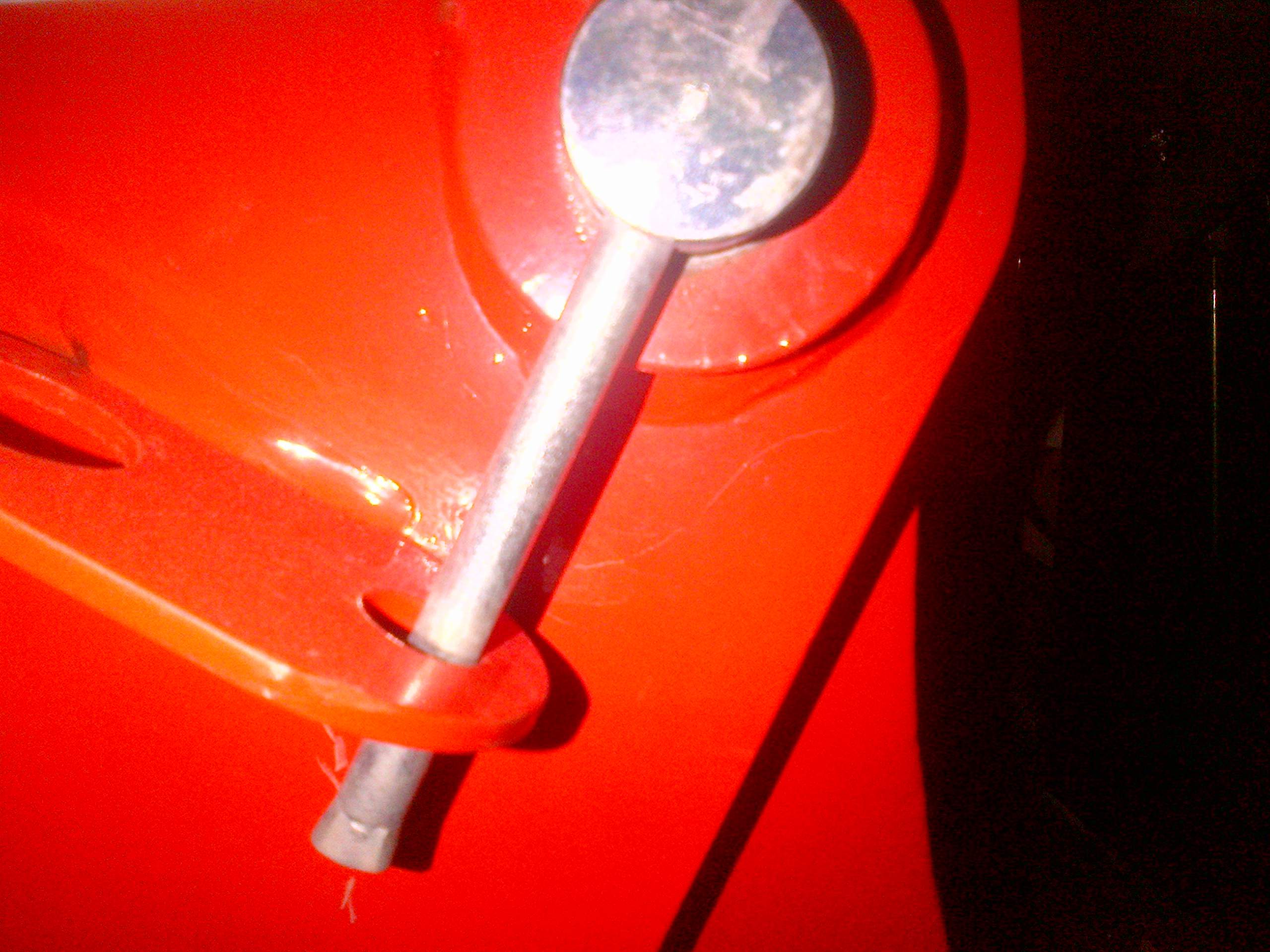

I have a fairly new (65 hours) Kubota M6040 with a LA1153 loader that I bought new. While moving some snow yesterday, one of the 2 main pins that holds the loader assembly in place, fell out. I was pushing snow into a bank and the failure caused the loader to swing to the left thereby bending the main frame on the left side. My dealer, Chappell tractor of Milford, NH said it will not be covered on warranty because there is no broken part that caused the problem. The poor design of the pin that does not keep the pin from falling out is not a "broken part" so tough luck for me. The service manager said that both Kubota and New Holland have the same pin design with a sliding pin the goes through a hole on the frame. It seems to me that a jarring of the tractor during normal plowing operation could allow the pin to dislodge and fall out. He said it has never happened before. Personally, I think the sliding pin should have a hole drilled in it and a spring pin through the hole to prevent the sliding pin from disengaging. I plan to do that fail safe myself once the tractor is repaired. In fact, the LA1153 owners manual states under "Reinstalling the Loader Important: 6. Stop the engine. Reinstall the mounting pins and secure them with the spring pins." So someone thinks there were or should be spring pins on the assembly like I do. Anyone else have a similar problem? Thank you, Jack

IMG-20140103-00927.jpgThe pins have a small pin that goes threw it and into a slotted hole right? I have done a lot of pushing dirt,brush,hay bales and never had a pin come out several hundred hours of rough work,hate to hear that you have messed up your frame and only had it a short time... Insurance will cover it...

gullagej,
Are you saying that this lock pin
(the one going up and down, and into the detent hole) is the one that jarred loose, thereby allowing the larger pin to self-extract?

When getting it fixed, have the holder raised up so that the pin is going thru more. I had one that I thought I hit the hole with the pin but didn't, caught it when the big pin was about half way out.

Yeah that's right

Yes, that's what happened. My pins slide up and down freely and that's the only way the big pin could have come out.

While I am waiting for mine to warm up I just thought of this. Not 100% fail proof but it was fast and easy. Maybe some of you guys can try this until you implement a more permanent solution.

For that small pin to move up far enough and the big pin to have the weight off it and rotate,so small pin doesn't go back in slot and then have the big pin work it way out that's a lot. Freak deal. My brother put mine in and didn't drop the small ones in there hole,helping me but I noticed it when he done it and corrected it,first time he been around taking the loader off,he just leaves his on his mahindra. Its so easy I take mine off unless just really need it.
