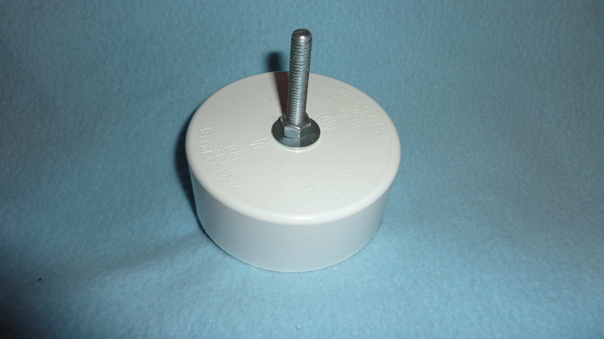

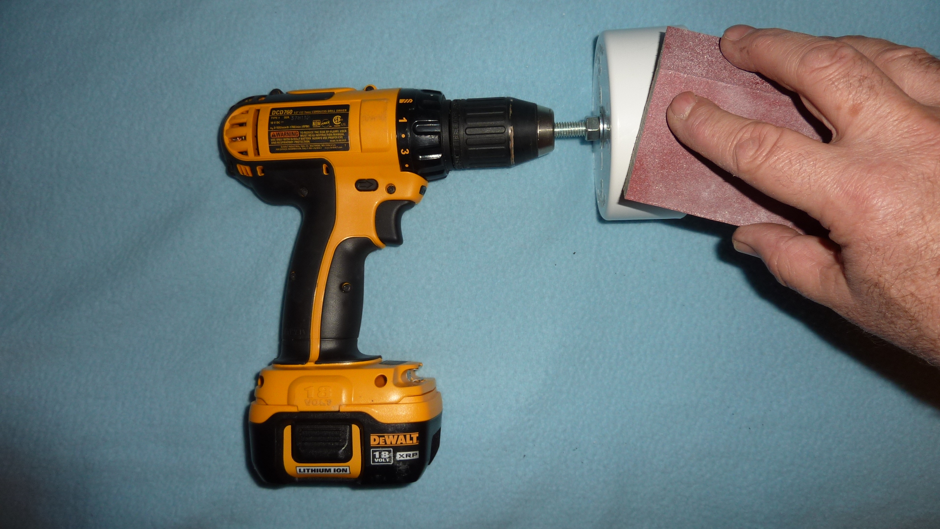

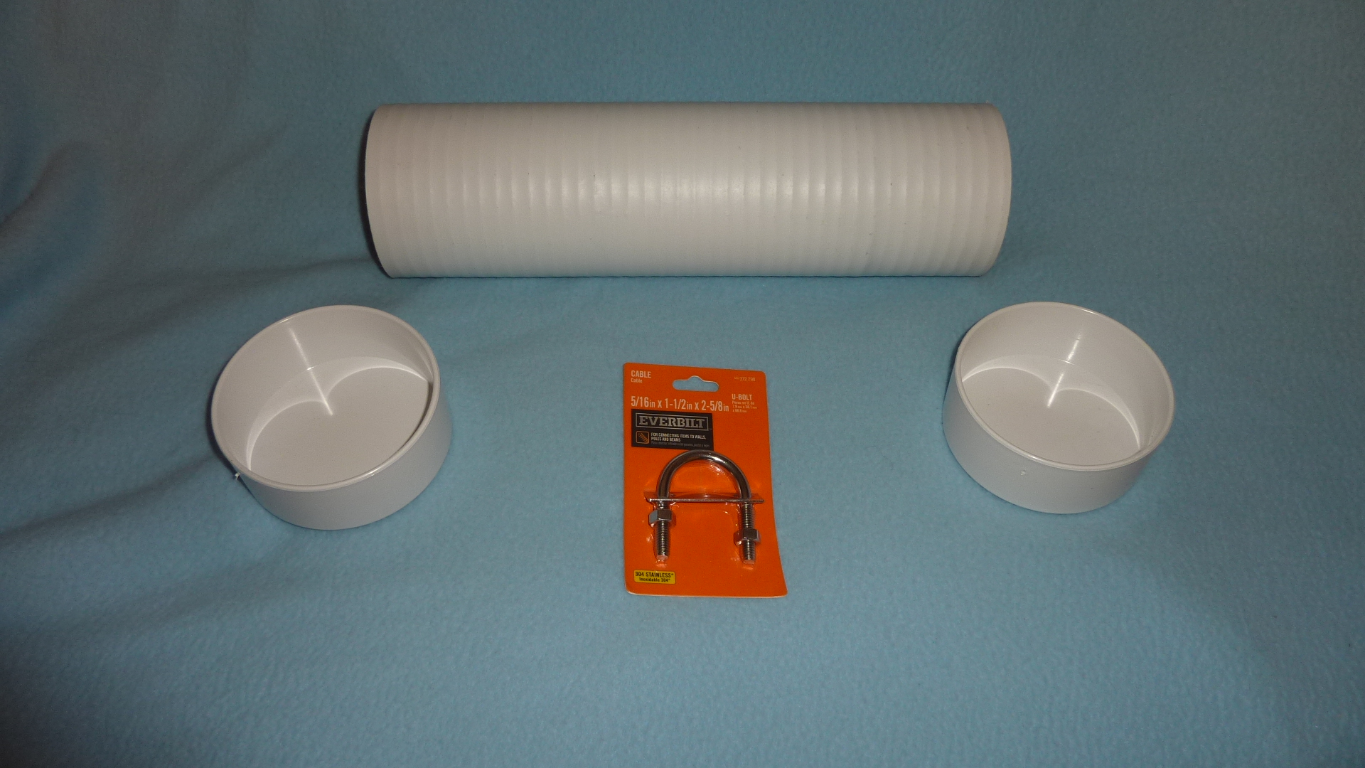

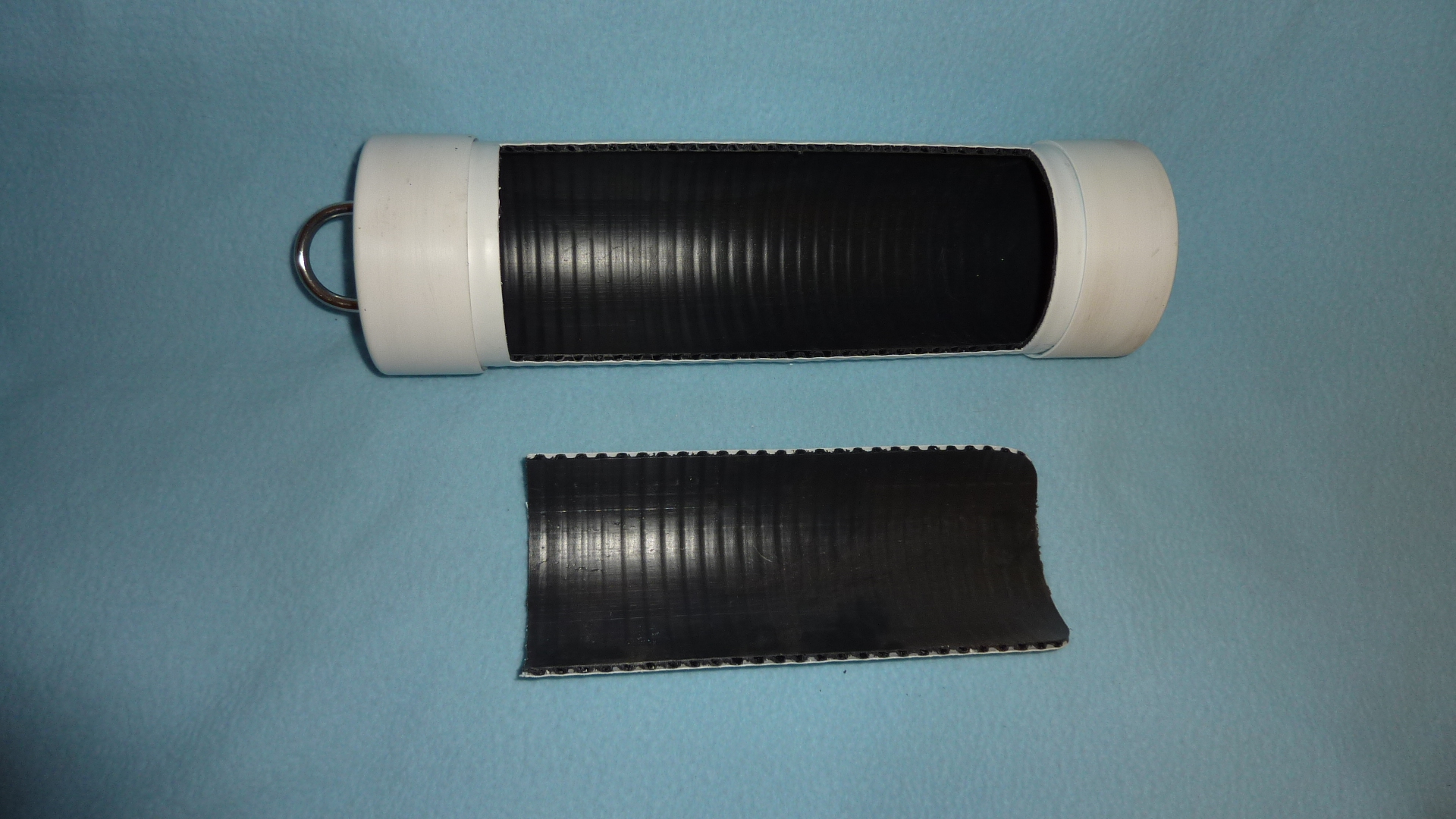

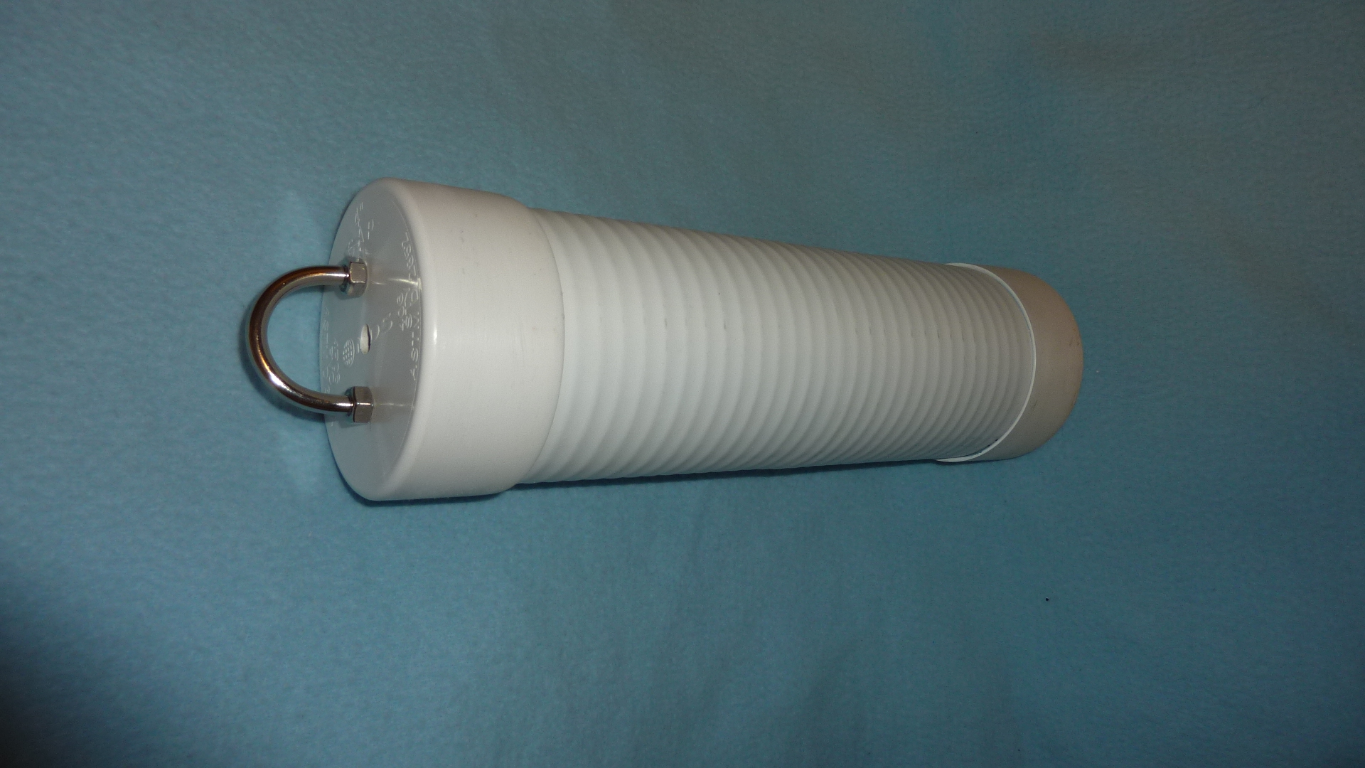

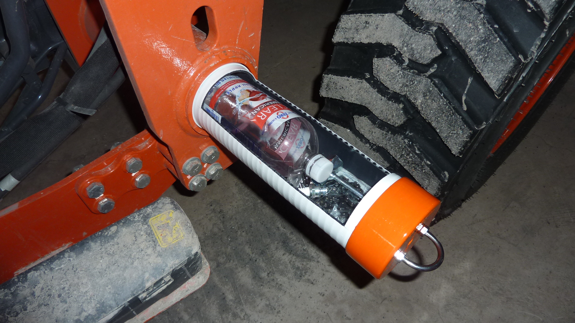

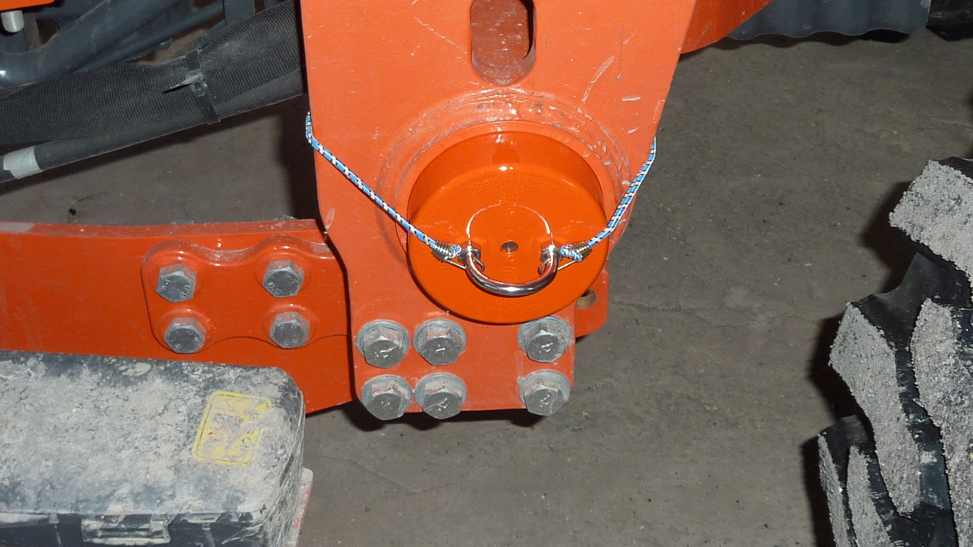

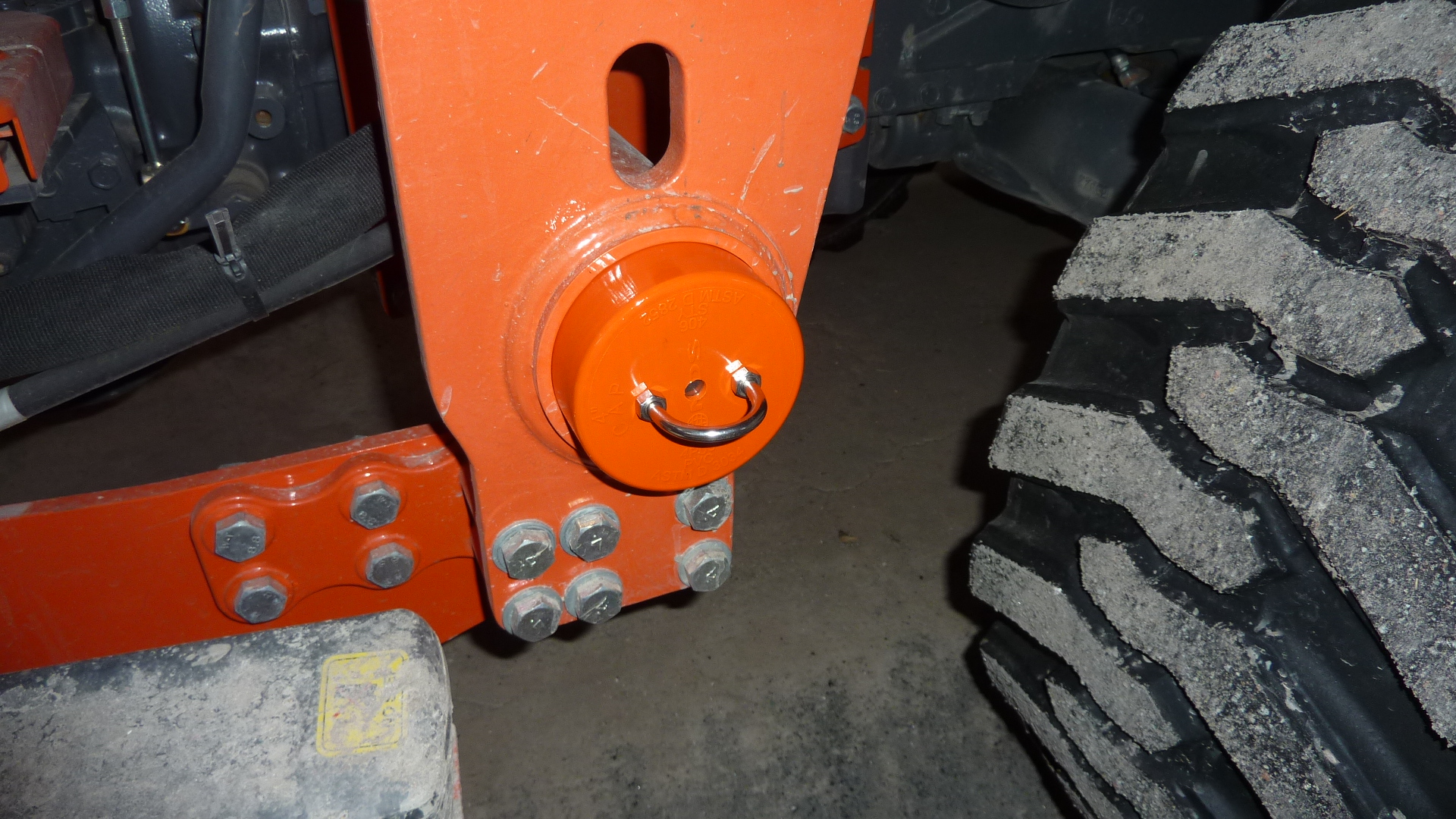

I made a pair of these for my MX5800 and found they fit the L6060 as well. In my case, the FEL hyd. lines run through the right side tube so I can only use one on the left. The trays also fit the cross tubes of many FEL's but the contents move around as the FEL is raised and lowered. Ok for water bottles, cans of chain saw fuel, etc. but not good for fragile items.
They are fairly easy to make from some sch 80 PVC pipe and fittings available at Home Depot. Some sanding is necessary for a good fit:
The trays are a press in fit and I've never had one come loose but if you're worried about it, you can always do something like this:
I remember seeing this. In fact, I told the Kubota salesperson about these. I'm gonna try this too.
Thanks!
View attachment 524560 View attachment 524561
View attachment 524562 View attachment 524563 View attachment 524564 View attachment 524565 View attachment 524566
That if freaking beautiful!! Nice job!
