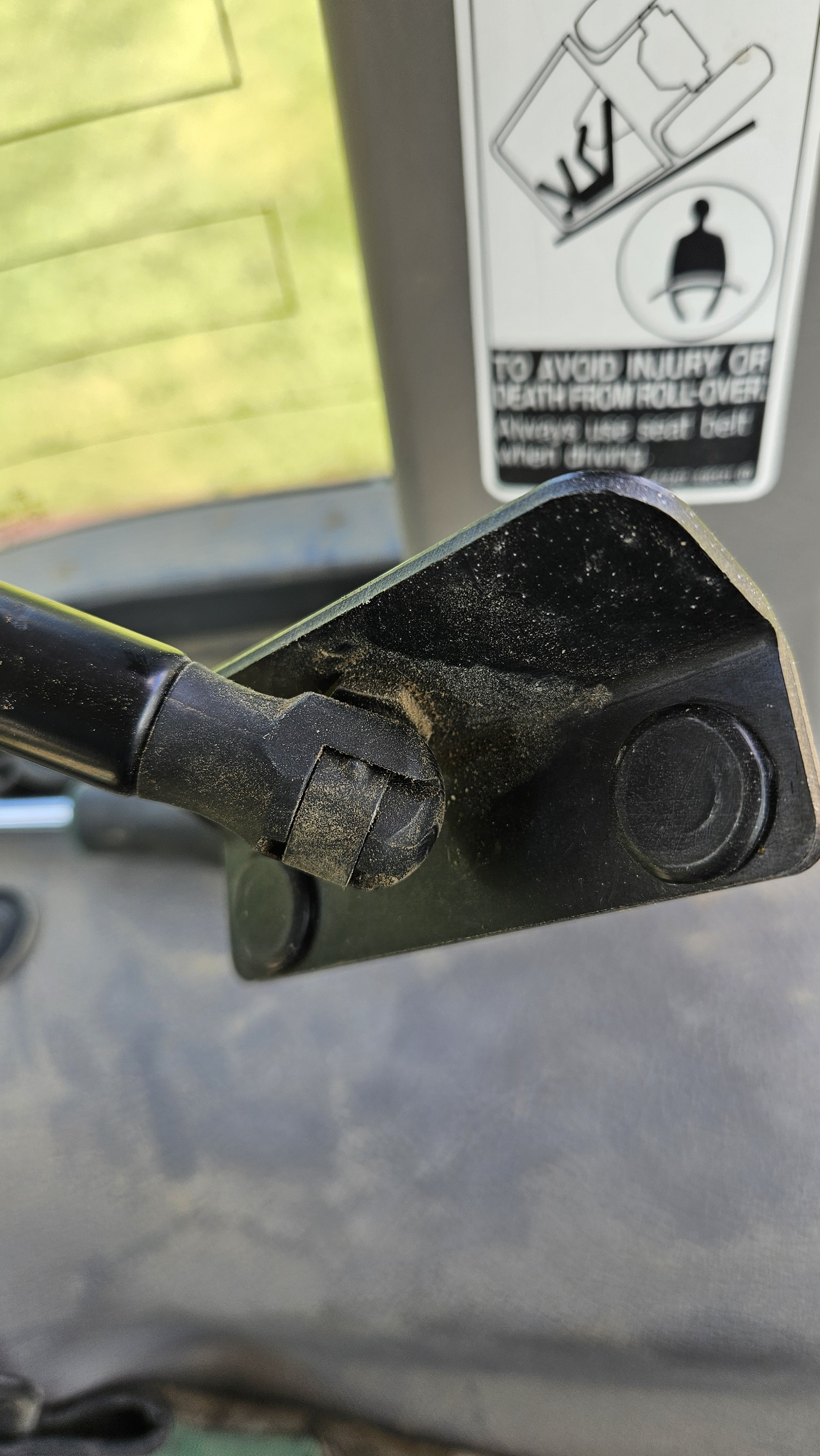

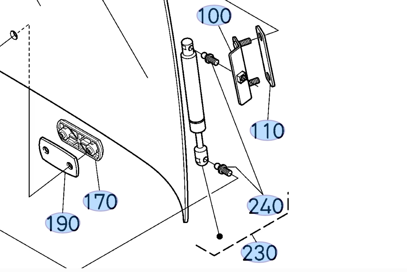

How do these come apart? Replacing the rear glass and need to disconnect the strurs feom the glass brackets so I can install them into the glass without having to try and keep the entire assembly compressed while doing so.
   / L6060 rear glass struts disassembly? #2
The ball joint (Item #240) threads out of the bracket.

Beat me to it. Follow the video.. They are all like this.
   / L6060 rear glass struts disassembly? #7
I should have put a little more thought into my response.
   / L6060 rear glass struts disassembly? #8
Hang on to the clip, they like to go flying if pried too far back.
   / L6060 rear glass struts disassembly? #9
Do NOT attempt to keep them Compressed. Open the glass Fully then disassemble per instructions below.
   / L6060 rear glass struts disassembly? #10
Those little spring clips slide off - then the cylinder pops off the ball stud(s). If you stop into an auto supply store (or similar) they may have a package you can open to read the R&R instructions. Also, look for a YouTube on Removing Gas Operated Struts
"To remove a gas-operated strut, you'll typically need to release the mounting clips or fasteners at both ends of the strut, then carefully detach it from the mounting points. This often involves using a flathead screwdriver or a tool to release the clip and then pulling the strut away from the ball joint or mounting bracket. "
