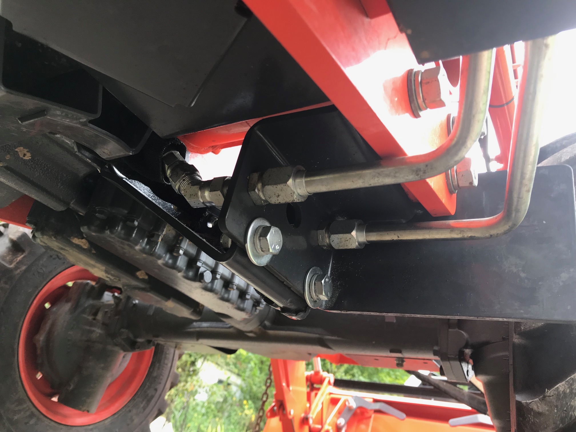

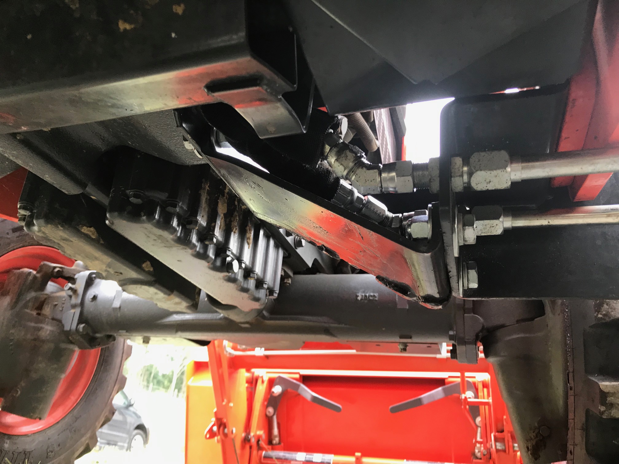

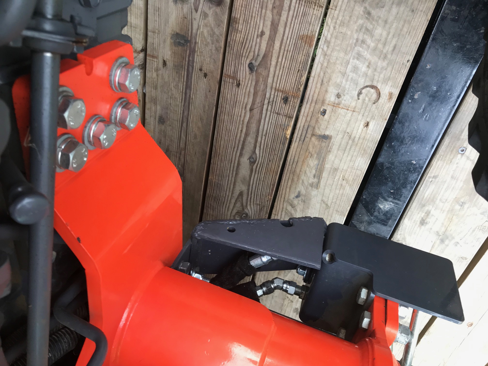

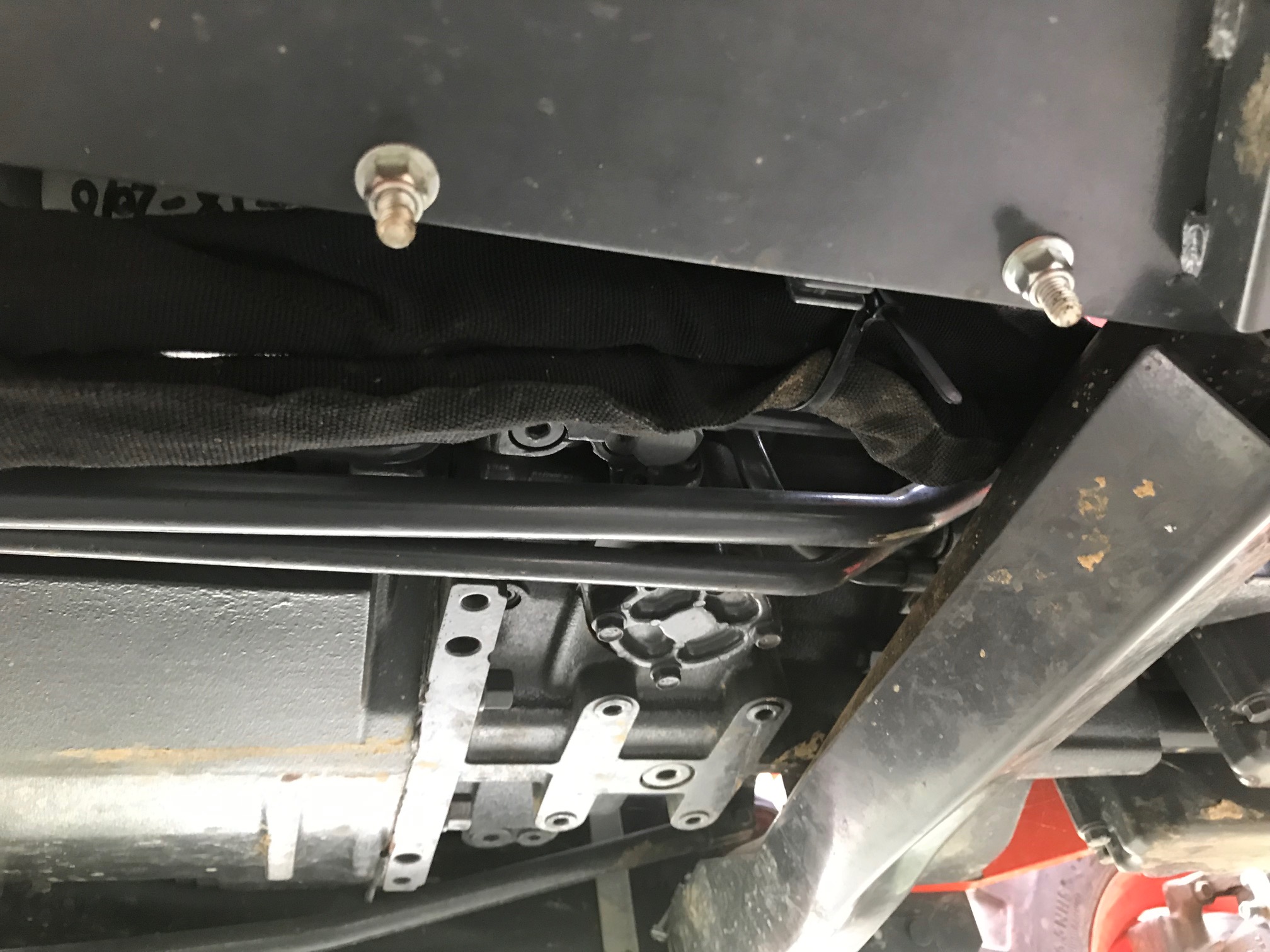

Hilbilly - there is a DEFINITE difference between the routing on my 2009 M6040 and your 2019 L6060. My hydraulic lines come out on the side of the transmission case - and are routed UP and on the inner side of the FEL rear post. There is still the shield - like you built. But nothing hangs down quite like the shield as shown in your one picture. Mine is a WR Long third function and was installed by my local Kubota dealer.
I'll get some pics and post here a bit later. This is not an easy place to get a GOOD photo.

That's definitely a better setup than what I have.

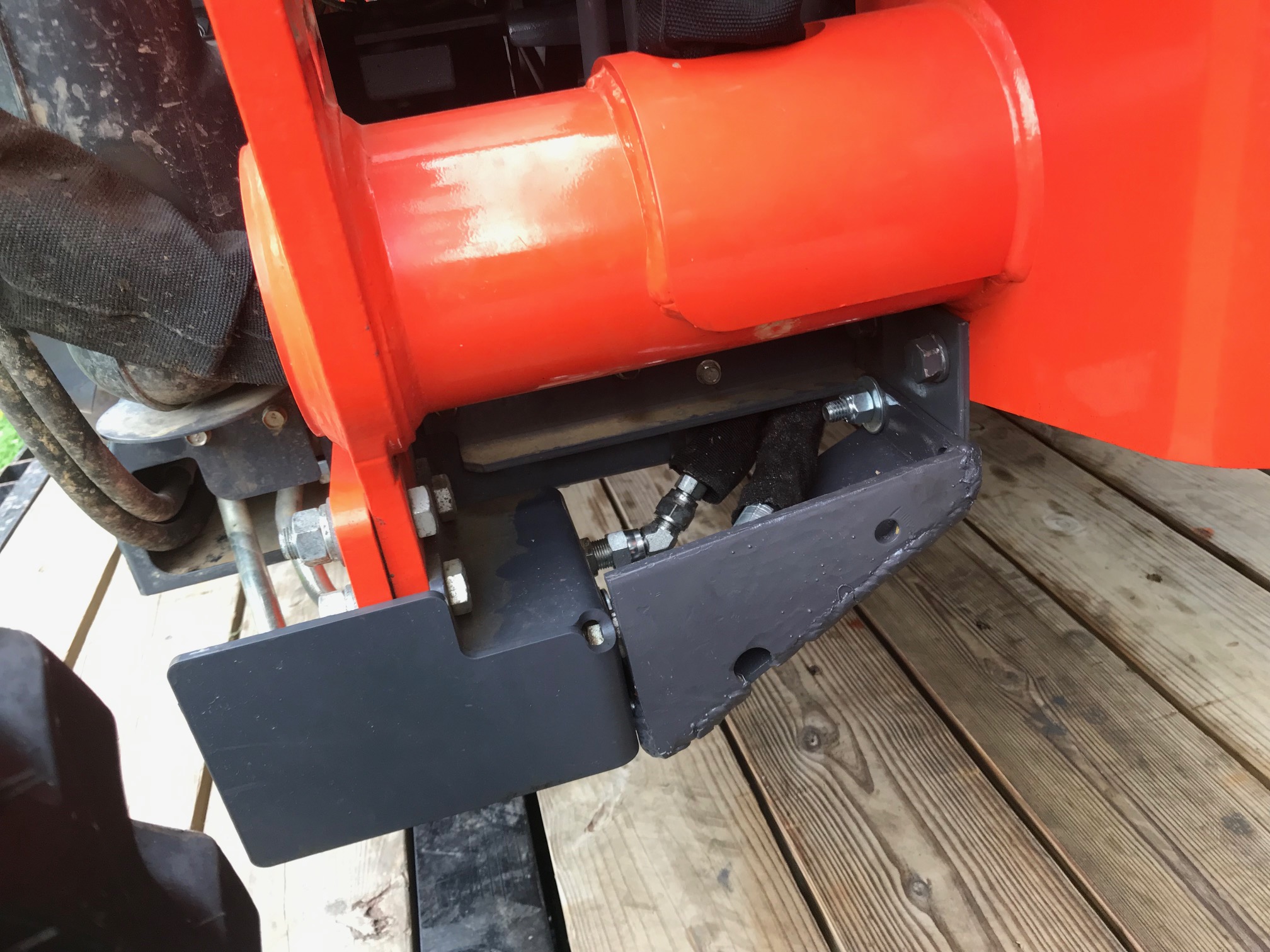

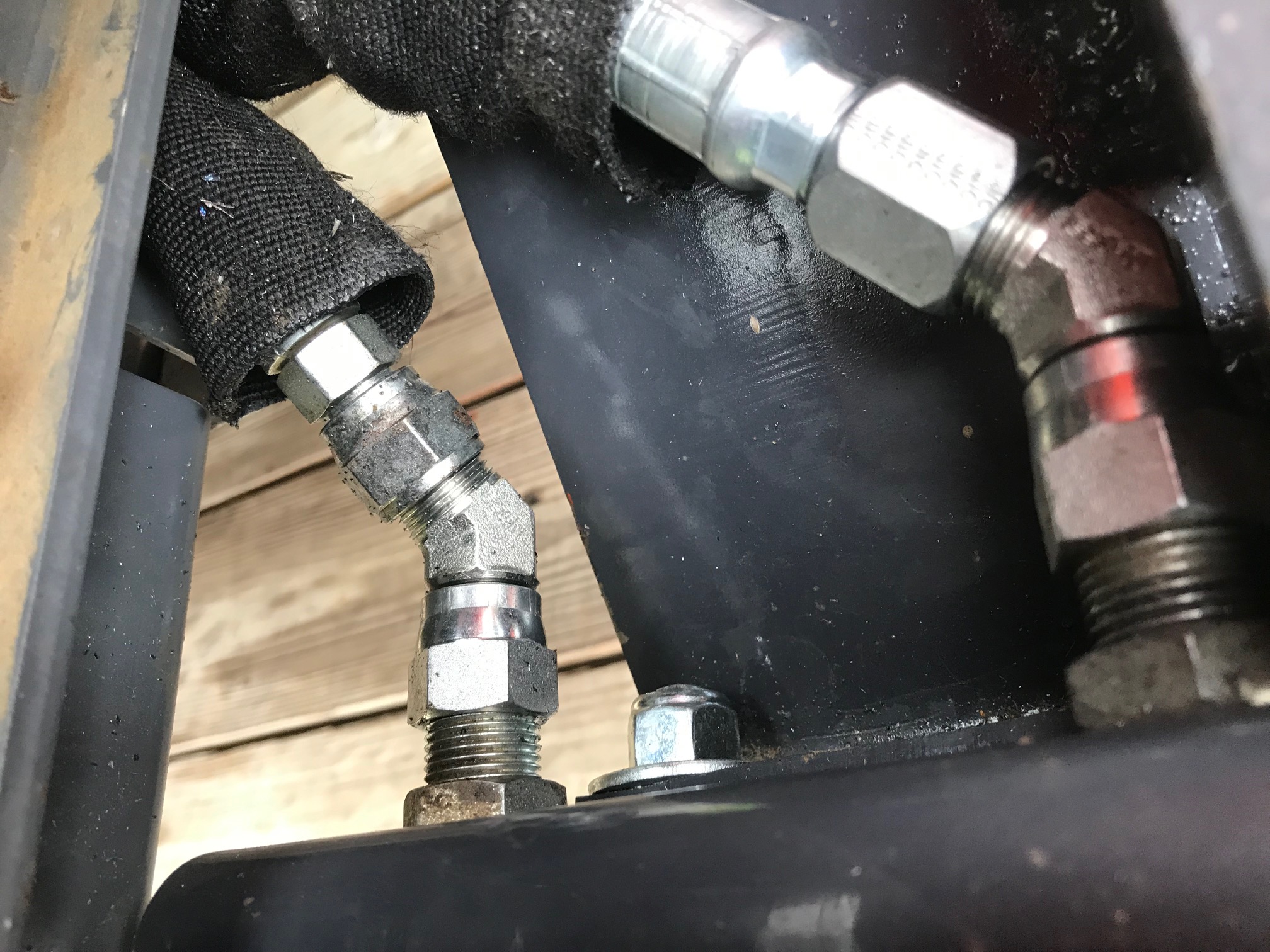

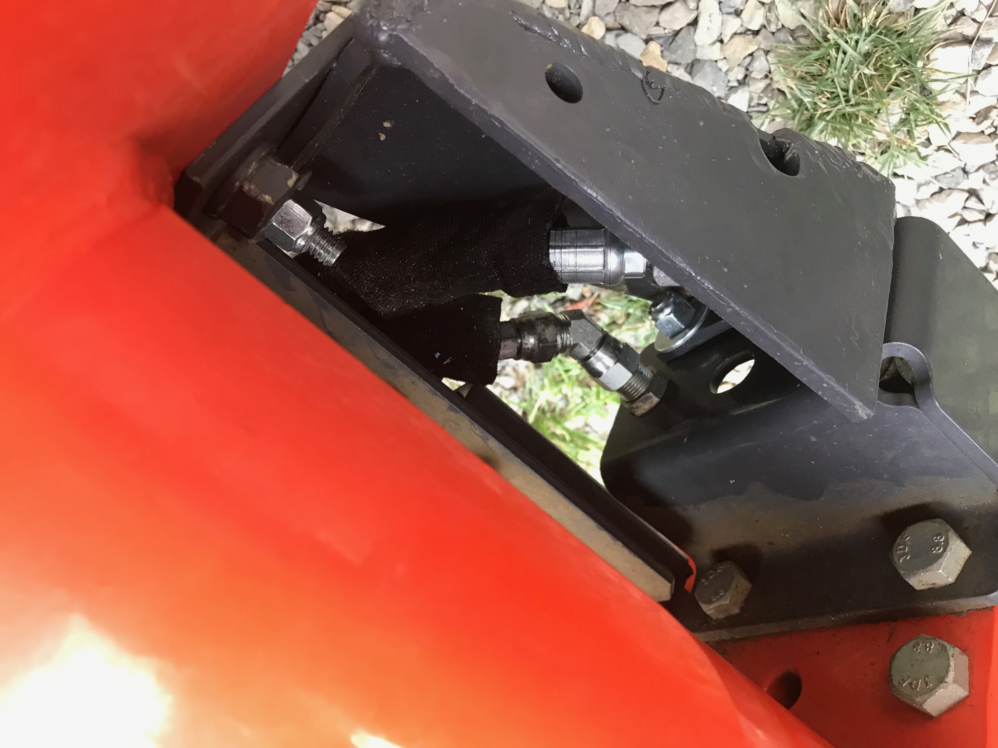

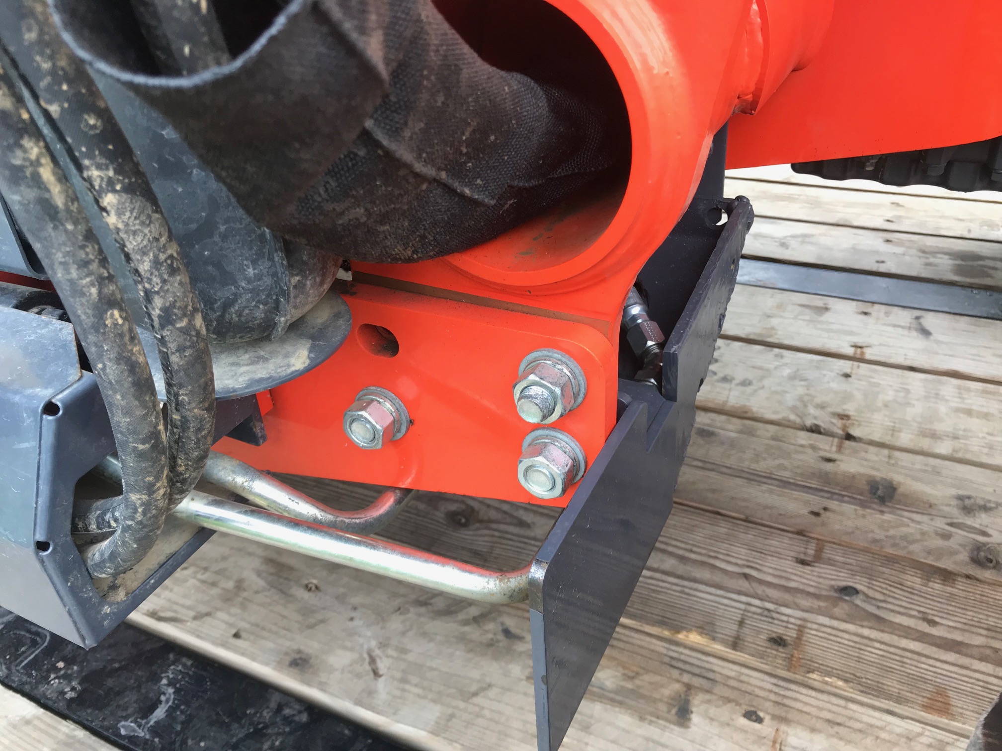

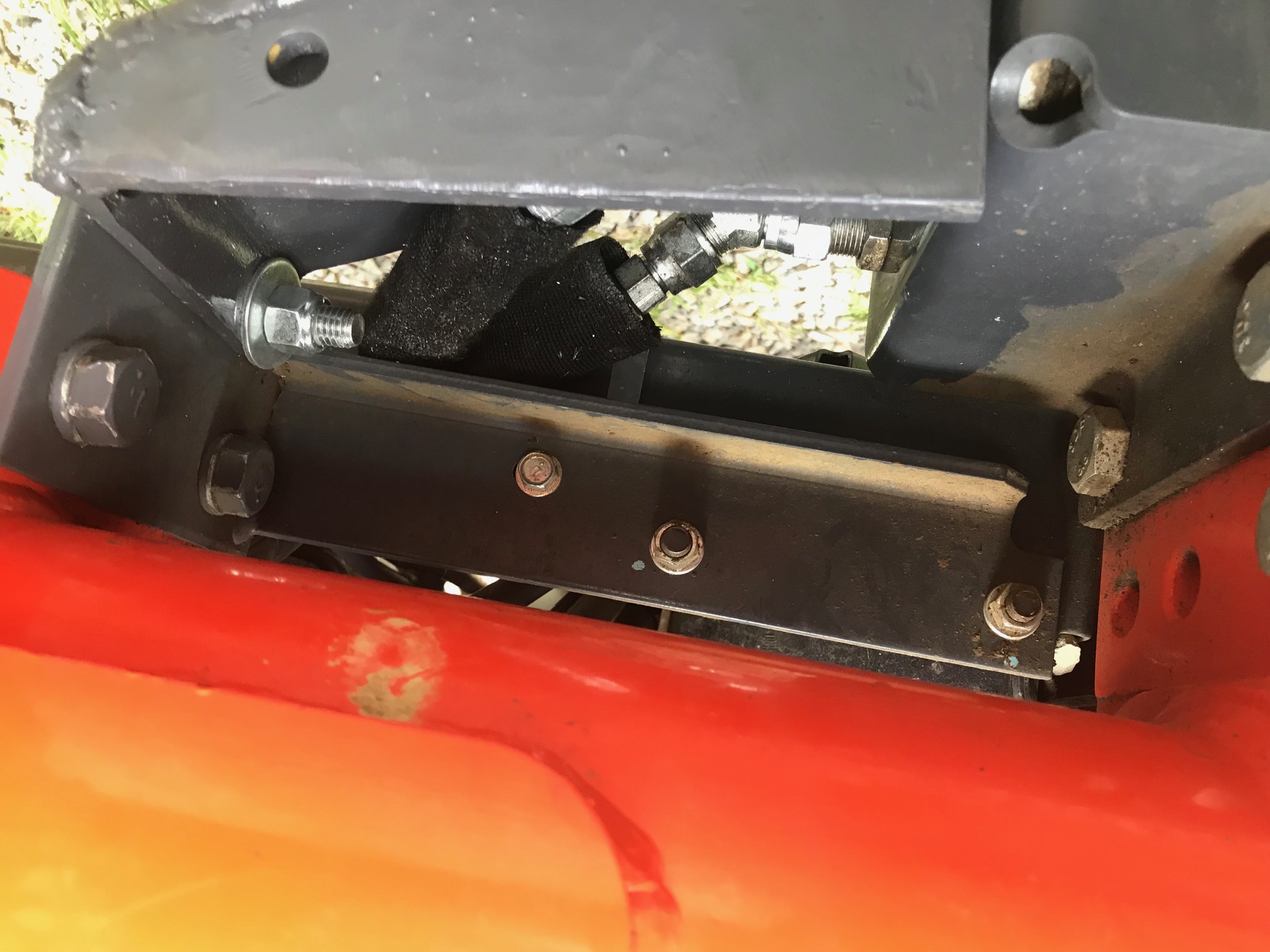

Ok, after my tractor being at the dealer for a little over a month, I finally got it back and mostly fixed. I can't say the same for the backhoe, but let's get back to the third function...
They put 45 ells on there and created a guard. It actually looks pretty good. So here are some pics.
Edit: If you see anything of concern here, please say something! It looks good to me, but they did other things I thought was a good idea and they were not.

I like it.

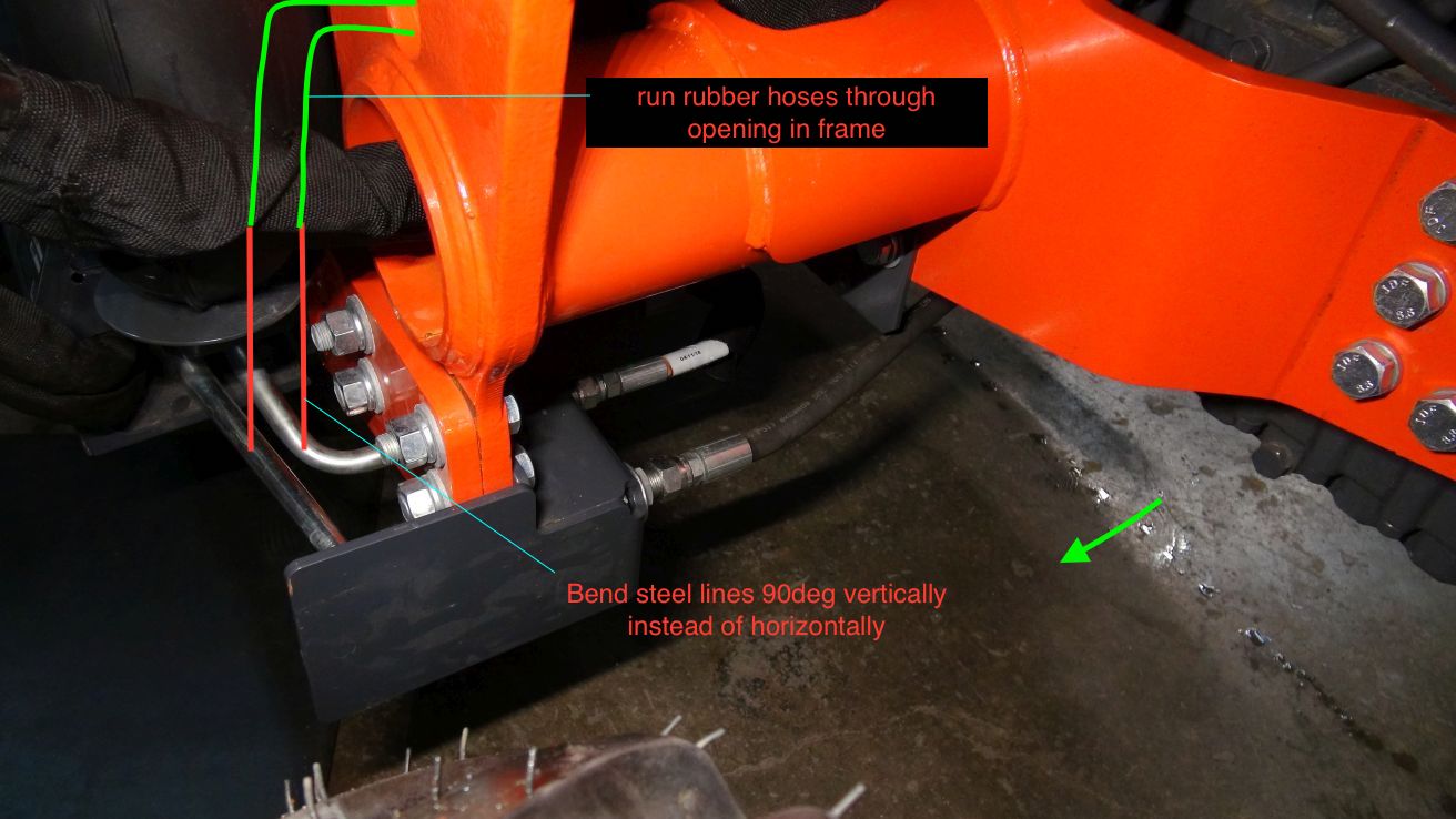

I also agree and don't understand why this simple fix has not been implemented. Kubota has spent the time and effort to make sure the whole undercarriage piping and plumbing is well protected. Everything is tucked up into the framework or has some sort of protective plate. I could understand if this 3rd function was an aftermarket kit but it is an OEM kit and not cheap at that.
Here is a copy of the pic I sent to my dealer about my suggested change to the plumbing.
This change wouldn't cost anything and produce a much better installation.
Besides this and the hokey 3PTH stop lever, everything else I've experienced, so far, with this tractor says "Premium Quality" to me.
