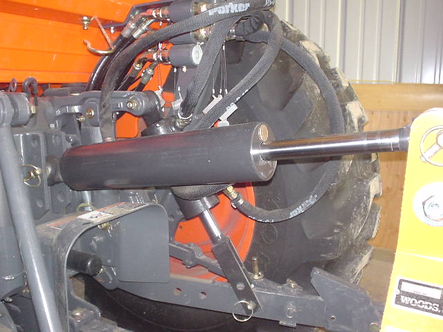

Jeff,
Attached is a Kubota top link photo on an L4330, a smaller version of the L5030. There is a quarter perched on the end of the body for scale. As I recall, the fully extended length of both this cylinder and the manual turnbuckle it replaced was 31 to 33 inches. That's the center to center distance between holes.
John
