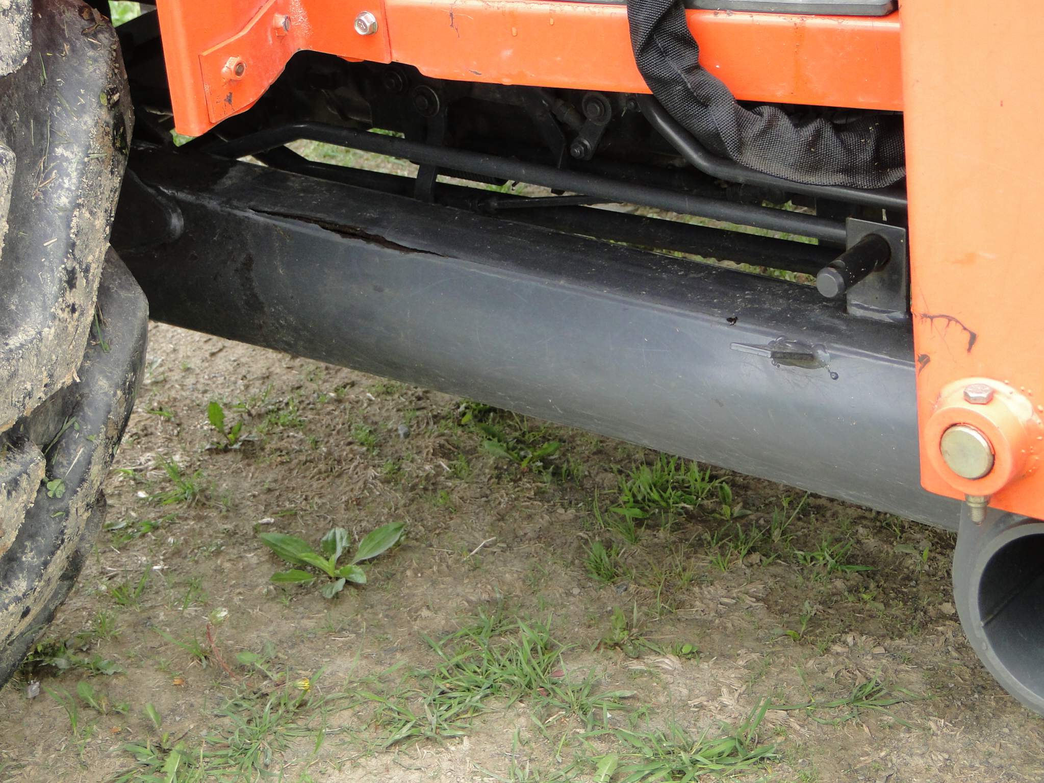

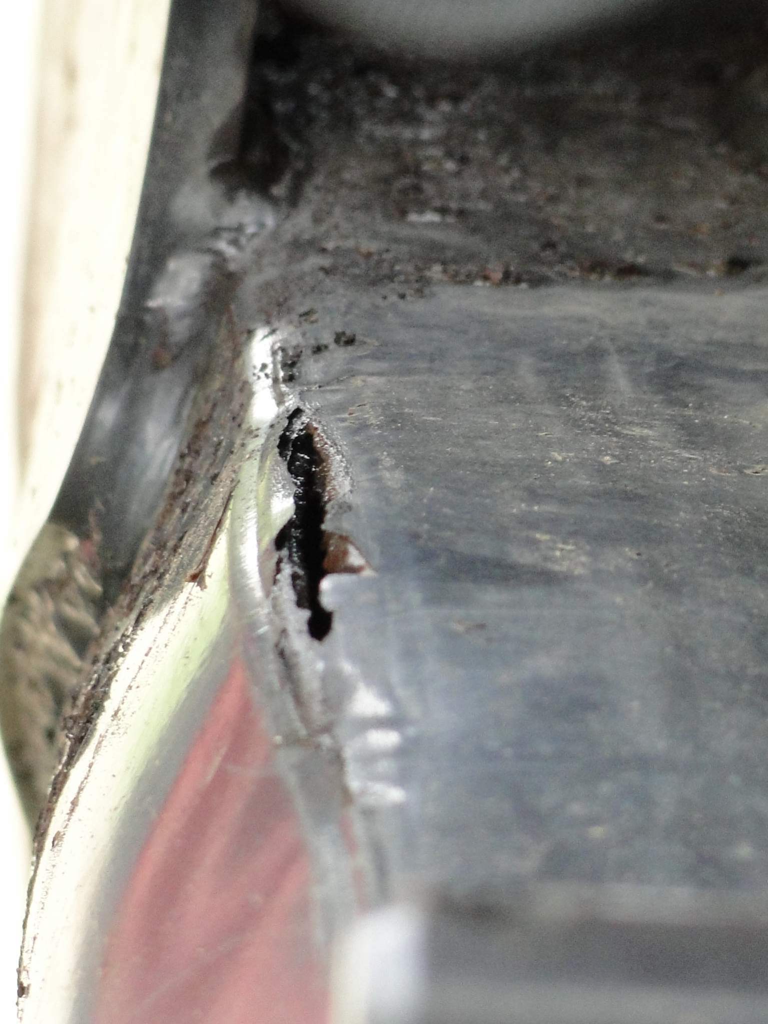

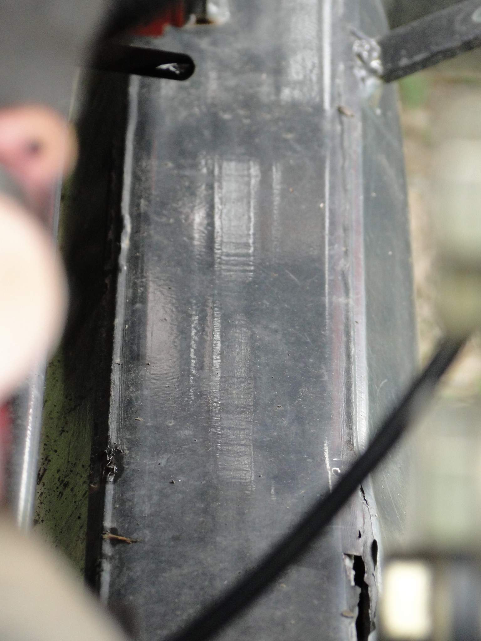

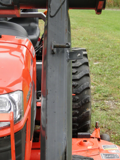

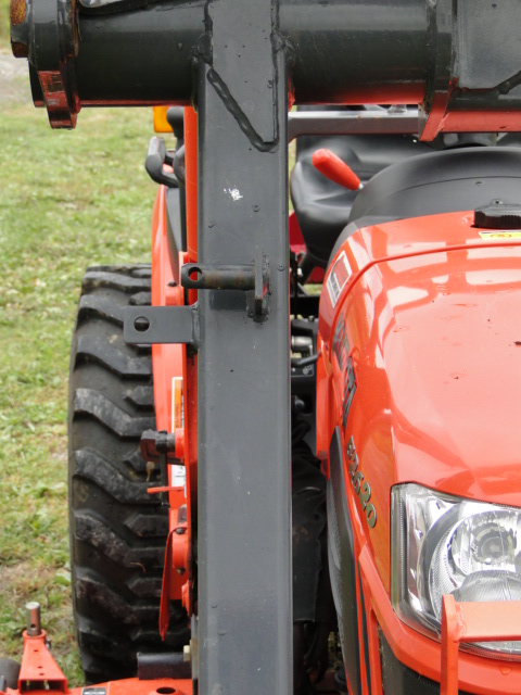

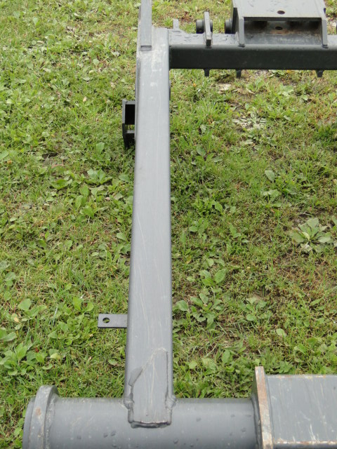

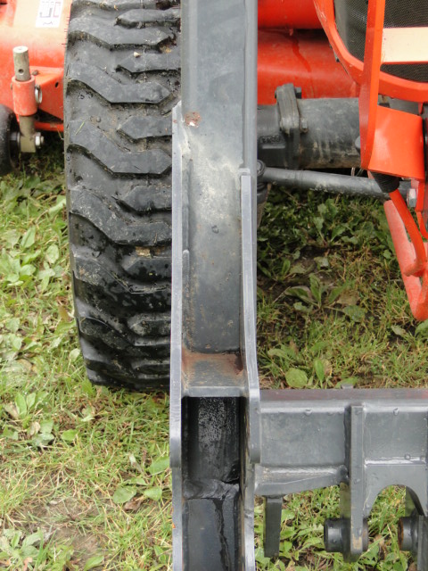

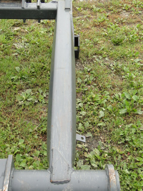

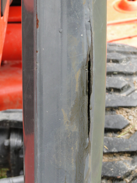

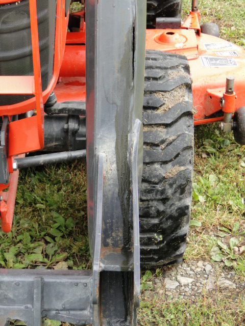

Here are the pics off the tractor, pics with frame resting on ground are the bottom of the frame, pics standing up are top of frame. Shot both sides of the frame so comparisons could be made.

You were right - the picture is worth a lot of words. The ballooning of the tube looks like repeated freezing and thawing over the winter of a full load of water, each cycle adding to the deformation. There had to be a crack somewhere allowing water to go in - with no way out.

with the exception of the open crack, there is nothing else that penetrates that steel. I went over it with a fine tooth comb today. the new frame was suppose to come tomorrow, dealer called today, he called kubota this morning and it wont be here until next monday. they had to fabricate it. can't fix the hydraulic problem until i get the frame on. my faith in the orange is slowly disappearing.

What I see in pic 1, 3, and 5 tells me that the metal was defective from the start. When the frame was FORMED, there was a lamination at the point where it was formed. In the lamination there was probably some dirt or rust. This STARTED the bend to fail. USUALLY this type of defect can be seen by inspection at the factory. HOWEVER, there are times that it does not show up until a long time later. When it does, it fails. IMHO, I would try to get dealer to help you get the replacement free or at least at a VERY reduced cost. :2cents: Best of luck. Let me know what happens. :thumbsup:
