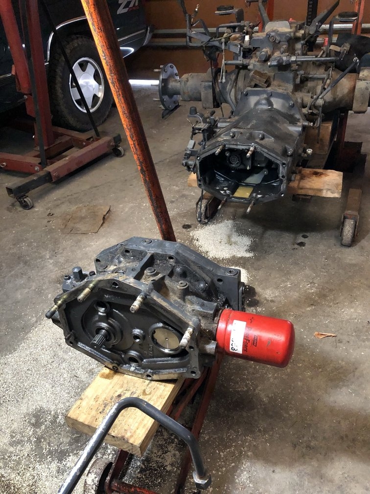

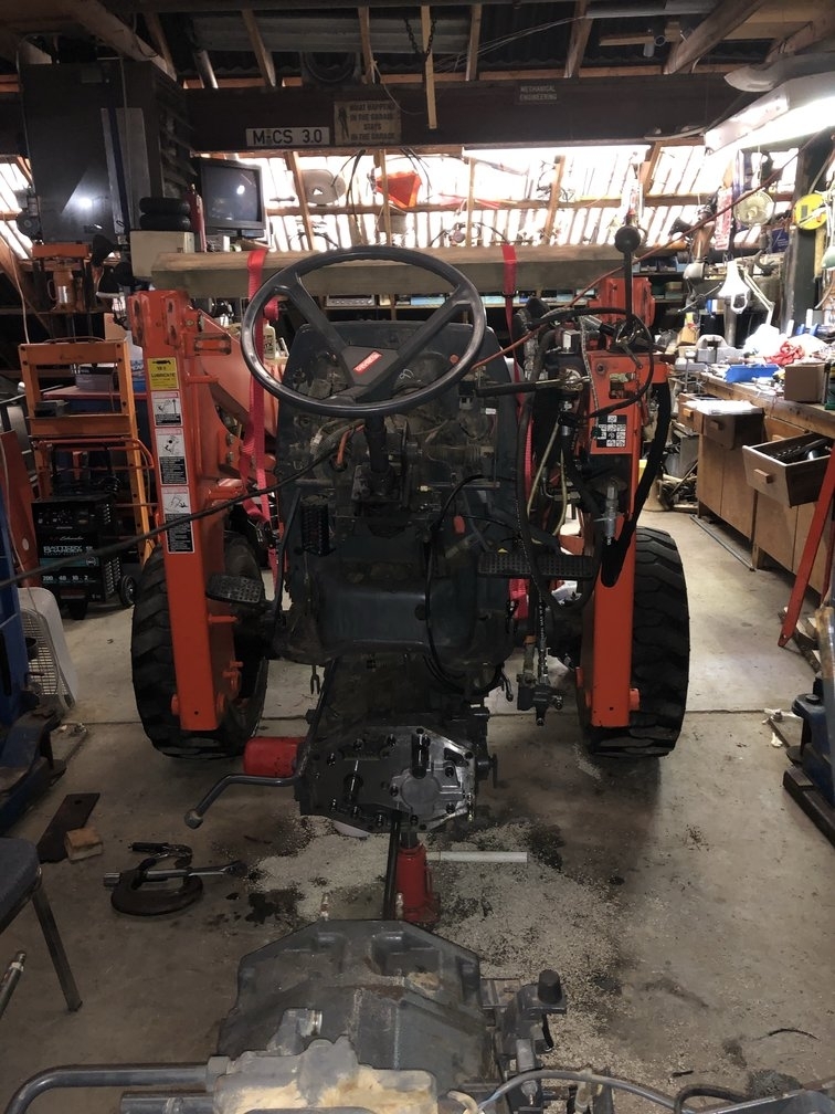

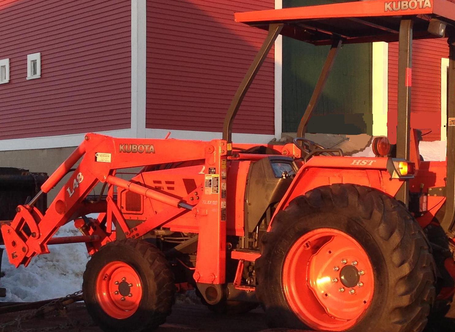

Members here may remember this L48 HST story from 2013 . It had developed weak reverse and the repair estimate was north of ten large. The owner decided to sell it as it was, and I adopted it.
With regulator and servo piston adjustments reverse worked again, but wasn't perfect. I've used it that way for quite a while. Its a strong capable tractor. But reverse isn't 100% so it was finally decided to have a look inside.
The ROPS comes off first, then the rear wheels and the main frame. The WSM describes taking off the loader and center console - but they can be left on. The loader posts were unpinned from the main frame and the steering column assembly can lift a few inches for clutch housing access.
The HST has to come apart, so the first separation was behind it. Then the HST was rolled away from the clutch housing.
In the next few days I'll post what was found in the HST and the cure. More old/new pics when swash plate cradle bearings are delivered.
While clutch is accessible, a new disk and release bearing will go in, and new sleeve and seals on the front driveshaft. It hasn't been leaking but you know it will start if new parts aren't installed. Dick B.

No pilot bearing in this model. And I'm moving at "retired" speed - a few hours at a time. It's actually at the halfway point because its beginning to be reassembled - new clutch and release bearing are installed, front driveshaft parts are next. All parts are ordered, some delivered. New swash plate "bracket with bearings" (EDIT - now expected Wednesday 3/27). Hoping to get it back together enough to run a few days later.

Now that I've seen inside the HST up close I'm feeling good about its future. The pump and motor show no wear at all. Only the 2 cradle bearings are damaged. One had come loose and was blocking swash plate motion. They are a laminated composite of non-magnetic material (?) Luckily the debris went into the filter without chewing on other parts. The swash plate could use buffing but it has no measurable wear. I'll take pics when the new parts show up.
The clutch housing is back in place (without taking any more apart). The job is just waiting for cradle bearings at this point.
