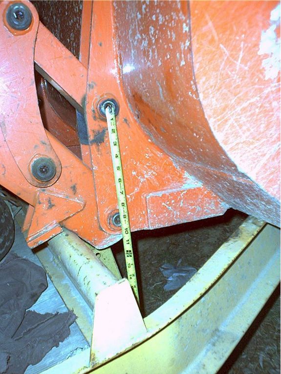

Over the weekend I a chance to try the latest fixes to my L 48 loader. As my previous posts document The dealer had removed my hydraulic leveler valve and ran the hoes directly to the loader curl cylinders. With that configuration I was happy with the loader operation at first but after running for several hours the hydraulic oil got hot and the loader lost power both curl and lift.
There was some confusion on my part about what they were changing for the heat up problem. Service manager said it was the leveler valve but on my second trip to the dealer. I got to talk to the mechanic as he was finishing up the replacement and what he had replaced was the front distribution block. Told me that the pressure was falling of about 500 lb. when it got hot. He also adjusted the system relief on the new distribution block so that the pressure was on the high end of it range when measured at the backhoe connection point to offset pressure drop in the system. Some thing over 2900 lb.
He also reinstalled the hydraulic leveler valve, seems Kubota wanted it back on. Probably a liability issue.
Now the results.
The first thing I did was to drive the front wheels over the edge of a bank to sinuate getting stuck. I put the HST in neutral, set the loader bucket down vertical and tried to push myself backwards by curling the bucket. This had worked when the hydraulic leveler was removed but I couldn’t do it now. This is important for me as I plan to use the tractor to maintain skid trails and to skid logs and sometimes get stuck. I see an improvement in the ability to back drag with a vertical bucket. Probably do to setting the system pressure on the high side. But it is still marginal. When loading the loader with slate rock and dirt which is pretty heavy I find the curl to be a little weak, again it worked good with the hydraulic leveler removed.
Stopped in to talk with the dealer and he suggested that I call Kubota again. Called the regional center in Columbus Ohio and the person I had talked to was in class so I left a message and got called back by a John from W. NY . Talked about the problem and he is going to talk to the rep for my area and get back to me.
Incidentally he ask about the backhoe outriggers. (mine work great) and a meeting with Kubota Management that I see in other posts her.
From looking at how the hydraulic leveler works it looks like Kubota will have to replace the cylinders on the loader with larger ones or go to a mechanical system like the new John Deere 110 uses .
It might help if everyone who is seeing this problem would call Kubota and complain Loudly !
John

Not 20 min. after my last post I got a call back from Todd Bectel the area Kubota Service Rep. And the word is that if you have the new loader valve installed and pressure testing shows that pressures are within limits then the tractor is working as designed. He told me that there is nothing in the works in the way of changes. Ask about the R520 valve that is mentioned in some of the posts and according to him they aren't doing anything with it.
When I ask him how to go about asking for my money back He suggested that I talk to the dealer about trading my tractor in on something else. Don't know what they have that isn't smaller than the L48. Also told me that, although it not in writing,. If a change came out, even after the warranty has expired and you had a complaint on file they would probably give you the upgrade. Next Step ???

I just met with the Kubota design guy (from Japan), a rep from Georgia factory (loaders) and a design tech from California at my local dealer on Monday. Info. as follows:
1. the first fix for lack of downpressure on the loader bucket was a new valve. Unfortunately that valve needs to put put to relief first & then curl the bucket down and you can scrape all day with downpressure. There is currently a TSB to fix teh problem & dealers will get info. as it becomes available.
2. If you purchased the quick coupler for the bucket, there is a TSB out to weld the spring retention washers as they are currently held by 2 pins which are inadequate.
3. If you have trouble with leak down at your backhoe stabilizers, there is a TSB to replace the o-rings in the valve assembly. The factory rings are a butyl rubber type & can NOt withstand the heat & pressure, the Tech Service Bulletin has a kit to replace the o-rings with new teflon rings.
4. Don't worry guys, Kubota is working on fixing any troubles with the L48, your dealer is most likely the one not up to date. Fortunately my dealer has his act together & orders parts for TSBs for my equipment without calling & then just calls & tells me he needs to fix my tractor. Great Service!
