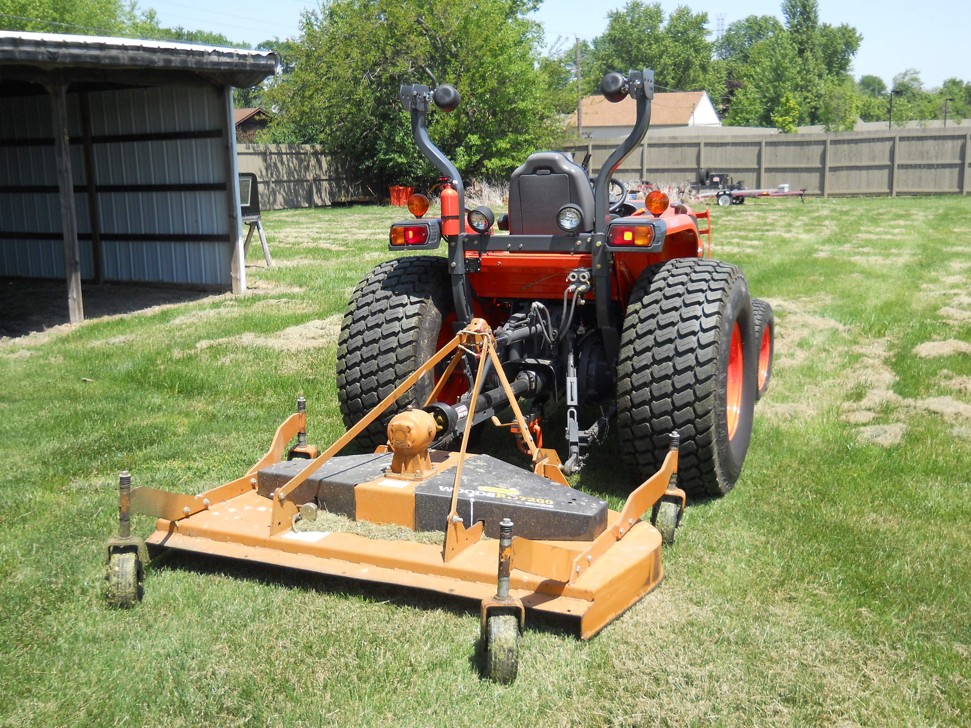

Aug 6, 2012 / L4330 Turf Tires #4 PHILIP8N Veteran Member Joined Sep 2, 2009 Messages 1,381 Location Indianapolis Tractor Kubota L3940 Kubota GR2120 Ford 8N I think the galaxy tires are smaller diameter, super wide, minimum tread, thin ply golf course mowing tires. Here are my 44x18-20's. Philip. Attachments DSCN0102.jpg 1.1 MB · Views: 1,407
