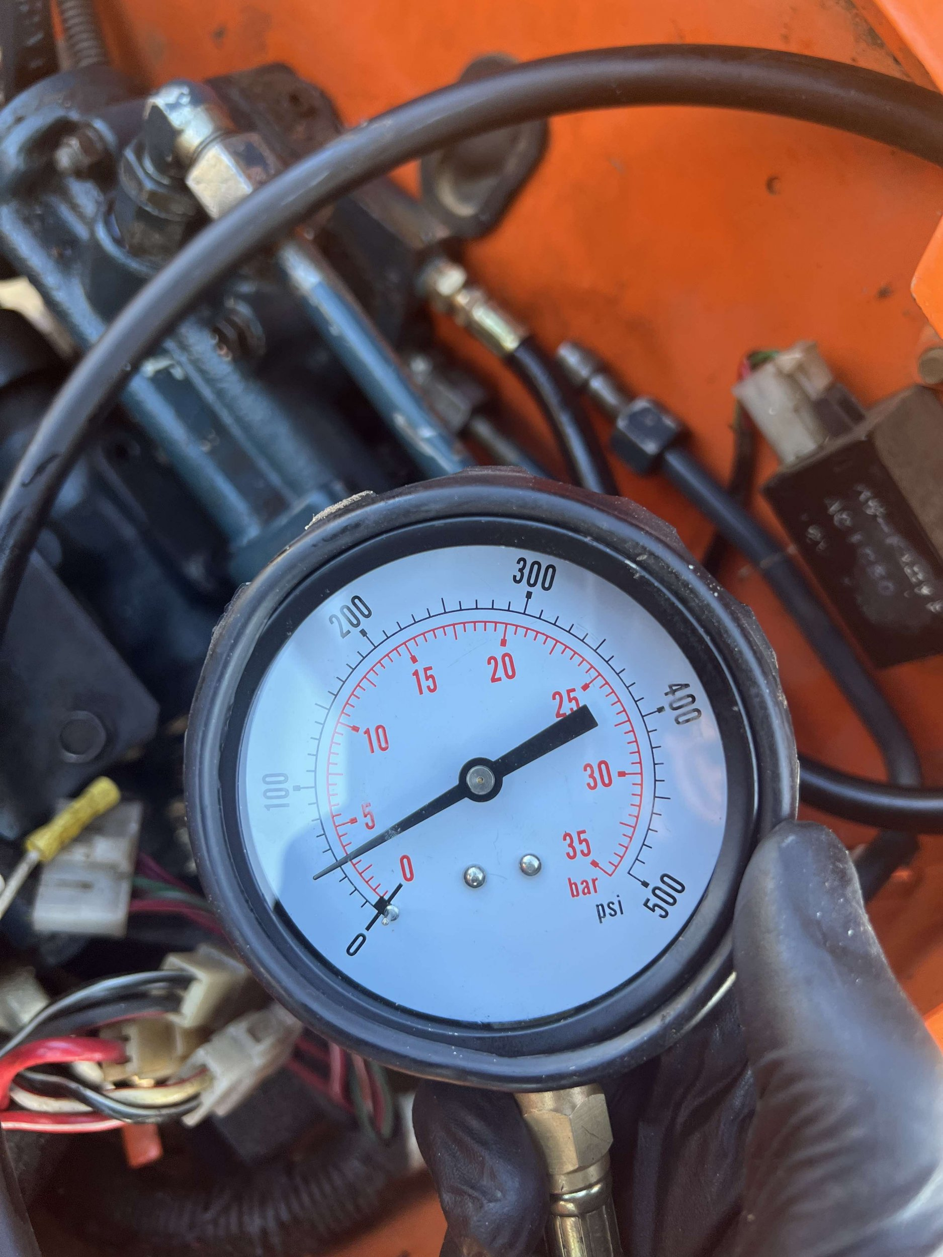

This is the exact pressure I am getting from the Forward/Reverse and Lubrication circuit. I think my next step is to figure out the thread going into the shuttle valve and test the pressure coming out of the priority valve. I also removed the added shims off the plungers I showed a few posts back and there was 0 change in preasure.

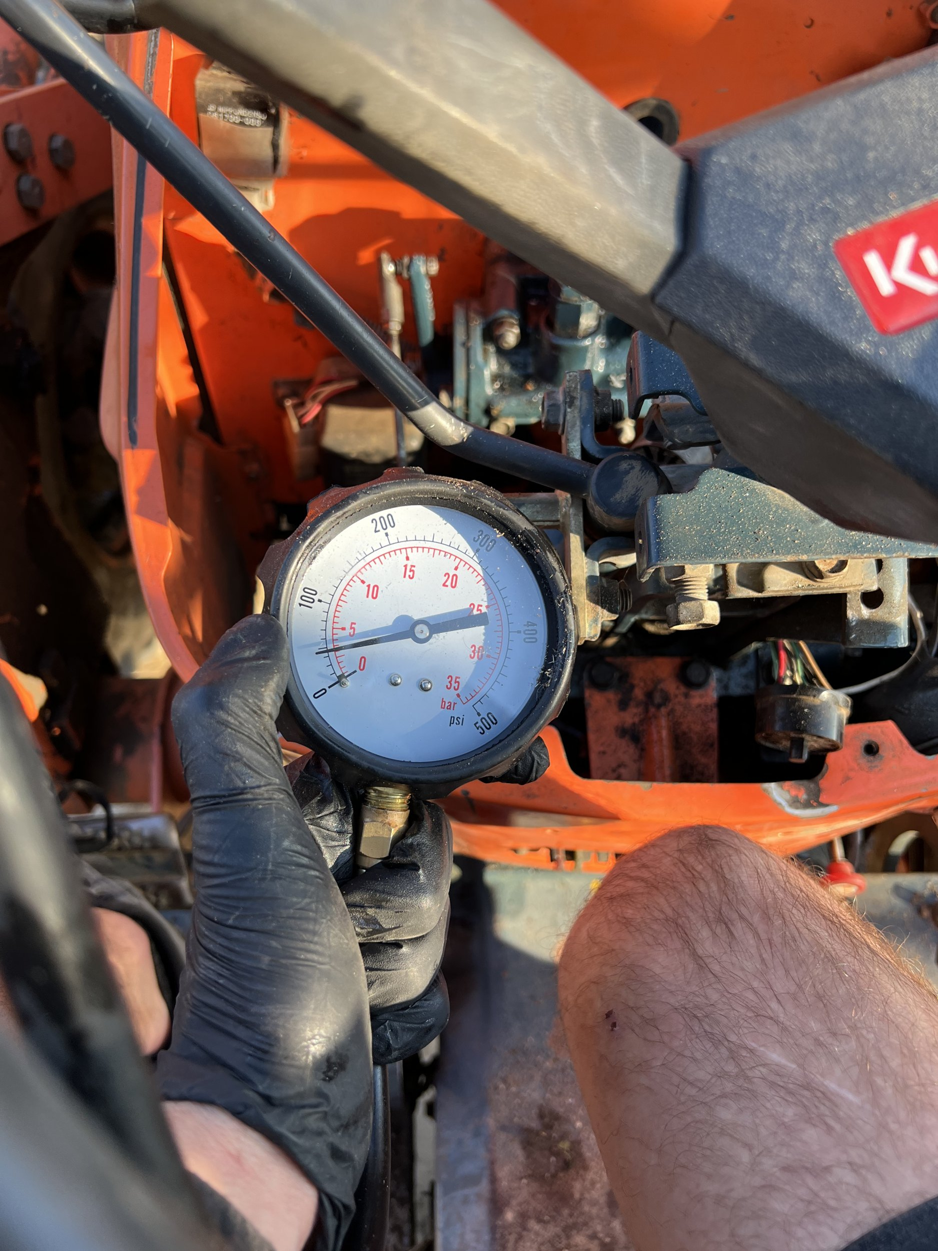

#29
Just a quick recap on pressure testing from the Shuttle control valve. I'm getting about 43 PSI from the forward/neutral/lubrication circuits, I tested pressure out of the priority valve with my 500 psi oil test setup spun the needle around 3 times, and blew the hose. That tells me there's good pressure out of the priority valve. My other hunch was some kind of an internal hydraulic leak within the transmission bleeding off the pressure. Today my replacement oil pressure testing gauge/hose came and this time I tested pressure out of the Forward hydraulic line output and the pressure was exactly the same, taking an internal leak out of the equation

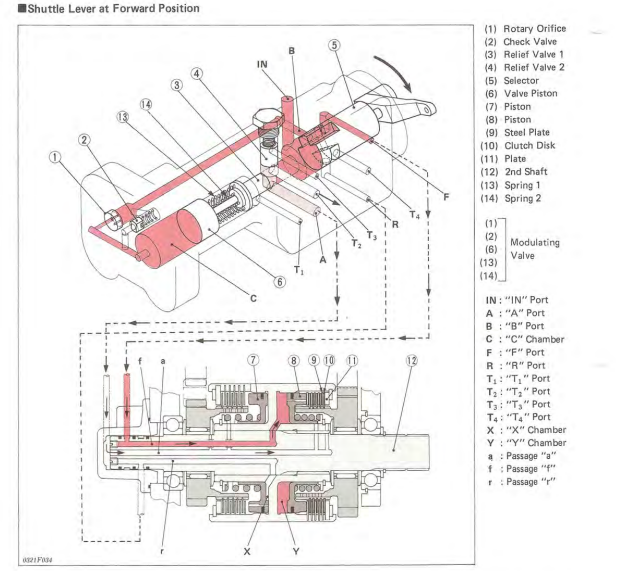

I've stared out the diagram in the workshop manual till it looked like spaghetti, but there is a pressure relief valve that cuts the lubrication pressure down to 42.7 PSI
at this point, it seems like all the positions are pushing open that relief valve. I'm thinking maybe there's a blockage in one of the orfices or something that is routing all the oil through the pressure relief valve?
It's time to take it apart and see what I can find, if it doesn't fix it, I'll order the one on eBay.

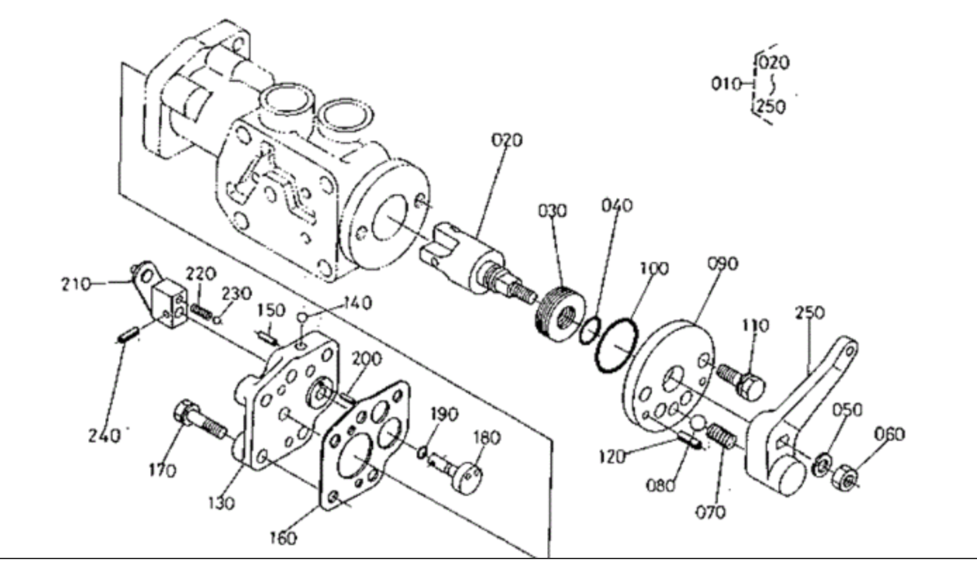

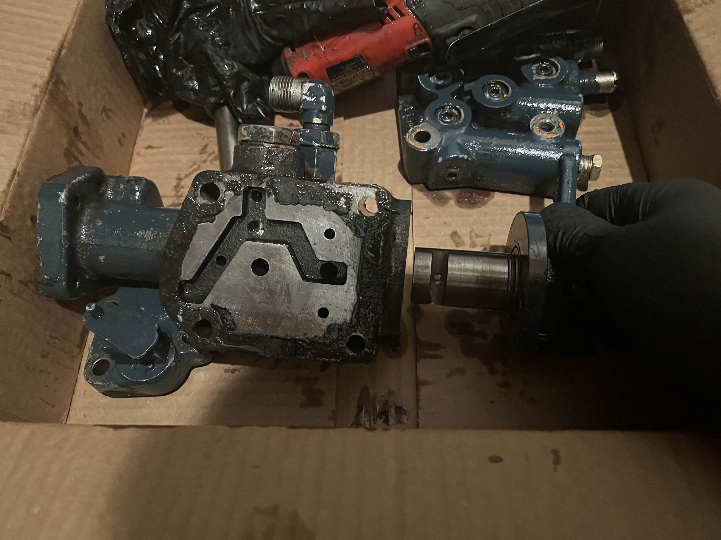

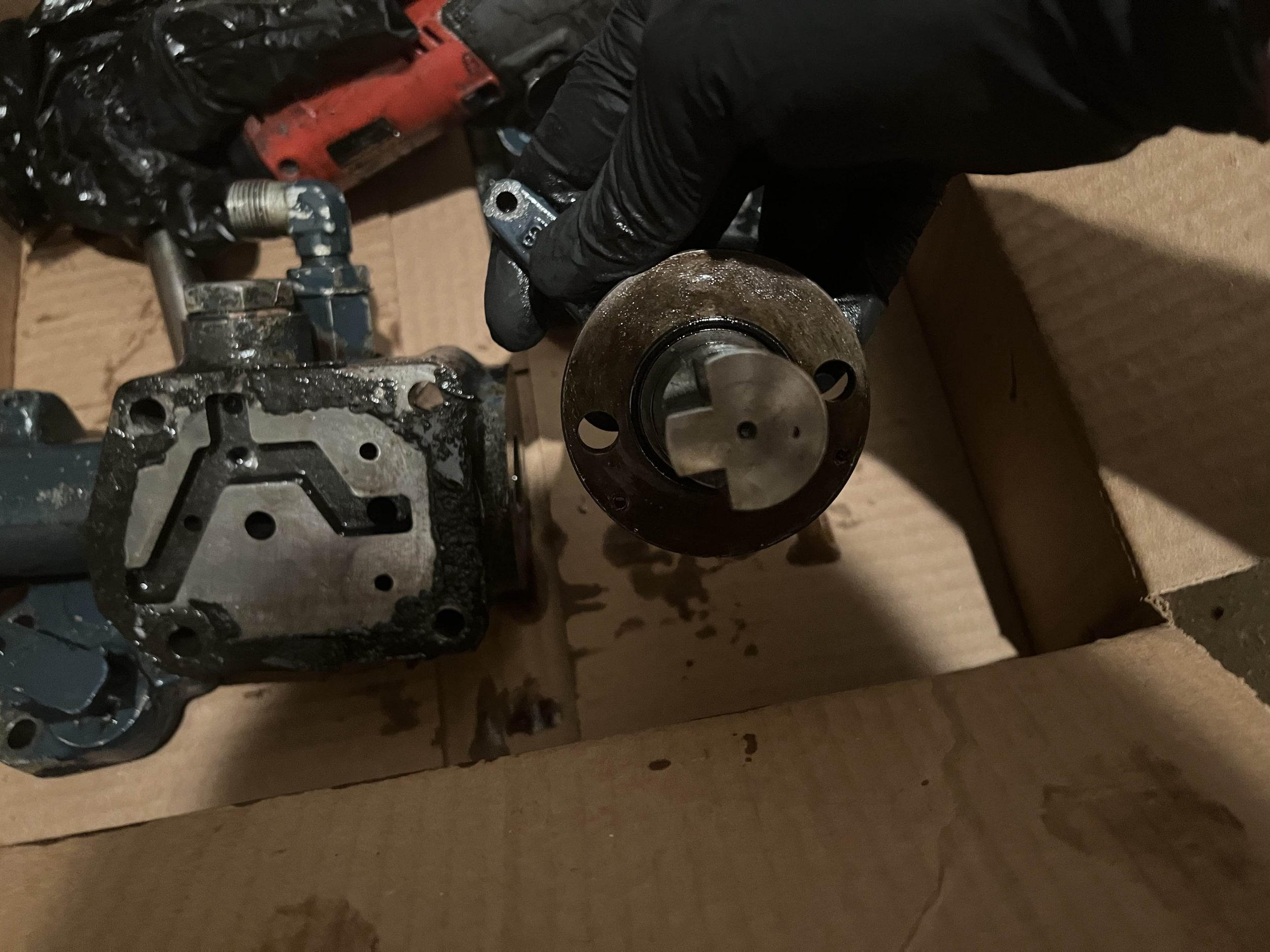

I pulled it apart and checked everything out, but couldn't find anything inside that didn't look right when I compared it to diagrams. Considering it had twice as many shims as it should have on one plunger, and lock washers as shims on the other, I decided to take a second look. Went through the WSM and went over all the diagrams and I finally noticed something:
With the shuttle control at the same orientation as the diagram, 020, the selector piece is clocked wrong on my pump.
