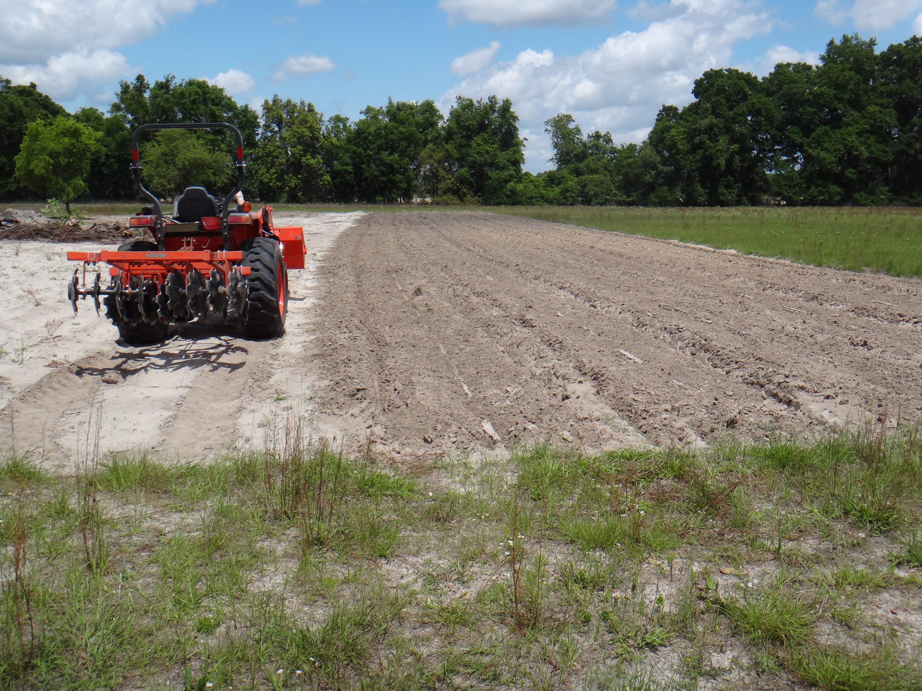

Could you guys direct me to any resources videos and/or pics of users that have had success using a disc and / or two bottom plow with a tractor similar in weight and HP as the L3901.
Your plow questions were answered in Post #3 and Post #4.
Here is information on how to select a Disc Harrow: http://www.tractorbynet.com/forums/attachments/308251-disc-harrow-selection-18-45-a.html?highlight=
Every combination of implements imagineable are used for food plots. However, on T-B-N, the most used combination is a Disc Harrow with 9" spacing between the pans, with a weight of at least forty pounds bearing on each pan, then a Cultipacker. I would expect the same on the QDMA forum.
Food Plot seed mixes are cheap and strong germinators. So Disc, sow fairly thickly, and Cultipack is one good (and safe) option.
Learning to plow is more difficult and time consuming than learning to harrow. Plowing on slopes and contour plowing are advanced skills.
