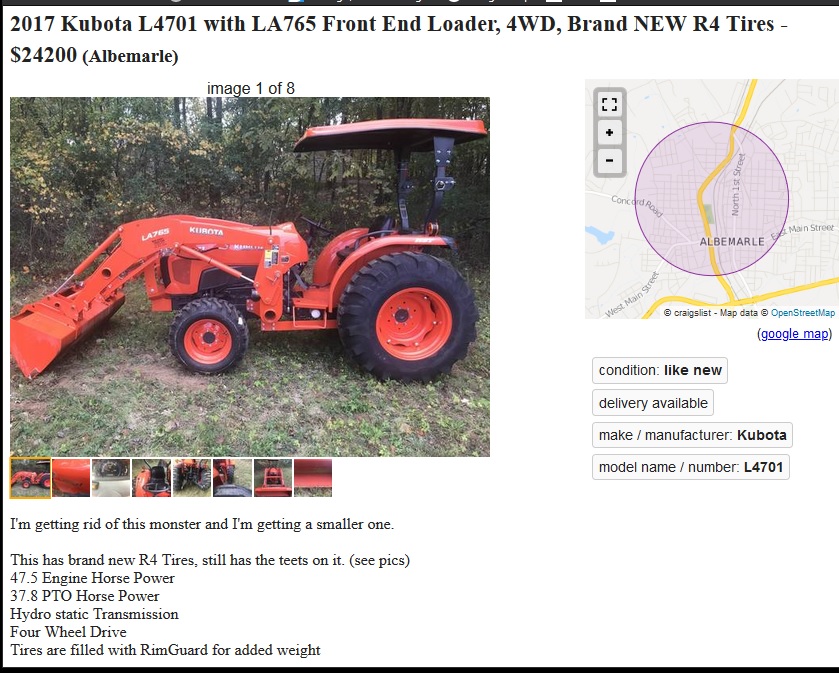

This just popped up on Craig's list... "I'm getting rid of this monster and getting a smaller one"
It's got 290 hours.
