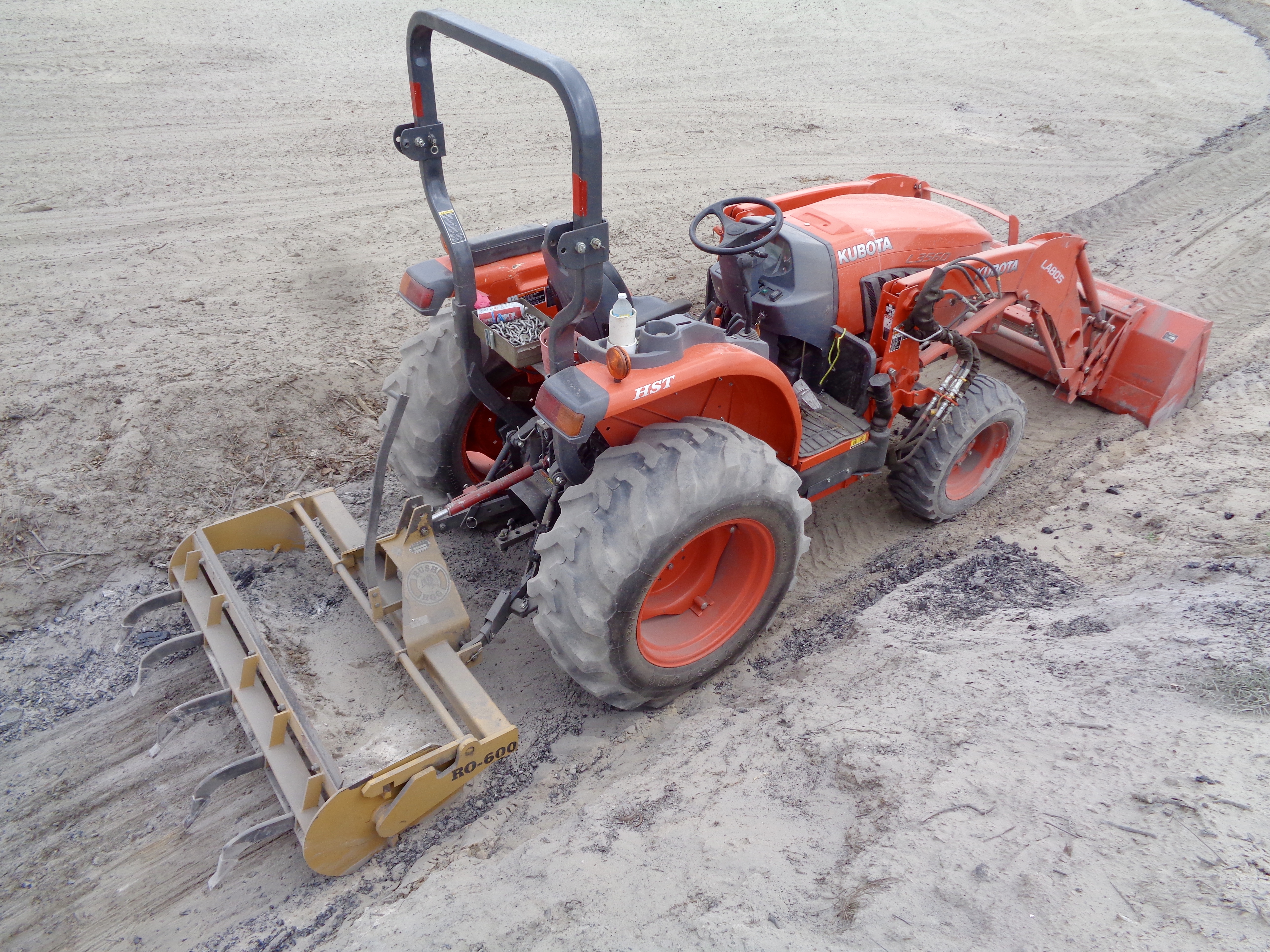

The rear R4 tires on the Grand Ls are, unusually, on two part wheels. L3560 rear wheels/tires can be spread to any of three width increments: 52.2", 53.5" or 57.7" tread width. Tread width is from CENTER of one rear tire to CENTER of other rear tire. Tread width is published because tire suppliers change tire configurations but tread width is always tread width.
Spreading the rear wheel/tire stance increases tractor stability more than any other individual option. Consider rear wheel spread first.
My L3560 with R4/industrial tires set at 52.2" tread width has an outside-to-outside tire width of 62". Tire marks in soil are about 59", outside to outside. Buy a 10' stick of 1-1/4" PVC pipe. Cut pipe at max tire width. Mark narrower widths on pipe. Walk around your land, comparing pipe to tree spreads, gates, etc.

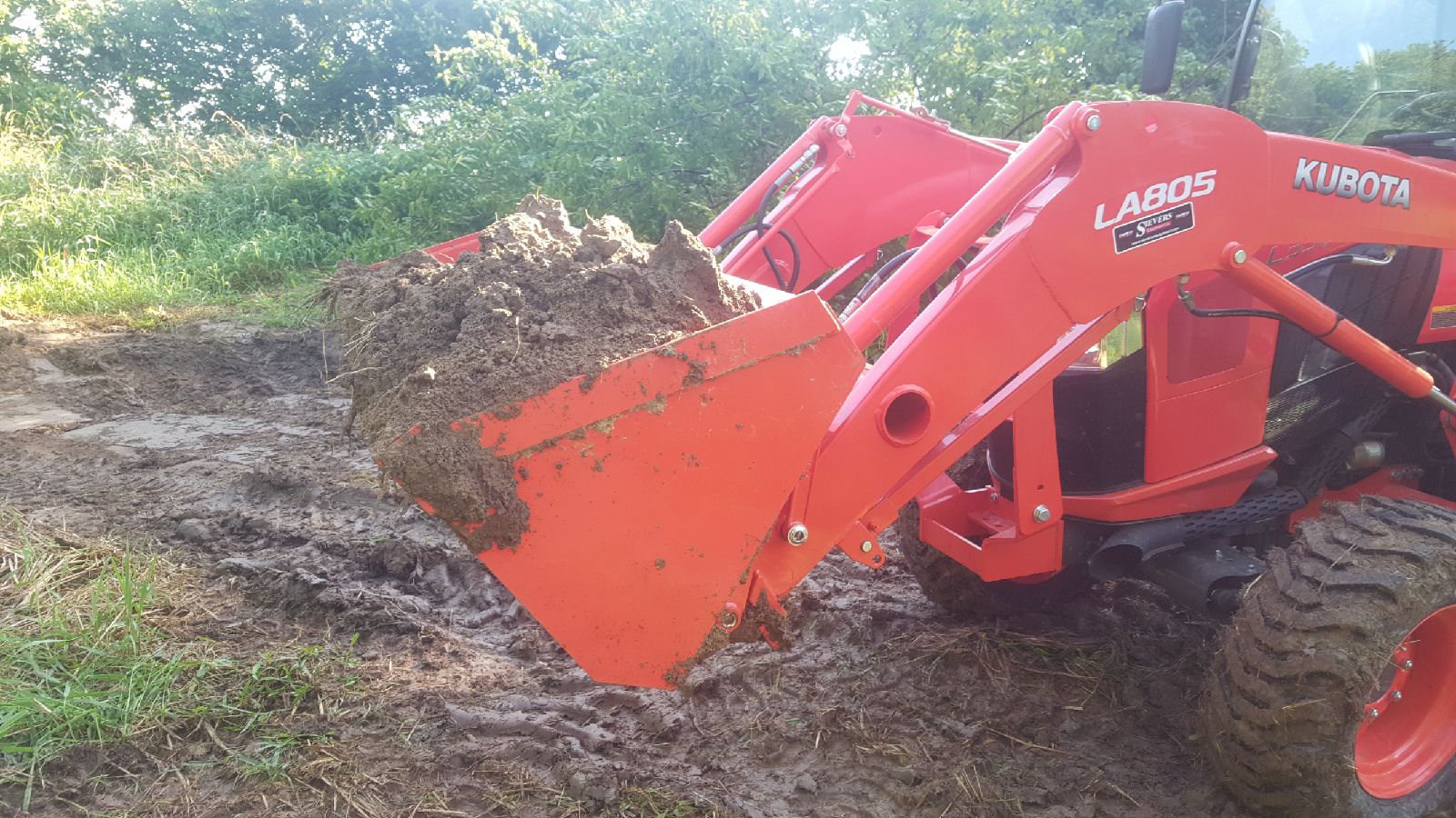

My OPEN STATION L3560 with R4 tires inflated with air pulls a 620 pound Rollover Box Blade, full of dirt, uphill, fine. Don't fill the rear tires; it is pointless.
Soil is fine sand/dirt mix for first 12 inches then heavy clay. When it rains much it turns to soup, anything with any weight goes straight to the clay.

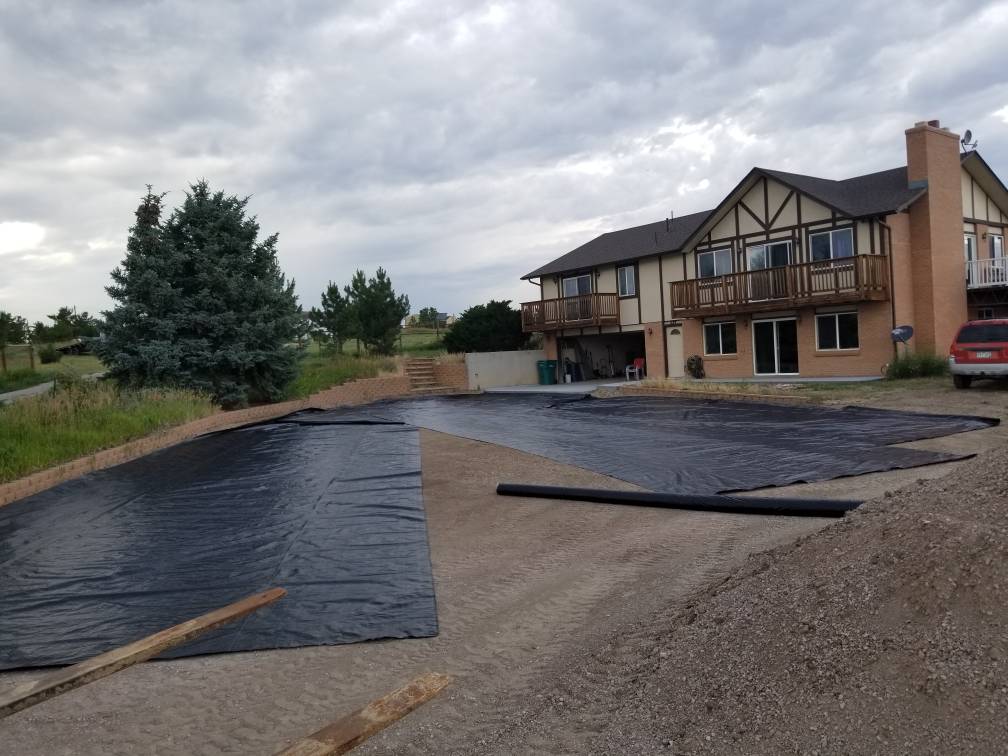

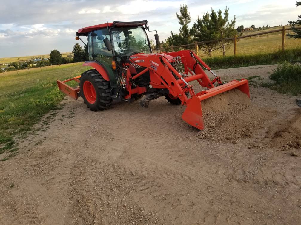

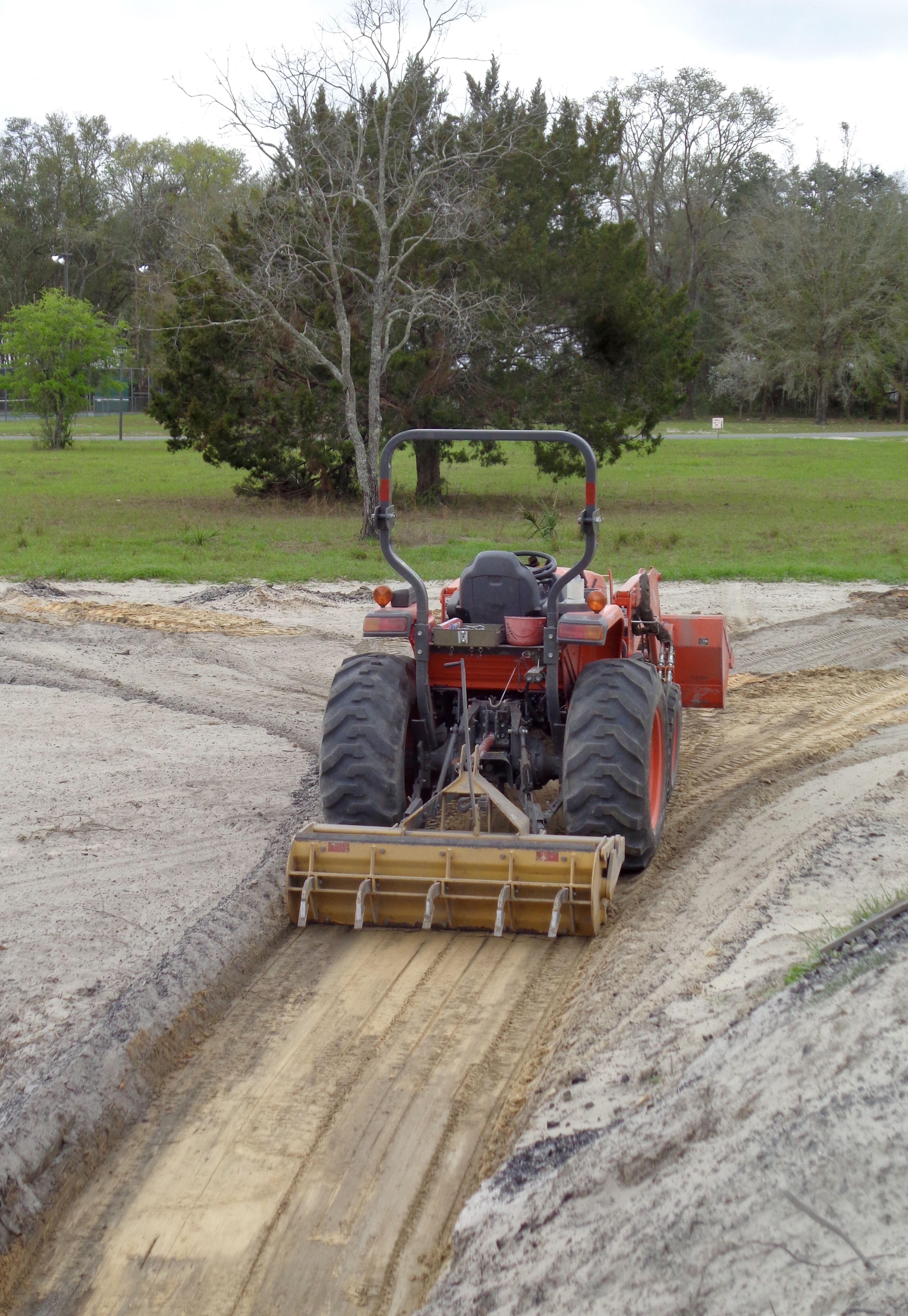

My L4060HSTC has slightly bigger tires than a L3560 weighs maybe 200lbs more than an equivalently equipped L3560. I loaded my rear tires & havent regretted it.

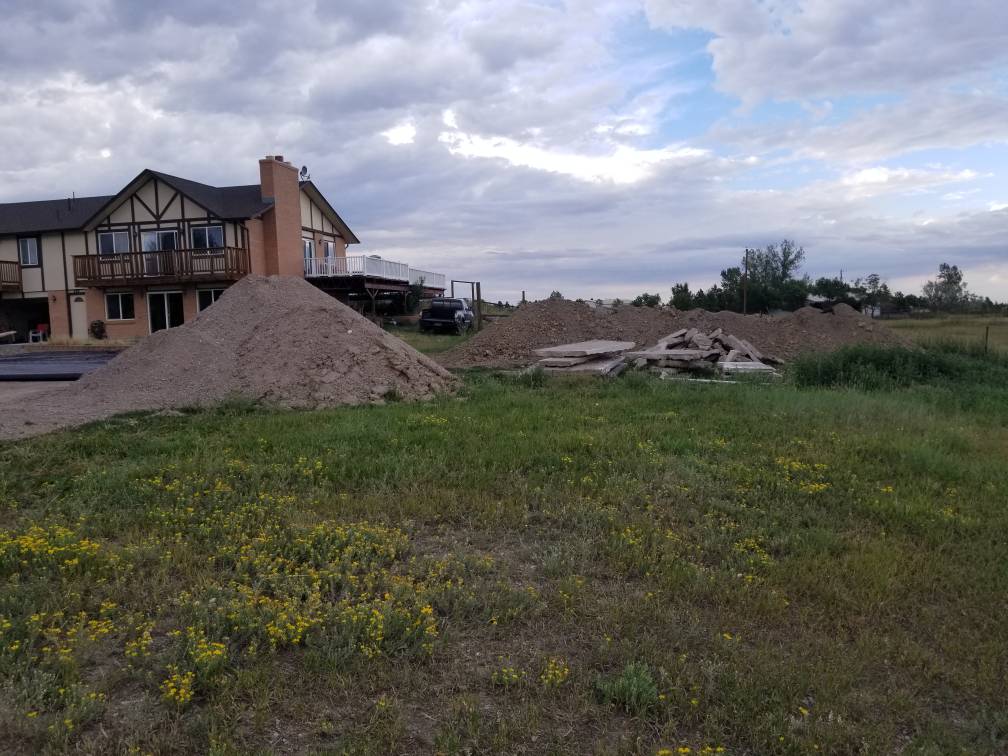

Doing some serious regrading of my front drive with a 6' Gannon box blade put my traction to the limit. I can usually get away with M low for most work. I sometimes have to switch to low range, but as often as not I run out of traction first.
Interestingly my 5' LPGS can almost stop the machine as well as the 6' Gannon in a good few situations. No action photos of the Gannon & minimal ones of the LPGS apparently.
You can probably read between the lines on the tractor photo for the biggest reason not to load the rear tires (loading the fronts isn't recomended & doesnt help stability). I havent had any issues though.
My machine is stable at max loader lift with minimal 3pt ballast. Way more stable than my L3200 with loaded rears & heavy 3pt ballast. Loaded tires dont unload the front axle like 3pt ballast does. But it does help stability & traction. You feel the extra weight going up hills though. I road my machine between jobs a lot & moderate hills are 15mph down, 6-7mph up.

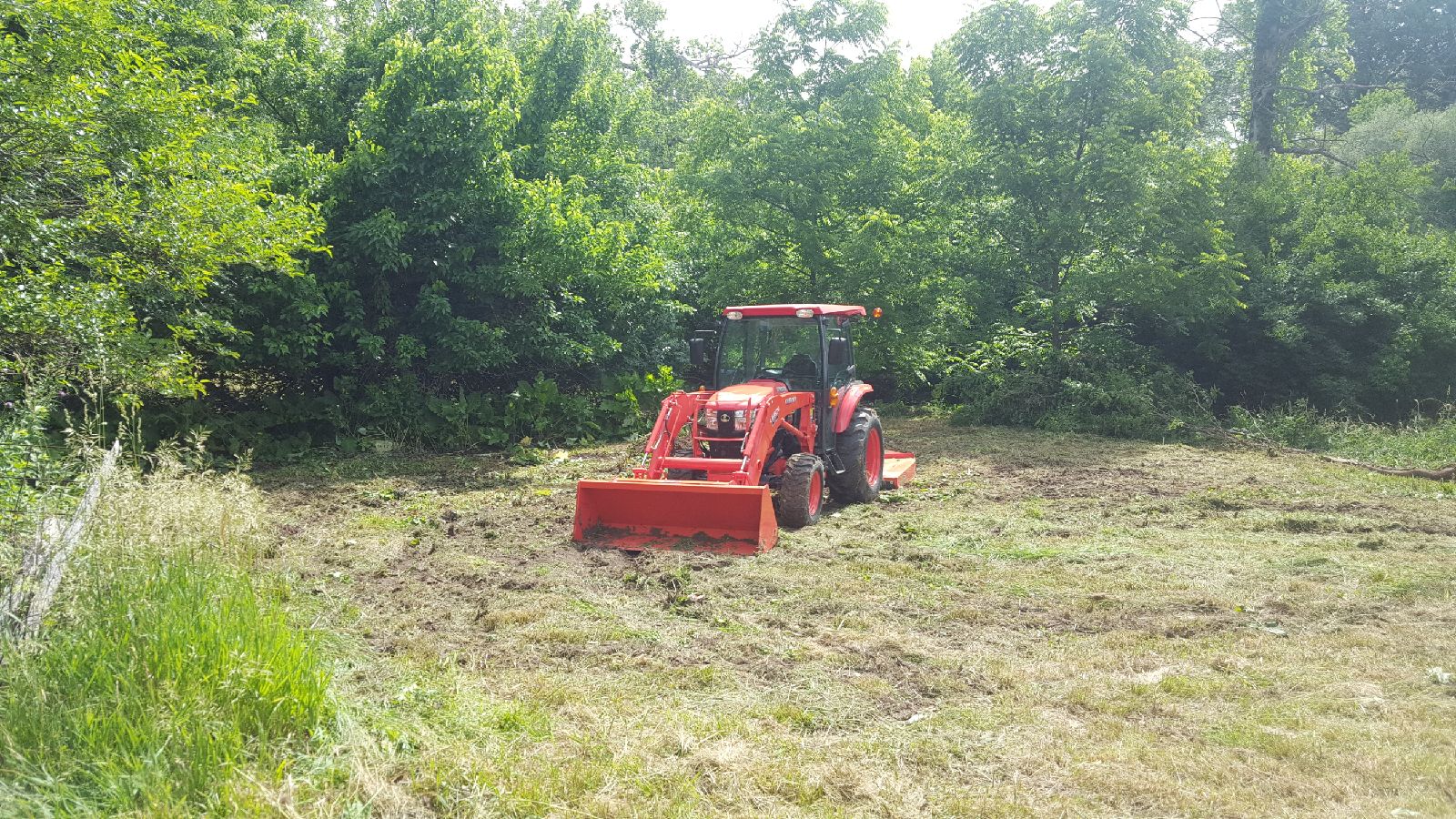

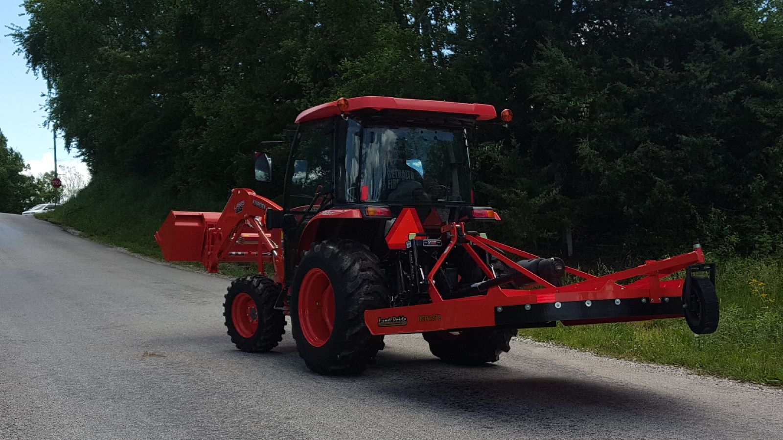

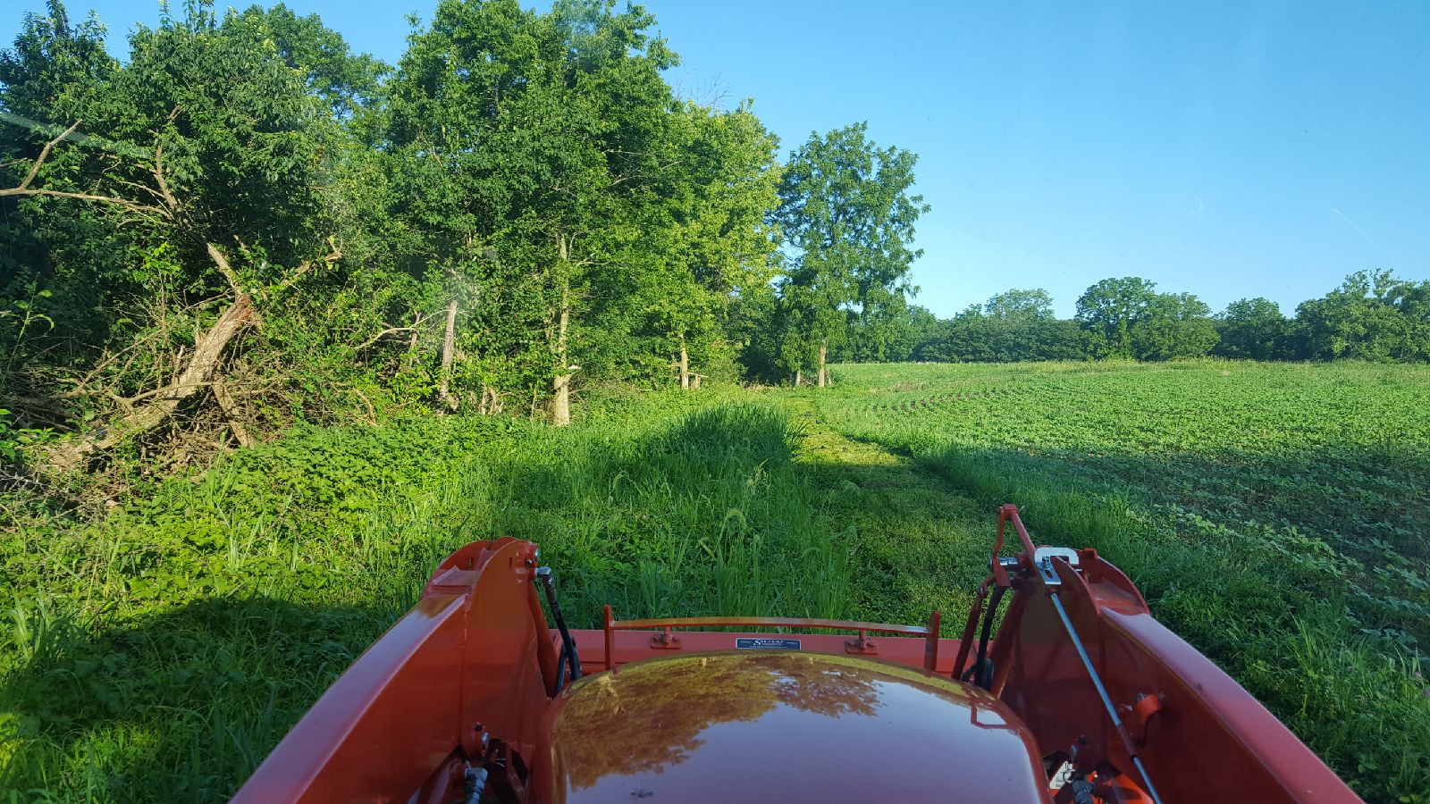

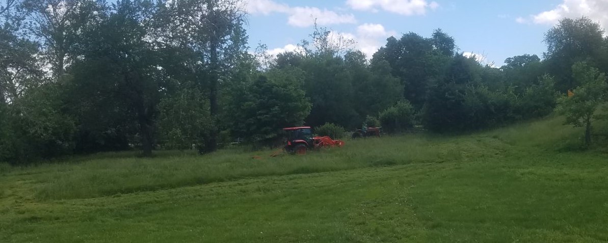

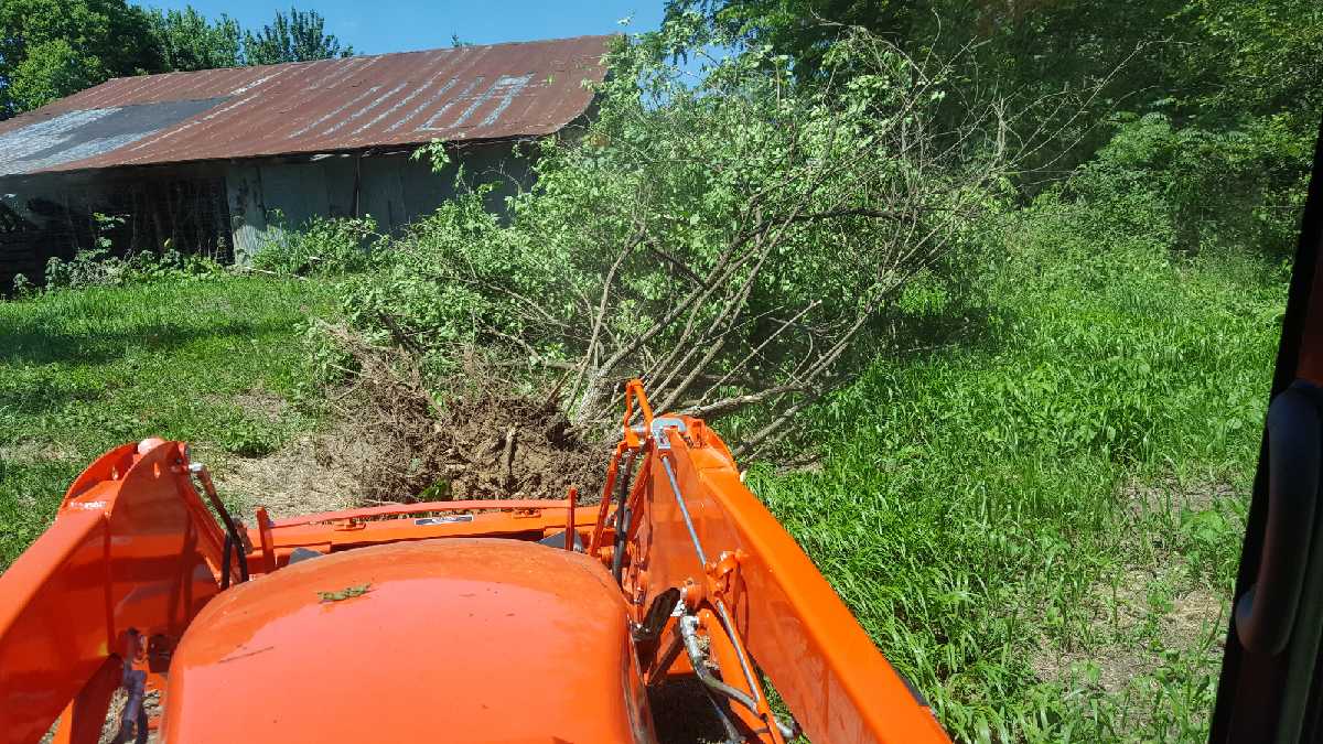

I really like my L3560HSTC. As you can see by the pictures below, I use mine for mowing, moving dirt and concrete debris, along with clearing trees.

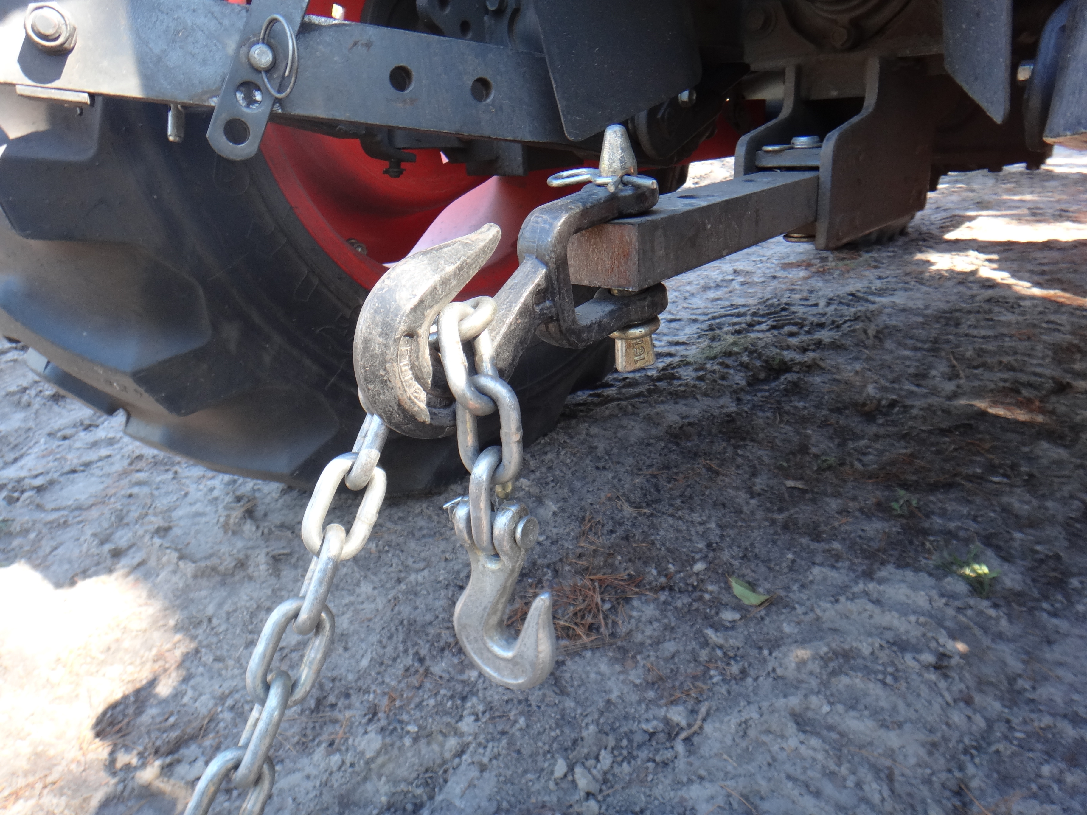

You will like find plenty of use for a clevis grab hook attached to rear center drawbar. PHOTO

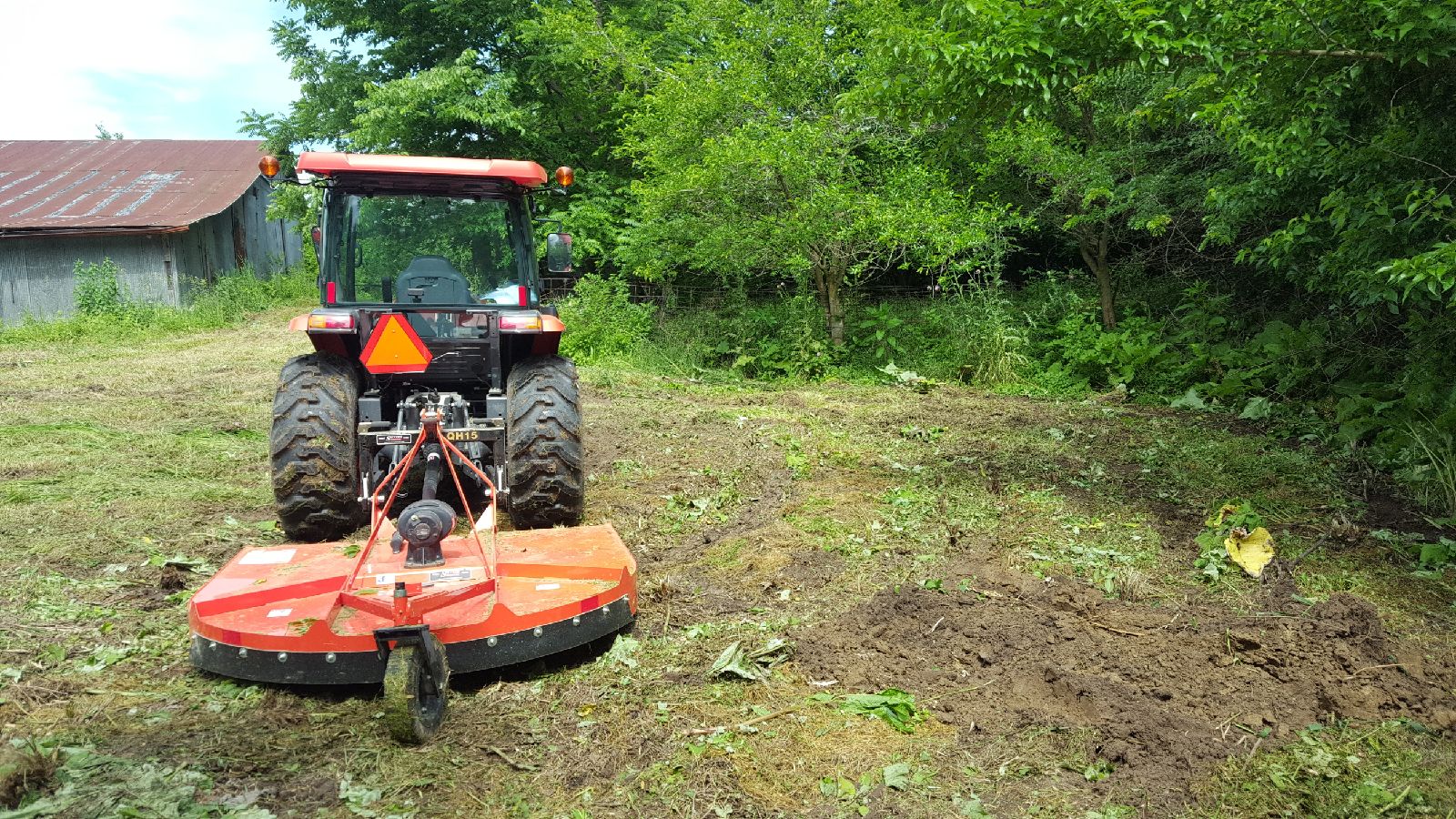

My rotary mower is the Land Pride 1272. It works really well, in the heavy, thick stuff I have to slow down, but most of the time I can move right along.
The MF is a MF275 which belonged to my grandpa that my dad now owns. We use them on the family farm, which is a small 80 acre farm.

I have a plain clevis on the back of mine to put a slip hook on when I chain the machine down when hauling. That fancy chain hook clevis is cool if you only use 1 chain for both sides though.
