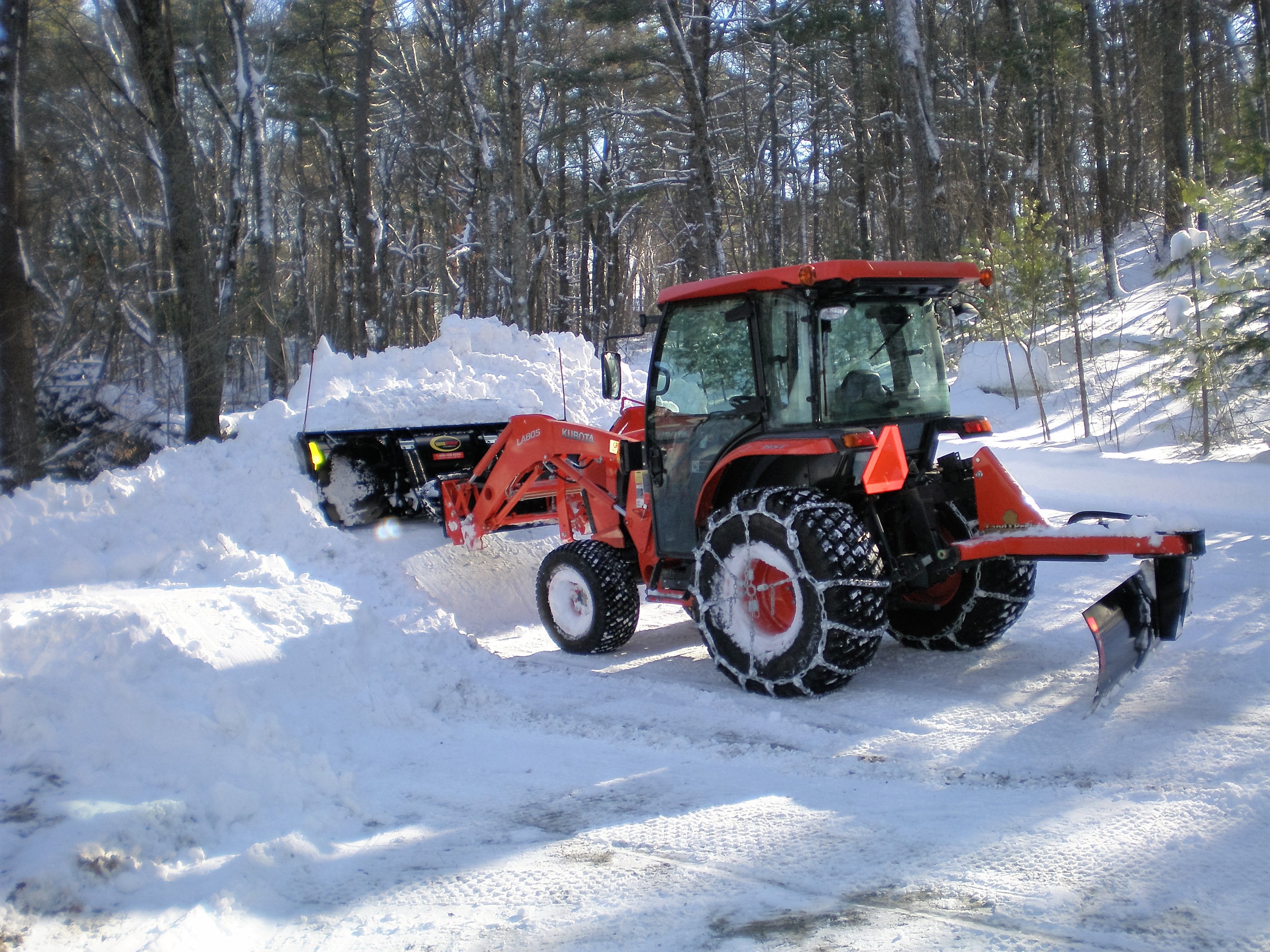

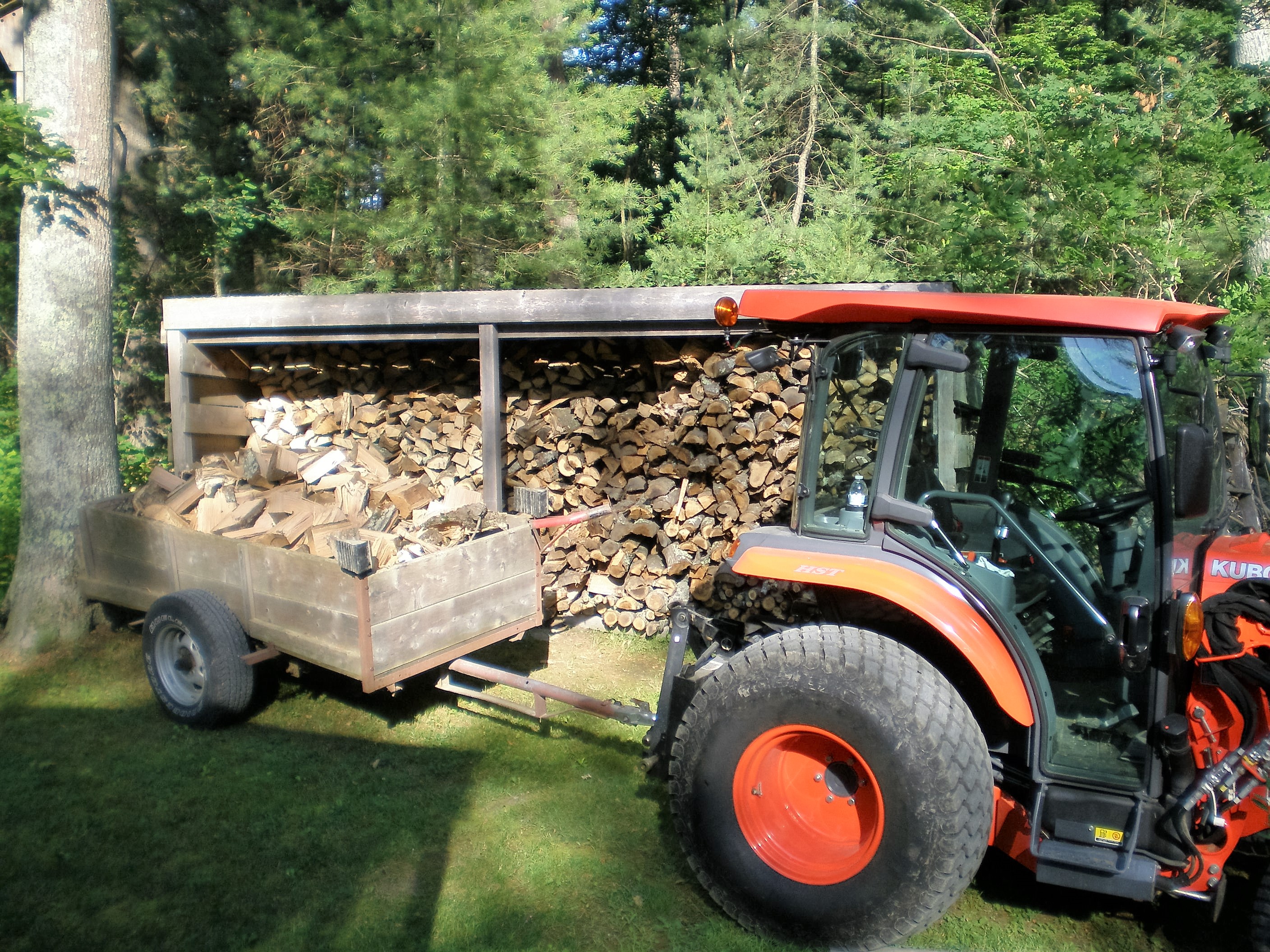

I love my L3560HSTC. I bought it for the heat in the winter as I hate the cold and plowing my 1000' gravel drive with the winds whipping the snow at me sucks. The bonus was the AC as the glass on the cab is like a greenhouse, the sun comes in and heats up like an oven. The AC works great and NO BUGS! P1280013 (4).JPGP7060002.JPG
