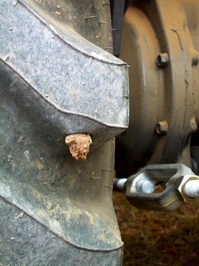

When I pulled the tractor out today at the ranch my wife spotted a twig on the tire. She thought that was odd until she noticed that it was MOVING WITH THE TIRE! Apparently I have about a 1/4+ dia. branch stuck in my loaded rear tire.:eek: I believe the tire is a 19x15.5 the branch was sticking horizontally deep into the tread and it does not appear to be leaking any air. I don't even have 20 hours on the tractor! :(
How are these tires constructed ? I really wanted to pull it out but I resisted. Are the treads on the tire solid rubber ? It really looks like it only penitrated the tread and not the body of the tire itself. I am wondering if there is a way to just plug the hole up once I pull it out if it is made of solid rubber and has not reached into the tire cavity itself.
How expensive are these anyway?:mad:

If it's just in the tread you are fine. It's solid rubber. If you are concerned, post a photo and we can have a closer look. I always find pieces of fence wire that are stuck in the tread and I've pulled them out with no harm.

Well it goes in on one side of the tread but I do not see it coming out the other side. The bulge in the tread that I can see makes it LOOK like it's just inside the tread but since there is no "exit wound". I am not sure if it does not extend far enough or is going down towards the tire body itself.
I got some things to do at the house and some work related work to catch up on. I'll see if I can head out to the ranch later today to do some work and I'll snap a picture of it while I am there.

I've pulled all sorts of junk out of my r1's. Yank it out! Post pics! If it goes flat I'll come over and help you load it up on your trailer to take it back to the dealer.
I'm curious, can these tires (with no tubes) be patched?

I've pulled a lot of junk (twigs, nails, screws, pieces of wire, pieces of metal) out of my tires. I just pull and wait and see. So far I've been lucky, no leaks.

I just got back and forgot to look at the manual. With the valve stem at 12 o'clock I am showing 20psi, it's a 19.5x15 loaded and I got to search the web to see what the pressure should be. I did remember to take a photo though.

Looks like you may have lucked out and not went into the area with air. I'm never that lucky. Turn the tire so that the hole is on top just in case the hole goes farther in that it looks and then pull the stick out. If it does leak, call a tire service truck. I just had one out two weeks ago. I don't know what they charge in other areas, but it cost me $75 for two holes in the tube. The tire was dry so he didn't have to pump it. If it was wet, it would have been an other $10. If you call your dealers service manager, he will be able to tell you which service to call and which ones not to.

Great photo.
I think you could do either...leave it in there or pull out. Doesn't look like it will leak. That's amazing that a branch that thick penetrated that deep.

Thats a big stick.
If its not leakin now its not into the interior of the tire. Pull it out before you do a lot of work with it and it gets worked through and starts leaking.
Oh and I think I know what you mean by not knowing the construction of the tire. The tread portion of the tire is solid. On the inside it is a smooth surface(more or less, there are slight depressions where the tread is)
