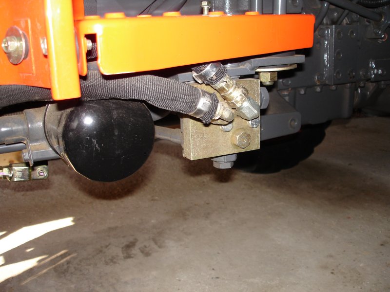

For what it's worth I have a single Kubota rear remote on my L3400HST. I have attached a picture of where the hydraulic lines connect to the tractor. The tank connection was routed to the rear where the filler is. There is a new plug with a fitting for the tank return.

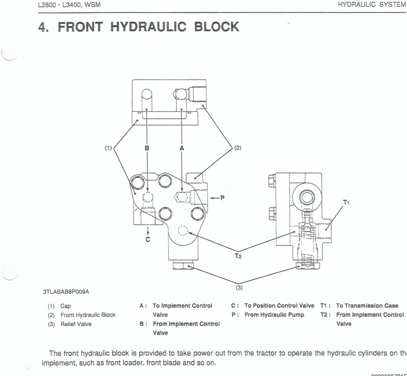

Here is a page from the service manual. I hope this helps.

That's on the right side, right under your foot right? Ahh... I just saw your avatar, you don't have a FEL on do you? That's where I think my FEL is all connected up to. Is that where I can tap into for a rear remote though?
j

That's the exact system I was thinking of, the CNC system, but I was unsure if that "valve block" on the right side, under your right foot is a power beyond or what? I love being a noob :)
j
Jw5875 said:
Try Carter & Carter for the TNT system. Basically is hooked up to the power beyond front loader valve with a return line to valve block at the bottom of your tractor. Unit clamps on to ROPS on right side.
I have the "Original" TNT from un-named person, unit is great!!!
JW 5875
j
If you have the FEL you should be able to tap into those lines. It is on the right under the floorboard.
