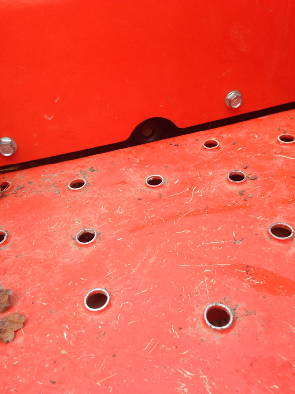

My sight glass finally bit the dust and cracked.
Noticed a wet spot on the concrete about 4" diameter and it was pretty wet around the glass. Sure enough it was cracked.
So I guess time to order one. I was hoping I dodged the bullet on this common issue since the tractor is 9 years and 900hrs old.
Got a 3/4" pipe plug in there now til I can get one ordered.
Keep an eye on that area fellow owners.:thumbsup:

Mine gave out at around 350 hours a few years ago. The new one is gray and the dealer said it is the improved one. So far OK, We'll see.
   / L3400 sight glass #9
I had the same issue with mine at about 350hrs. Got the Kubota gray plastic replacement and it is cheaply made. Don't over tighten it, you will strip it instantly.
I like the metal ones that the other members posted. When I change out the transmission fluid in another 50 hours, I'll change to that one.
