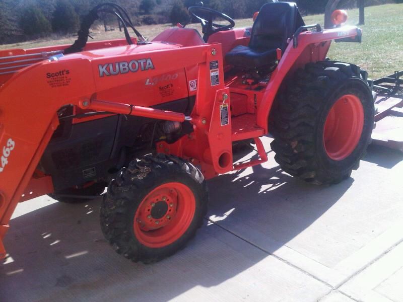

Hello all, been lurking for a while. I am in the market for a my first tractor. Wife and I purchased 10 acres of land and will be building our house next year.
Long story short I have been looking for about 6 months and believe I have settled on a B2620 with loader, 4 foot brush hog, blade, etc. I was planning on buying new, but I might have found a jewel in the rough.
I have come across a 2008 L3400 HST R4's with 96 hours, kubota FEL with tooth bar, 5 foot big bee brush hog, 5 foot atlas box blade, 5 foot king kutter tiller for $15,000. The owner is about 2 hours away from my house.
I think the L3400 might be a little big for my needs, but if the price is right, why not right? Rather have to much, than to little. Before I drive 2 hours to look at it - how does 15K sound for this kind of setup?
My tractor needs at first will be clearing the land as it is pretty rough, doing lots of hogging and moving dirt and gravel to build a 500 foot road. I also plan on doing all my own backfilling on the home. Once it is all said and done, I will use the tractor to maintain a dirt bike track I will build, and hog maybe 2 acres. I plan on getting a scag zero turn for the bulk of my mowing needs in year 2-3. Of the 10 acres 4 is woods, the rest lots of grass, fairly flat.

I am a cash buyer, new or used. The pics are not the best, but here is the ad.
kubota L3400
In my mind I want to get everything for less than 18K. For my use I need the loader, rear blade and brush hog. I "dont have to have" the rear box blade or the tiller, but they would be nice to haves.
The way I think about it, is with less than 100 hours on it, she is barely broken in. I know he keeps it in the garage, so my guess is (until I see it in person) is that it is in pretty tip top shape. He said he is selling due to health reasons.
The 2620 is going to cost me more than this brand new and I will not have as "big" as a tractor or be able to use a 5' hog which I want for my land.
I guess basically I need to go see it and see what he will take for it. If I can get him to around 14K I will probably just buy it.

Looks to be a Very nice condition tractor and with all the attachments I would buy it myself. Good luck on your decision.

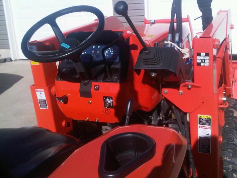

The L3400 was know to have a jerky 3PH. Not much can be done with it, just the nature of the beast. So I'd suggest trying that out BEFORE you make any rash descisions and see if it is something you can live with.
Second, they had issues with the hydraulic suction hose cracking. Not a big deal or even a costly fix,,,,under $100, but check it out. If you are sitting on the tractor, it is right in front of your right foot. Looks kinda like a radiator hose. See if there is any cracking and just be aware ot if.
Last, Find out if the 50HR service has been done. Either himself of a dealer.

1: the tractor is not to big for your uses.. It is not a big tractor, and you will enjoy using it a lot. The HST is a big plus in its favor.
2: It is an OK deal, not great, but OK, If you could get him to come down a little more that would be great, yes it looks nearly new, he did not use it a lot, but it is out of warranty. my 2010 has more hours. Also it does not appear to have the SSQA on the loader, mine did not either, ( not that common on L3400s) and I paid good money to get the adapter and a new bucket. I later modified my old bucket to make it SSQA also, then bought some pallet forks, (handier than a pocket on a shirt) real worthwhile addition.
3: It will have the jerky 3pt hitch. Thats a fact of life on all l2800 l3400 l3200 l3800 series tractors..there are thousands of threads here about that. you could read for days and days. Not a big problem to me, but is to some users. You have to decide if you can live with it. Smooth as silk going down, herky jerky when going up slowly. If going up all the way, then no problem, it is just trying to adjust it up slowly that the jerkyness is apparent.
So there are my observations, all in all a good tractor, love mine, and it does a lot of things I need done, and is a joy to operate. The 3pt hitch is like the one blemish, but I still love her:)

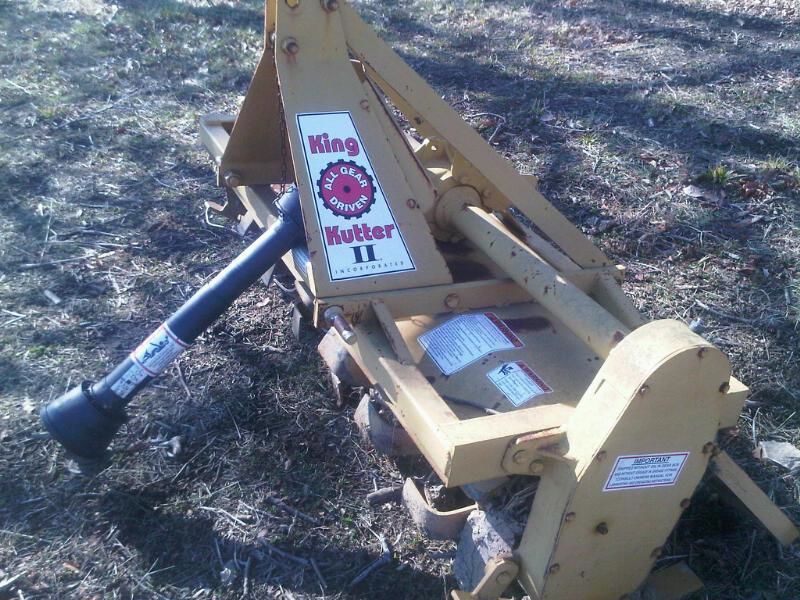

Thanks everyone for the advice and responses. The seller has sent me some additional pics, which I have attached here for all to see. Overall it looks very nice, and it was actually purchased from the same place I was going to buy my 2620.
The implements look ok to me, with the exception of the hog, looks a little beat up like it has been hit into some trees and stuff. Not a huge deal breaker for me so long as it cuts ok.
I think I am going to go look at it, see if I can get him down to 14K and if so go ahead and buy it.
BTW, I am in Kansas City MO. Thanks again everyone - Mike

One thing you might want to check on the Rotary cutter if you can is take a small adjustable wrench, and on the gear box on the cutter on the back about half way down will be a small plug with a square drive head. If you can back it out and gear oil should start to spill out of it, hopefully it wont be milky, (meaning water has gotten in) and hopefully it starts to run out. The body of cutter can be welded up and reinforced. I would ask to see it spin up, and when stopped look at the stump jumper and the blades to see they swing free. Maybe not a deal killer, but I think you said you needed the cutter right away.
