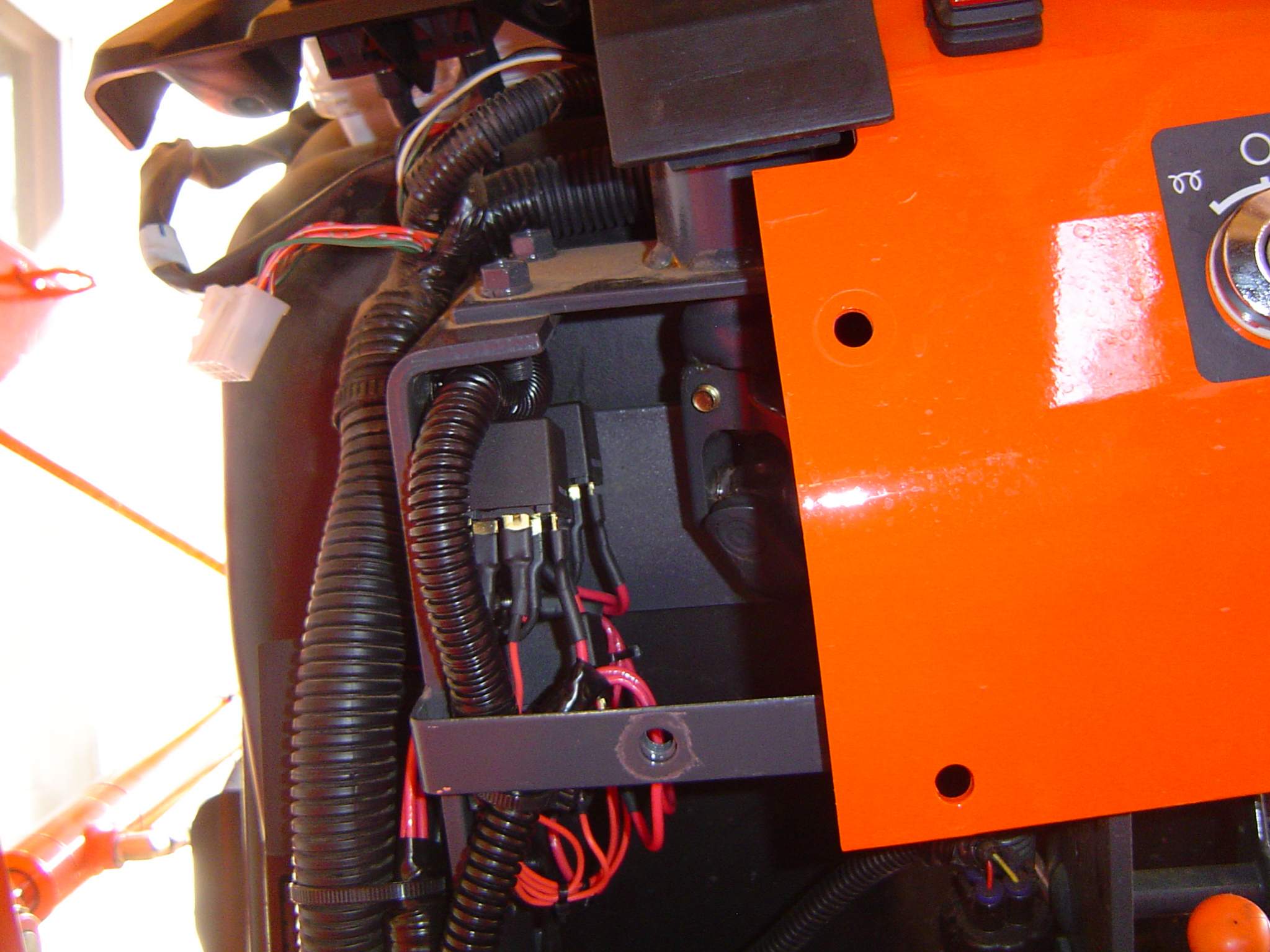

/ L3400 extra light plugs ? #2

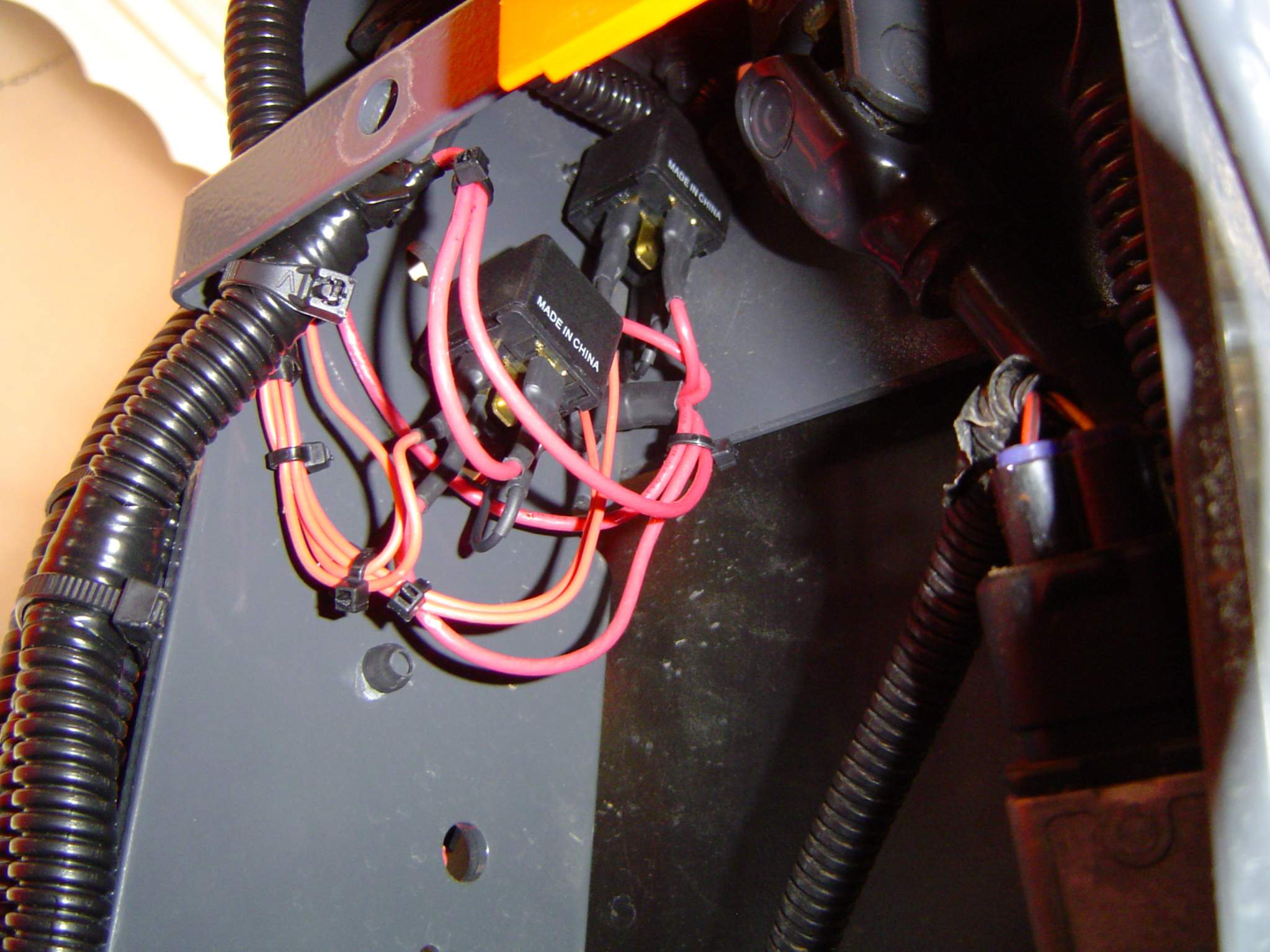

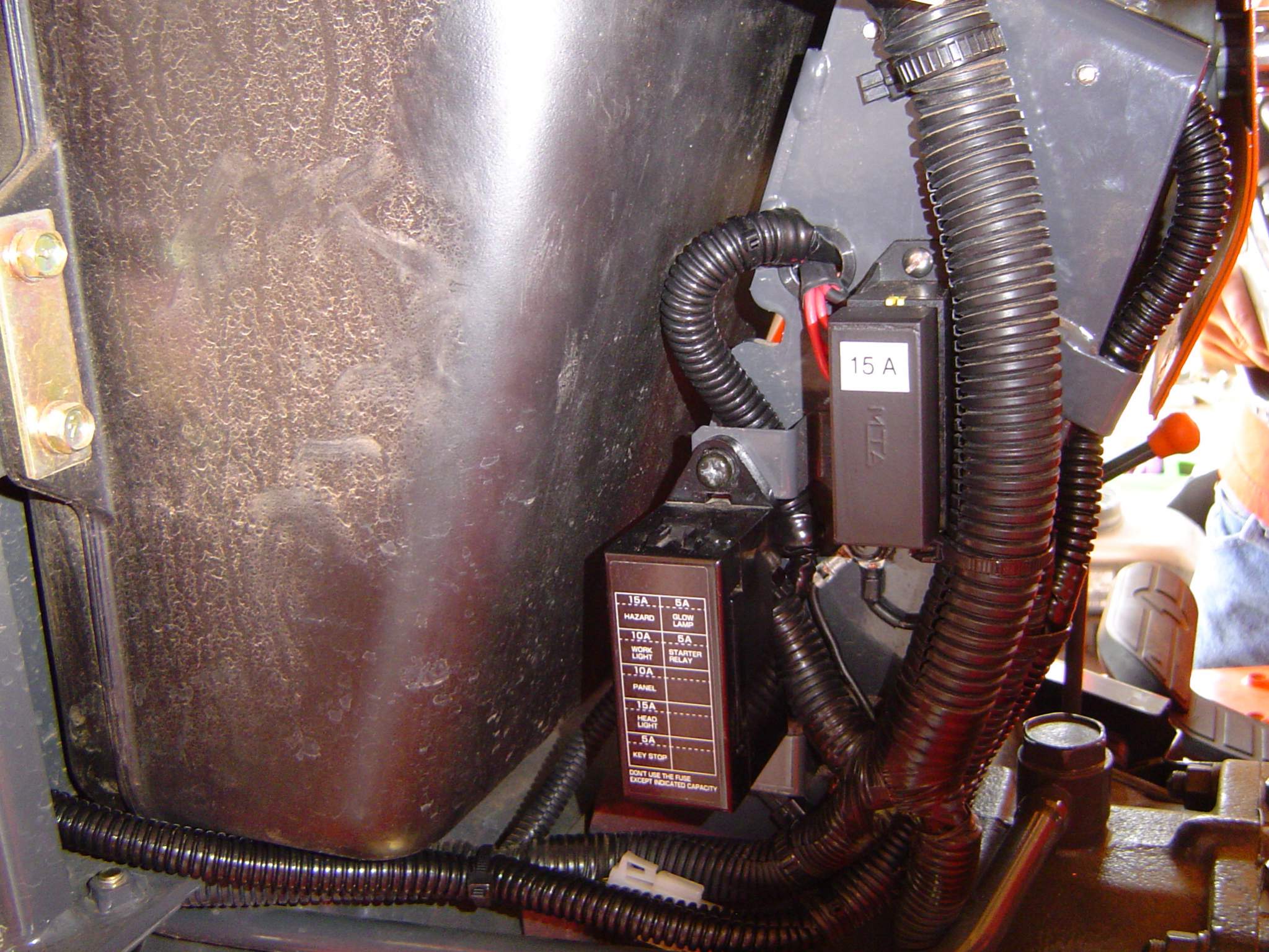

Those are the work light circuit. They go back to a 10 amp fuse at the fuse block labeled work light. The power to the work light circuit is switched through the ignition. You should be able to add two 55 watt lights on that circuit. I added six lights to mine on three seperate circuits from the battery and I used the work light circuit to power the coils on my relays. The L3400 has a 40 amp alternator so you can add quite a few lights.

/ L3400 extra light plugs ? #7

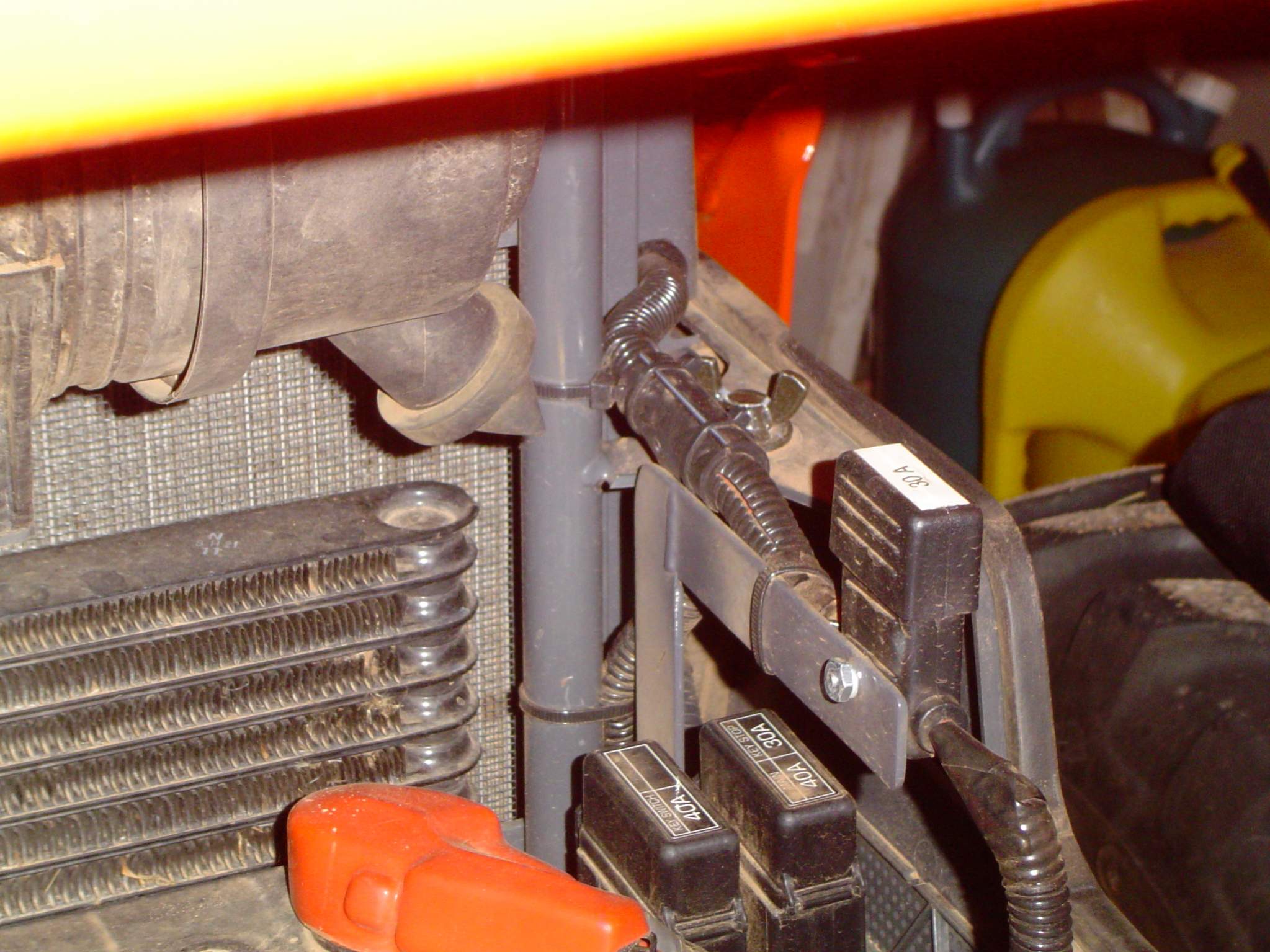

Here's how I did mine. It really depends on how many lights you wanted to add. If it were only two lights I would keep it simple and switch the existing work light circuit with a switch rated for 20 or 30 amps. More than two lights and the relays are a better option. The relays can be purchased at any auto parts store. Here are some pictures of the wiring, relays, and fuses.

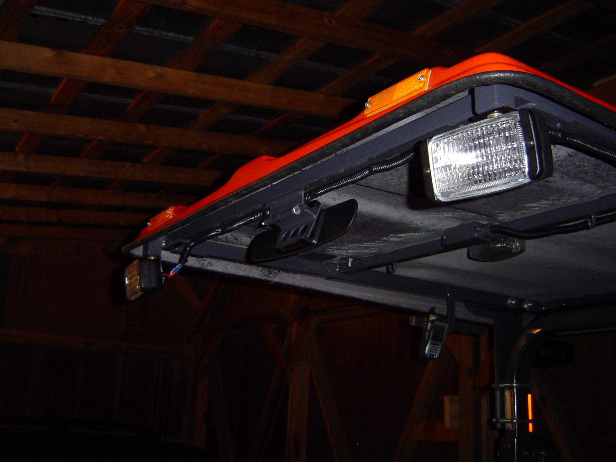

/ L3400 extra light plugs ? #8

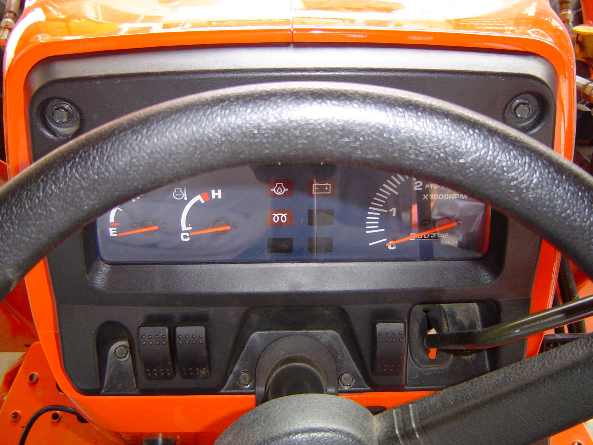

I added one 55w halogen to mine, switched with a waterproof toggle switch mounted to the left of the steering column. The yellow wire w/red flecks is the positive (hot) wire, the black is ground.
The relay will help the switch last longer, but you're better to use a switch rated for the expected current draw. 55W divided by 12 volts = 4.7 amps.

/ L3400 extra light plugs ? #9

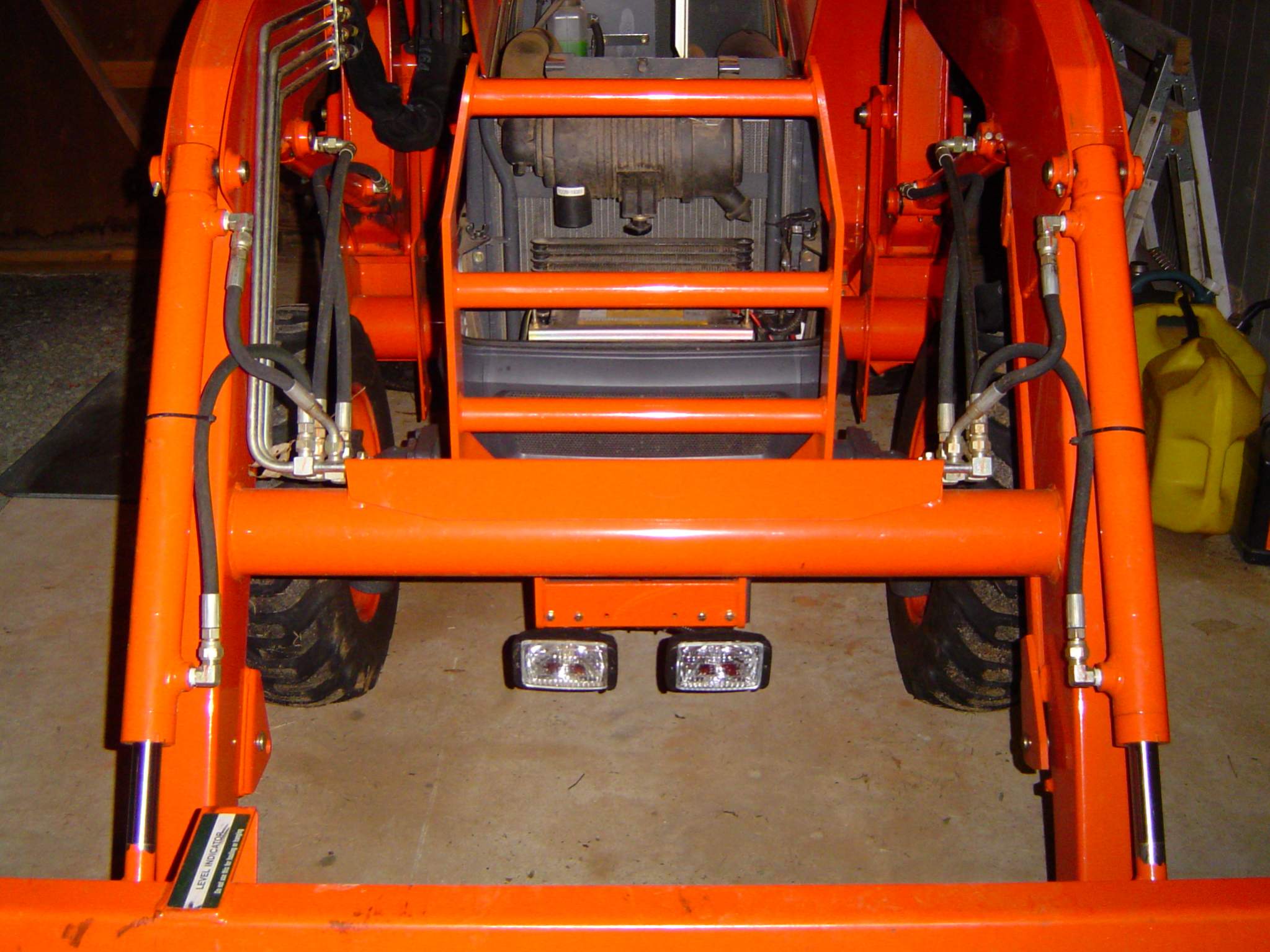

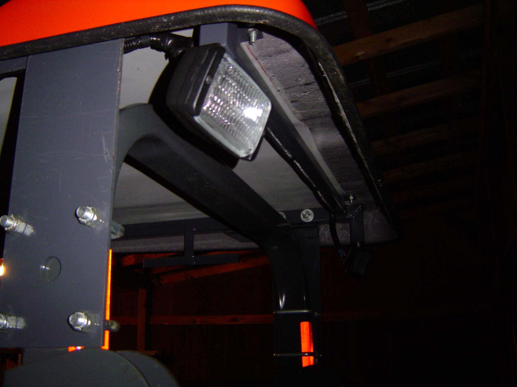

Here are some pictures of the switches and lights. I've got six 55 watt lights. Looks like an alien ship mowing at night. Actually, I usually only use four lights at a time. Two sets in front for loader work or both sets on the canopy for mowing.
Terry
