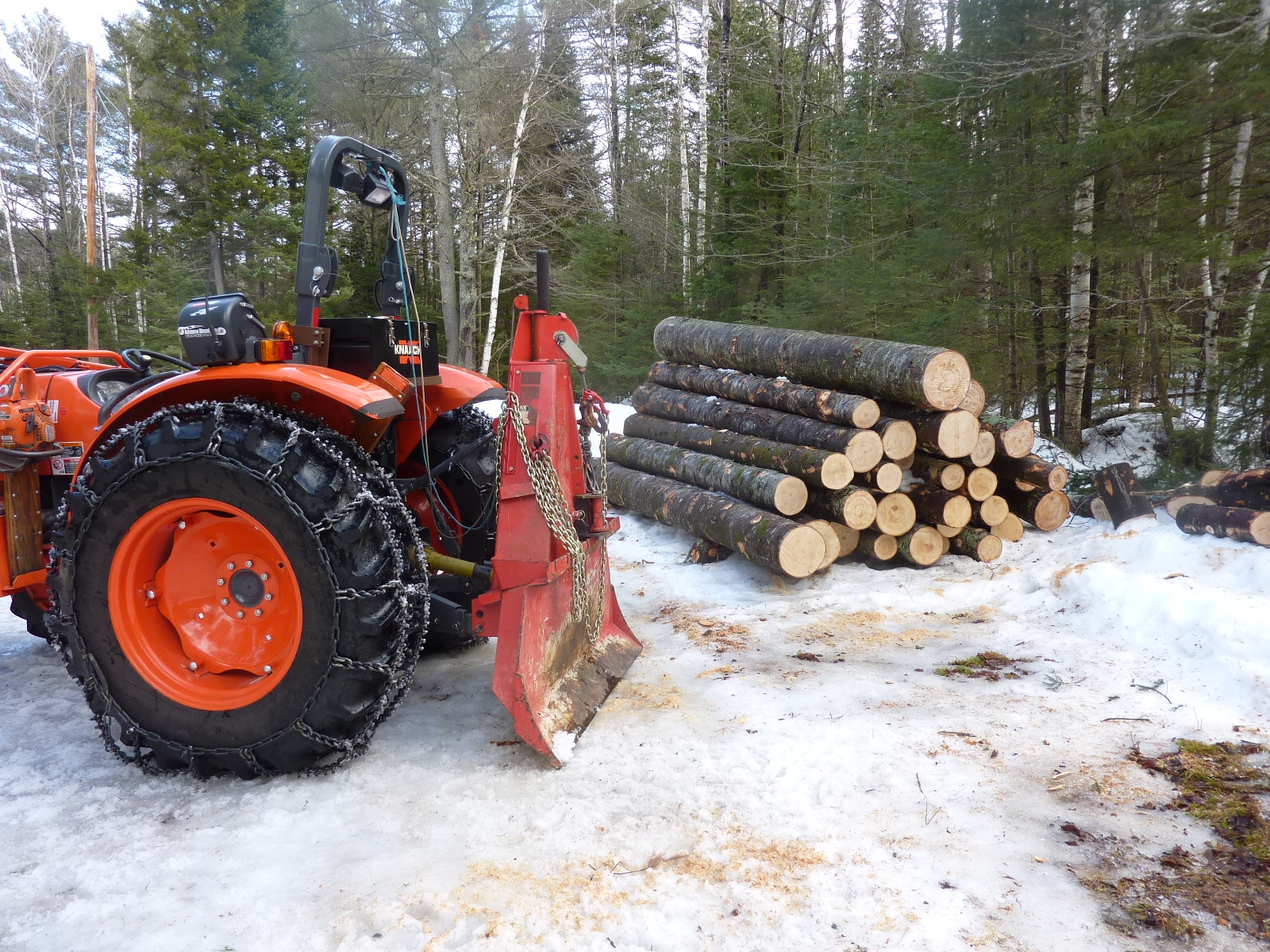

I run mine loose just like the instructions and other say. You can see the sag sometimes like in the picture. It comes and goes depending on how the chains are hanging on the R1 tire lugs. There was another fellow on here a couple years ago, OldPath, he complained that his ran off center and kept trying to tighten them. Finally when he listened and loosened them all his problems disappeared. I can see them going off center maybe for a second if you do a steering brake turn but they should return centered if they are hanging loose.
It is hard to believe that a couple bungees, especially frozen ones, can have much influence on those heavy chains when they are moving.
