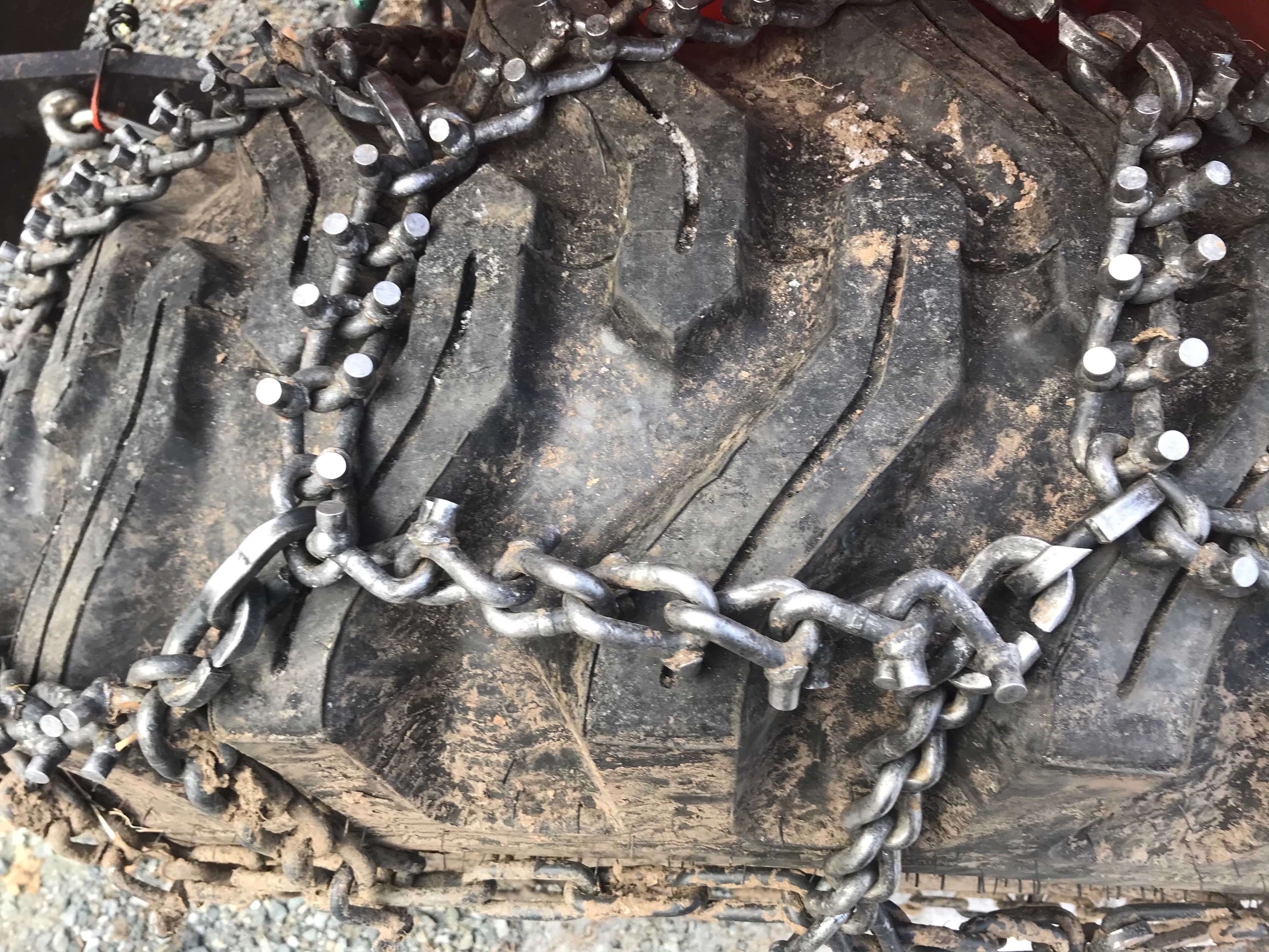

What I've done over the years as mine either stretched a bit or the tires have worn (probably both) is to use a bolt cutter to remove two links at a time in the side chains, between two cross chains. Once those are out, I replace them with a single screw type quick link. That shortens the side chain by one link.
If I ever need to lengthen the chains, it's simple to add another quick link.
I like that method of shortening ! Simple if you only need to remove less than a whole section which would be the case to take up wear with time.

This is the quick link method I've used to shorten side chains. Note the "puddle" of slack chain under the tire. These are looser than they need to be at the moment, tomorrow I'll pick up a few more quick links and tighten them a bit. They still don't try to come off the tire, even as loose as this.

A lot of people have these chains on this size tire, so today when it was sunny and warm (18) I took a look at the chains and found several issues.
The right chain had a twist where you marry up the two ends. As a result there was an extra link on that side. Several shackles on the left side were attached forward or back of where they should have been.
By untwisting the chain, moving the shackles and pulling out excess slack, I was able to remove a couple extra twist links inside and outside on both chains.
So now I the appropriate amount of slack and no bungees.

Is that a "before" picture (in post #63)? It still looks as though you've got a twist in that chain. Some of your studs are facing in to the tire. It looks as though it could be corrected by unhooking the left link, passing it up amd over and back down through the hole in the center before reconnecting.

Is that a "before" picture (in post #63)? It still looks as though you've got a twist in that chain. Some of your studs are facing in to the tire. //.
Yes.
//It looks as though it could be corrected by unhooking the left link, passing it up amd over and back down through the hole in the center before reconnecting.
The twist links go together a particular way to be fastened. Basically you put a half twist in before you connect them, then theuntwist and lay flat. Nothing difficult about it, once I had daylight.
