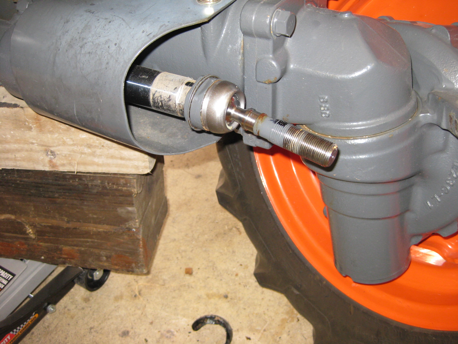

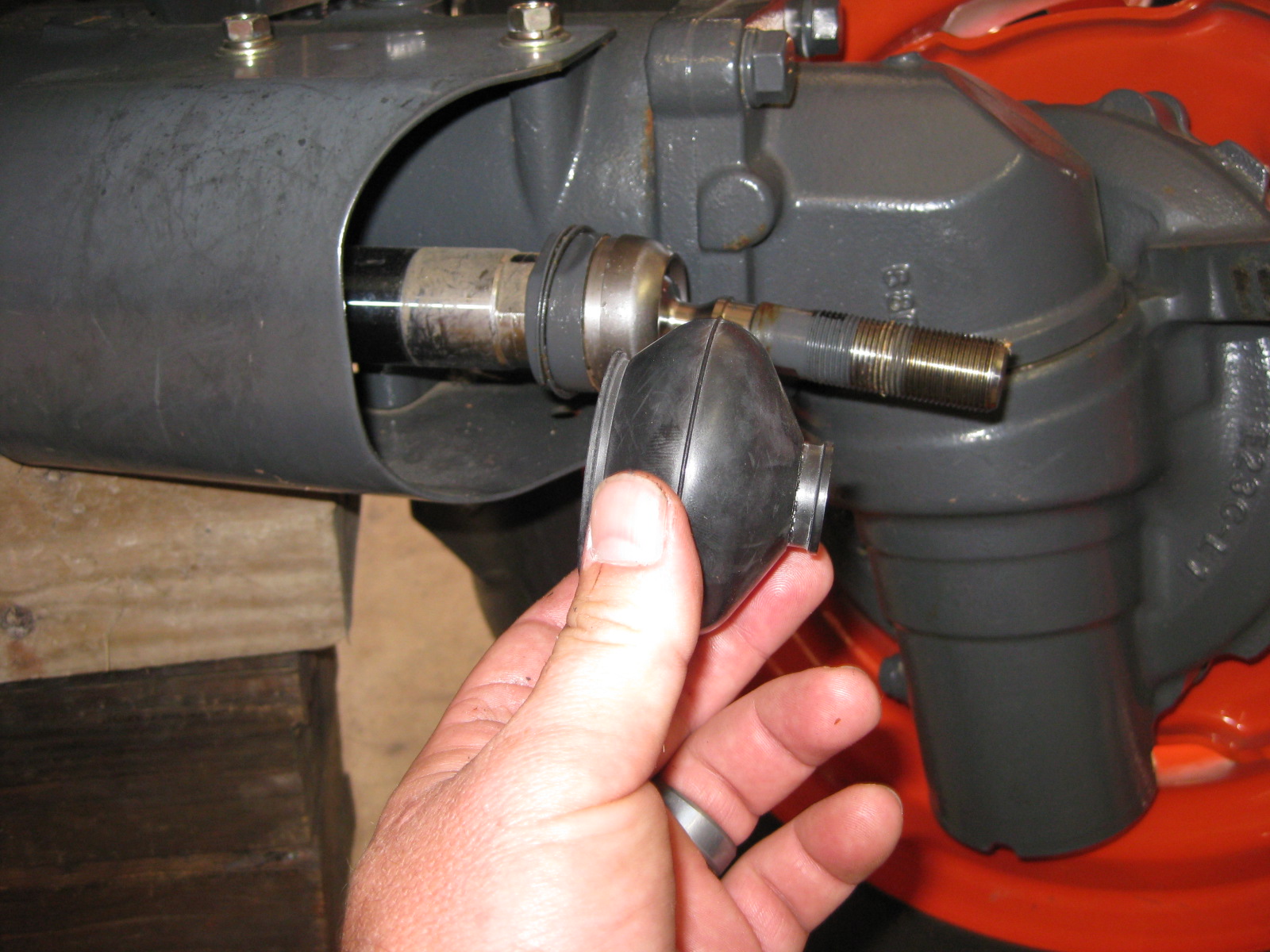

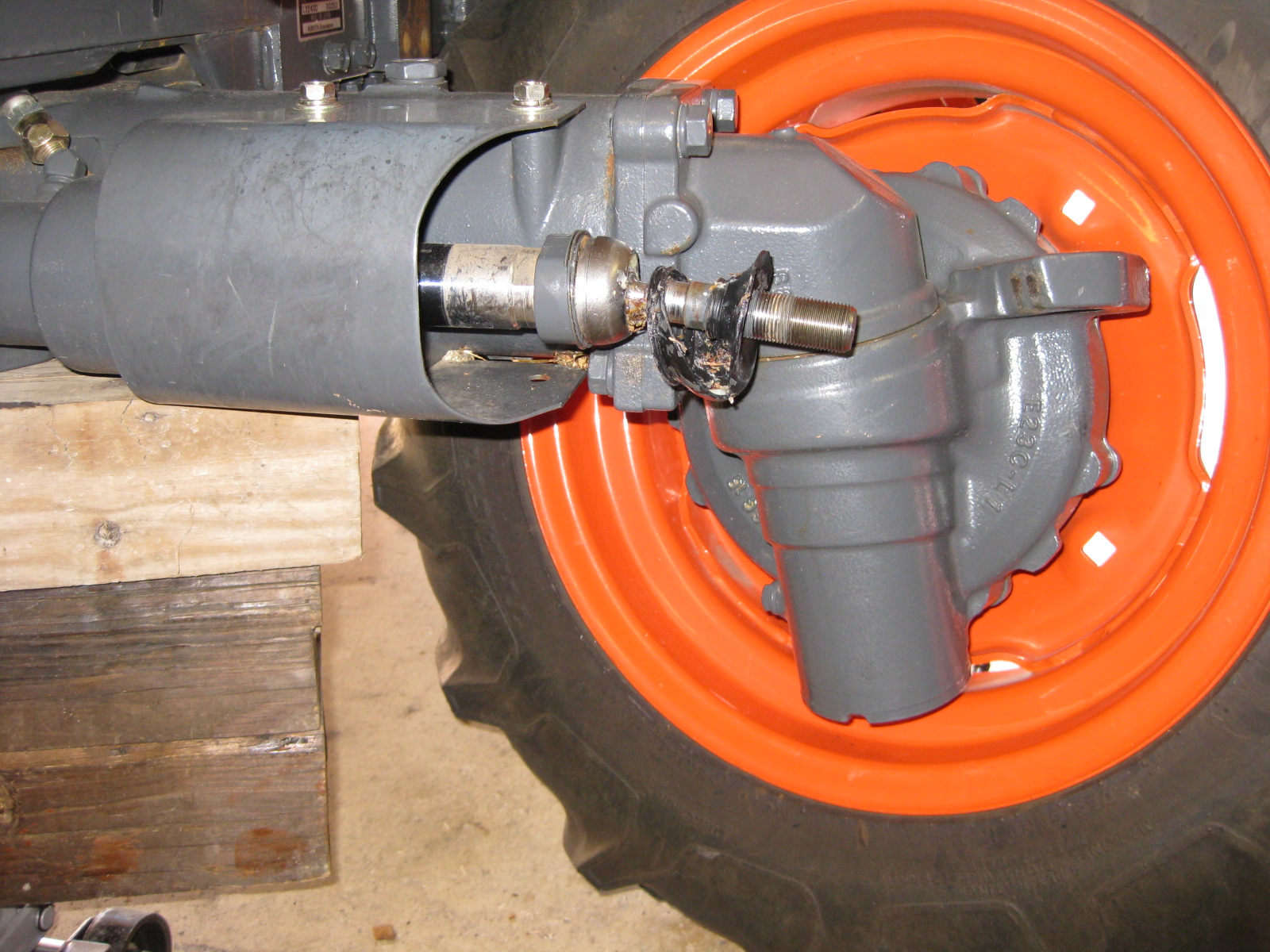

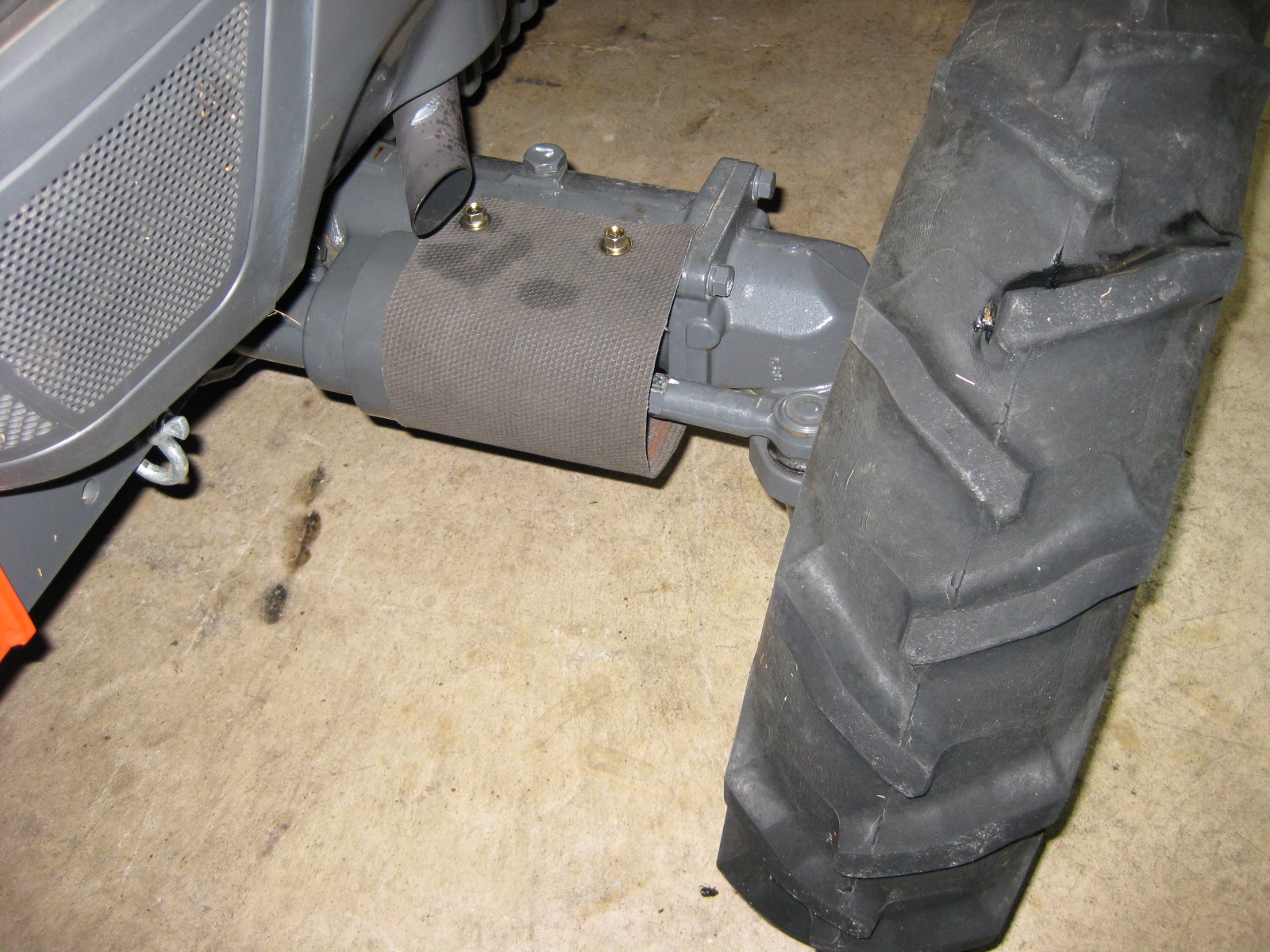

Did you use a pickle fork to take yours apart? What are the torque specs? Thanks, Larry
/ L3240 rubber boot ripped
#22
No fork needed.. I took the lower nut off and simply took a rubber hammer and two hits it came right off. Now- the tractor only has 40 hrs on it so that had a lot to do with it... The lower nut I set wrench to 80lbs and it clicked... I thought it was good and tight- that was the same place it was when it came off. With only 40 hours I don't think it would have much wear. Now the lock nut on the end of the tie rod that is adjustable I dont know I dont have open end torqure wrench:confused: But it is good and tight.. Dang thing was finger loose when I went to take it off:laughing:

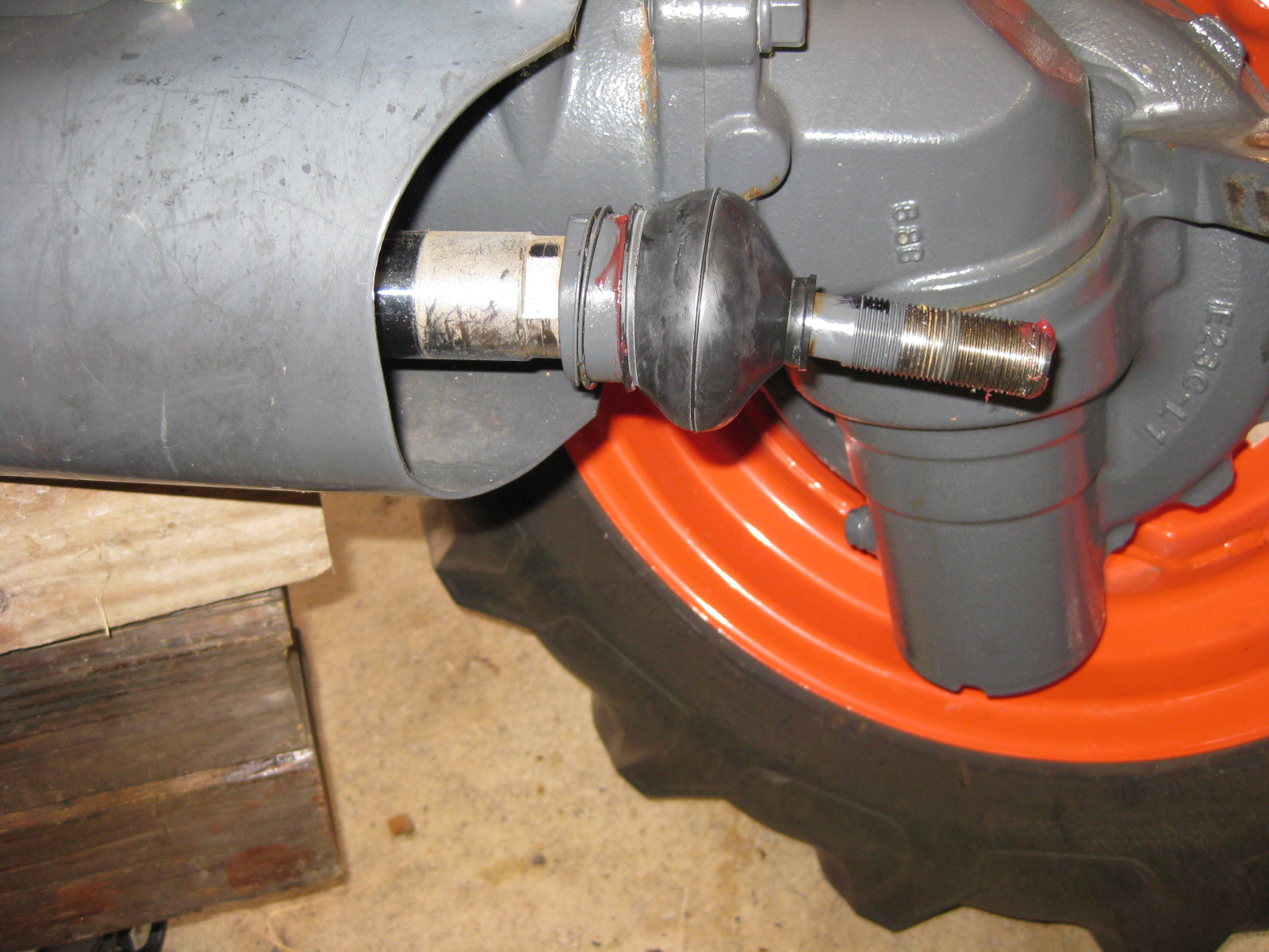

I have 2 of the rubber boots to replace the torn ones on my L4400HST. I will change them out this weekend. What kind of grease did you lube the joint with before installing the boot?
#24
I used Valvolineョ Multi-Purpose-RED I have used this type alot and like the hold up I have seen in trailer bearings...

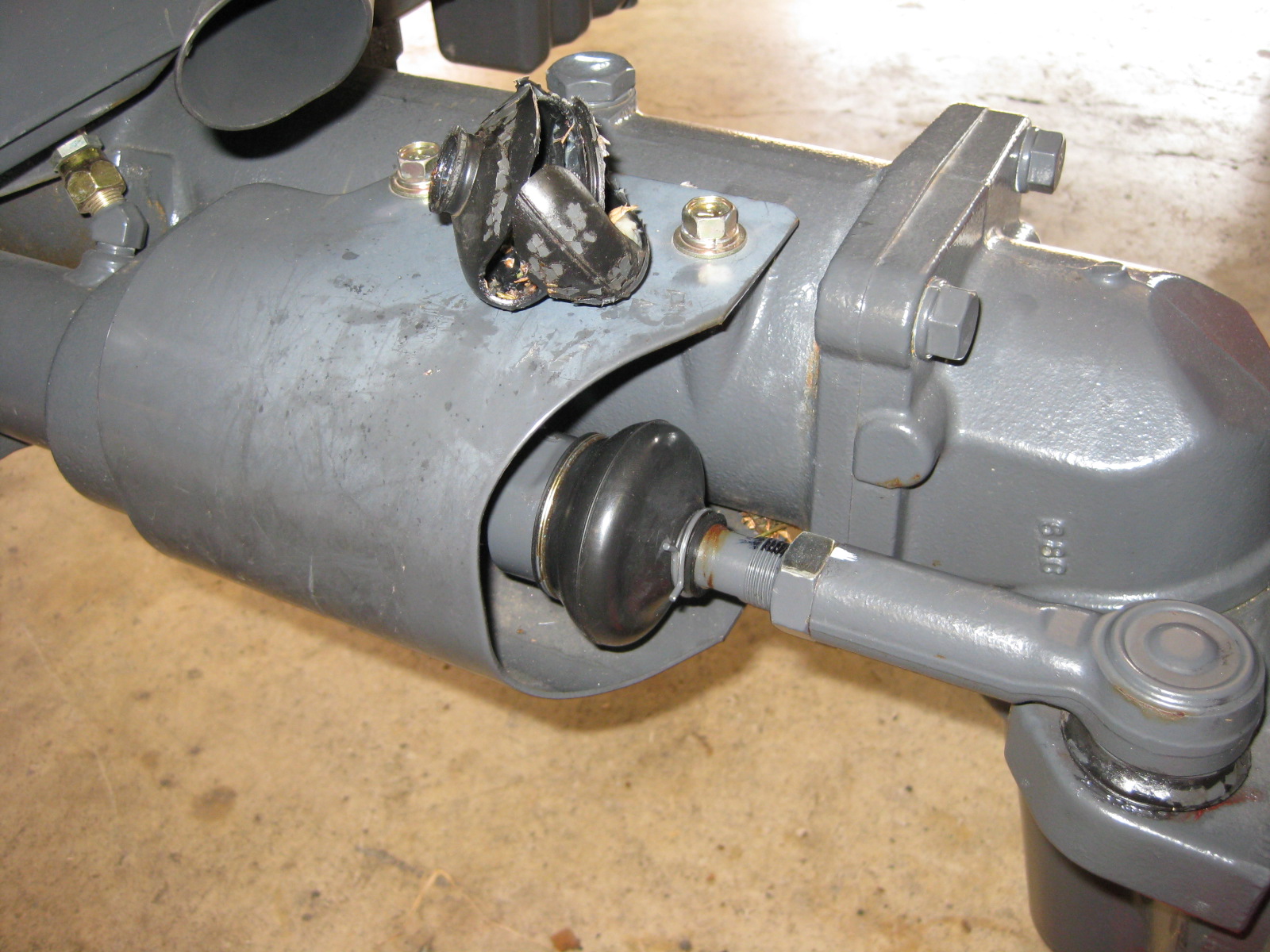

Thanks, I ripped mine rotary cutting some thick stuff. I have some thick belting and will implement the great idea previously posted.

Me too! I will post some pics after I get my guard finished also...
AndyG
#27

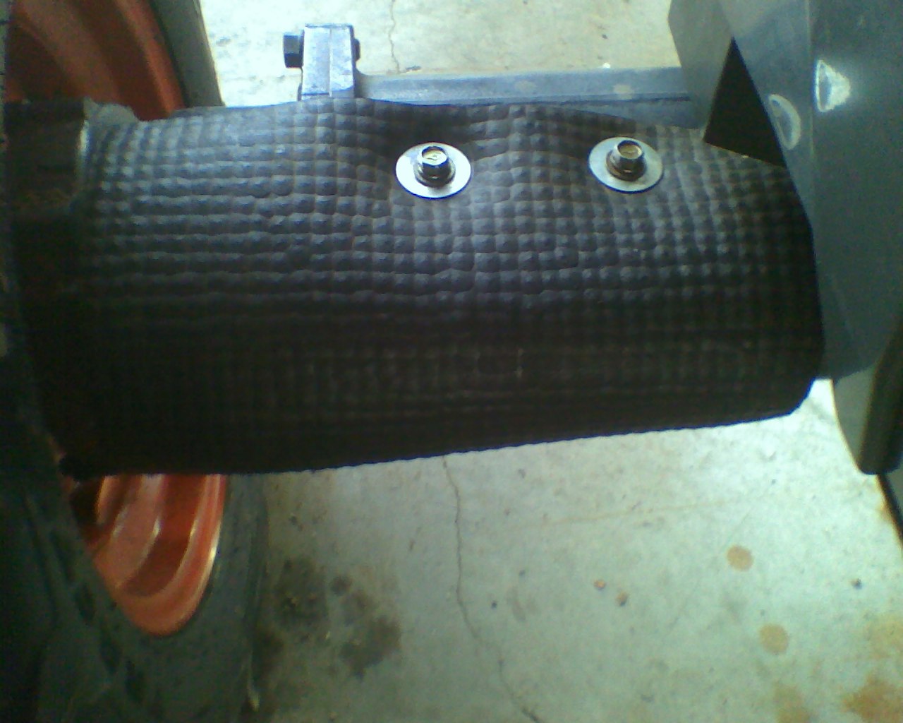

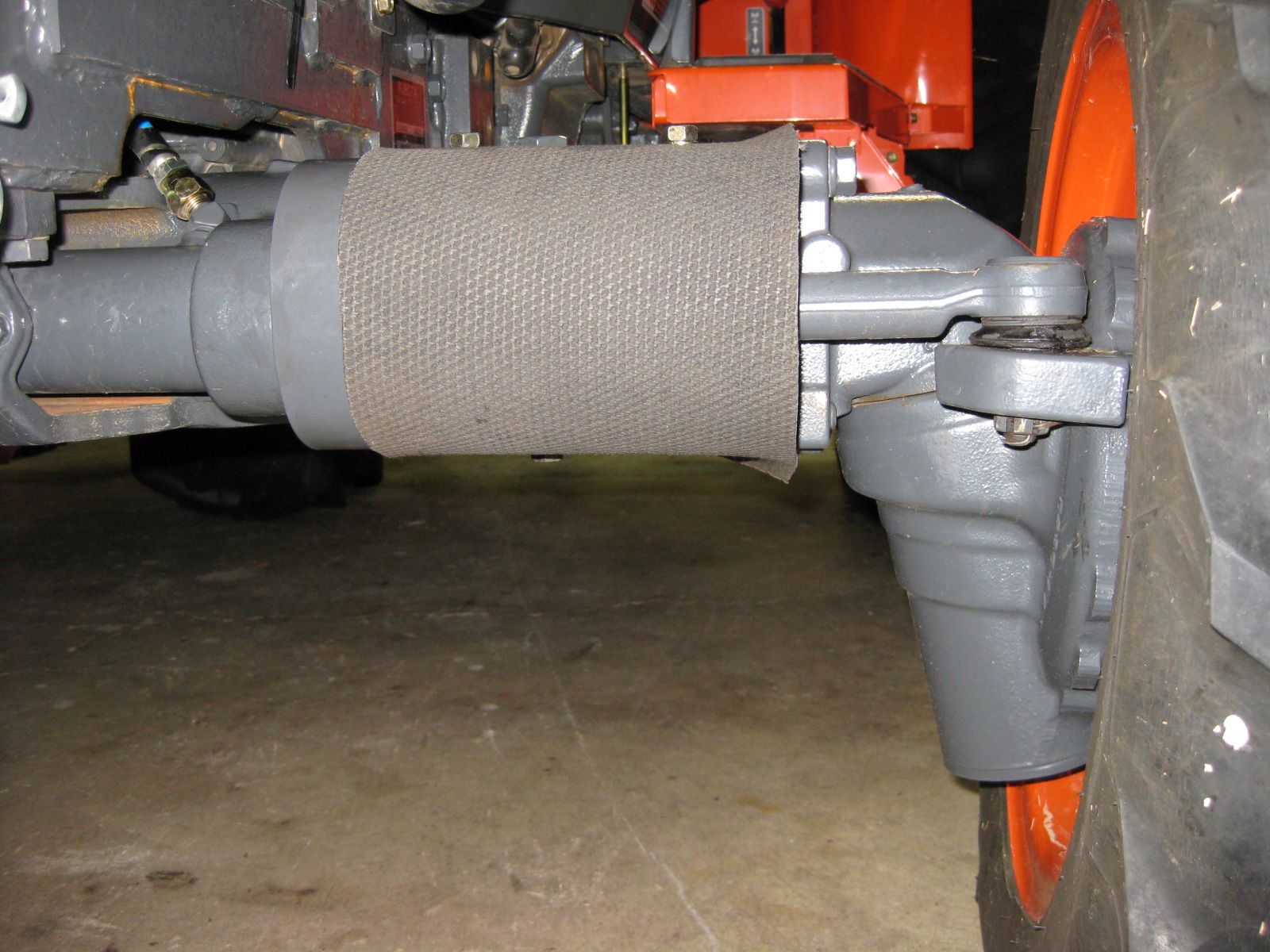

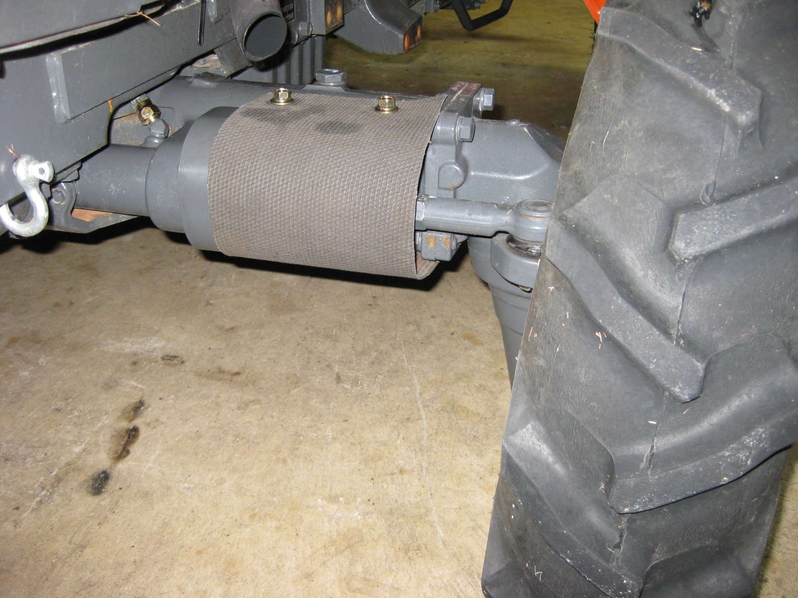

Here is the guard I made tonight.. I will do a little trimming on the cover so it fits a little better. I used the factory bolts and holes. The converyor belt works good.. I will post the final product tomorrow night.. With pictures of the tires turned both ways. Wife said NO to cranking up the tractor at midnight.....:(

Nice work - looks like OEM.
Based on my own experience, it probably should be OEM.
-Jim

Hey Andy...That looks really good! I have messed around with conveyor belt material myself...but did not think to use it as guard material. My mind was stuck on mud flap material. Did you melt the ends to keep them from unraveling?
#31
No-- but that is a good idea to keep them from coming apart..Never thought of that.. thanks... Also i finished both of them and posted on L3240 Fix!! as all the final pics..

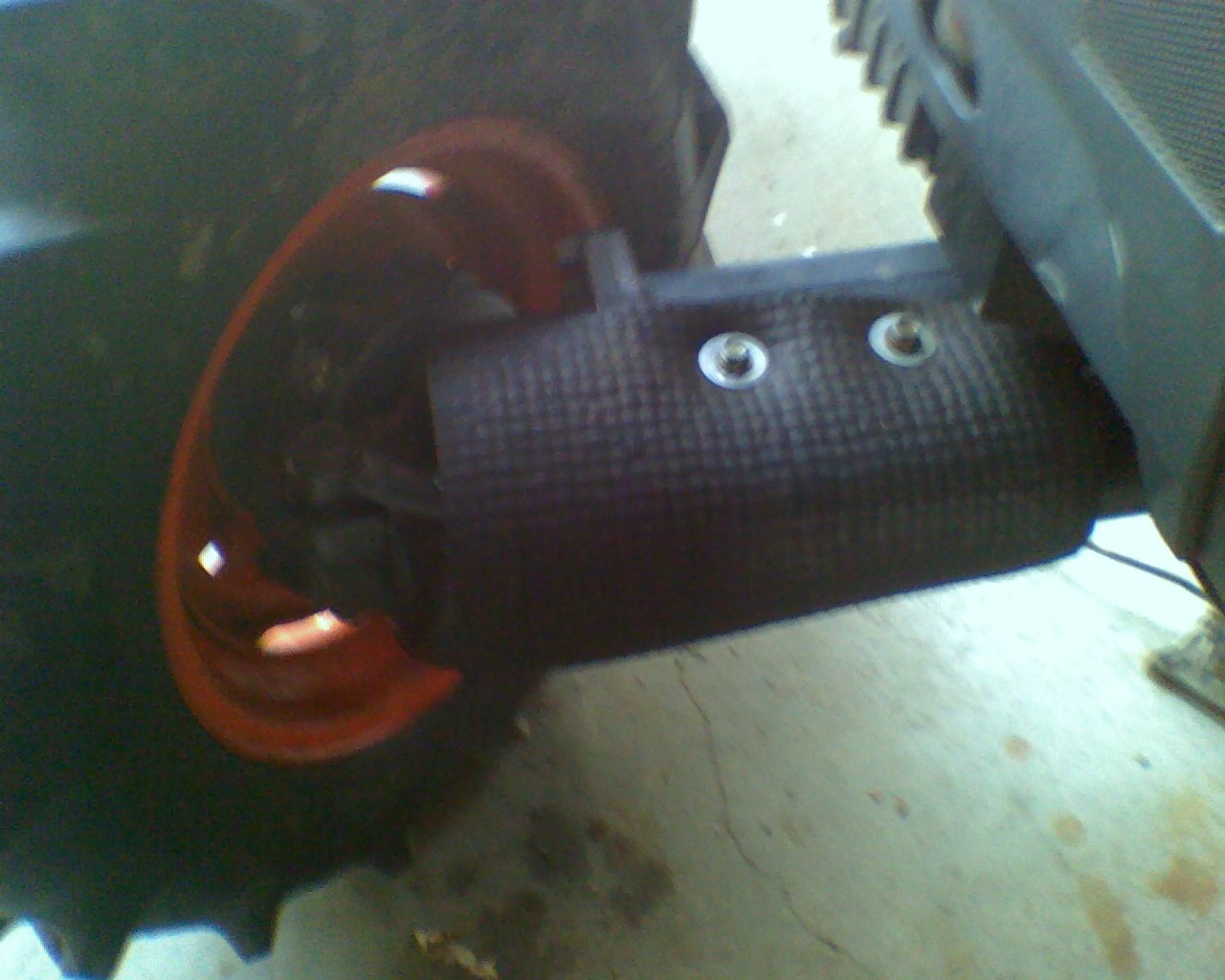

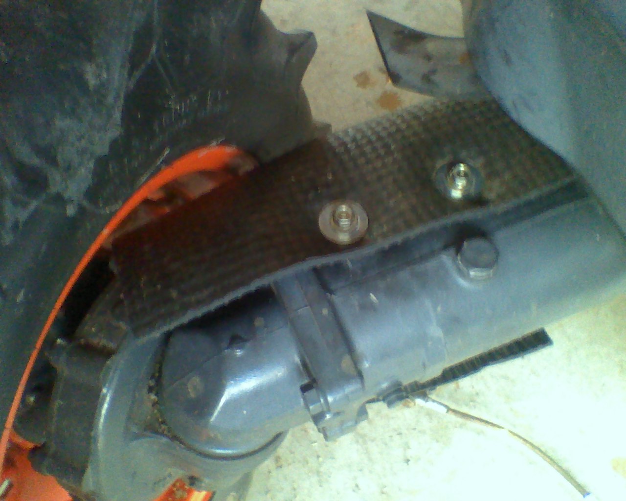

I used some heavy (5/16ths?) bedliner material that we got at TSC to go in the bottom of the dumpbox. It worked well and while it is probably softer than conveyer belting, it is heavy enough for the little bit of bushhogging that we do.
Pictures attached:
RH/LH Straight:
RH Full Extension, LH Full Retraction:
