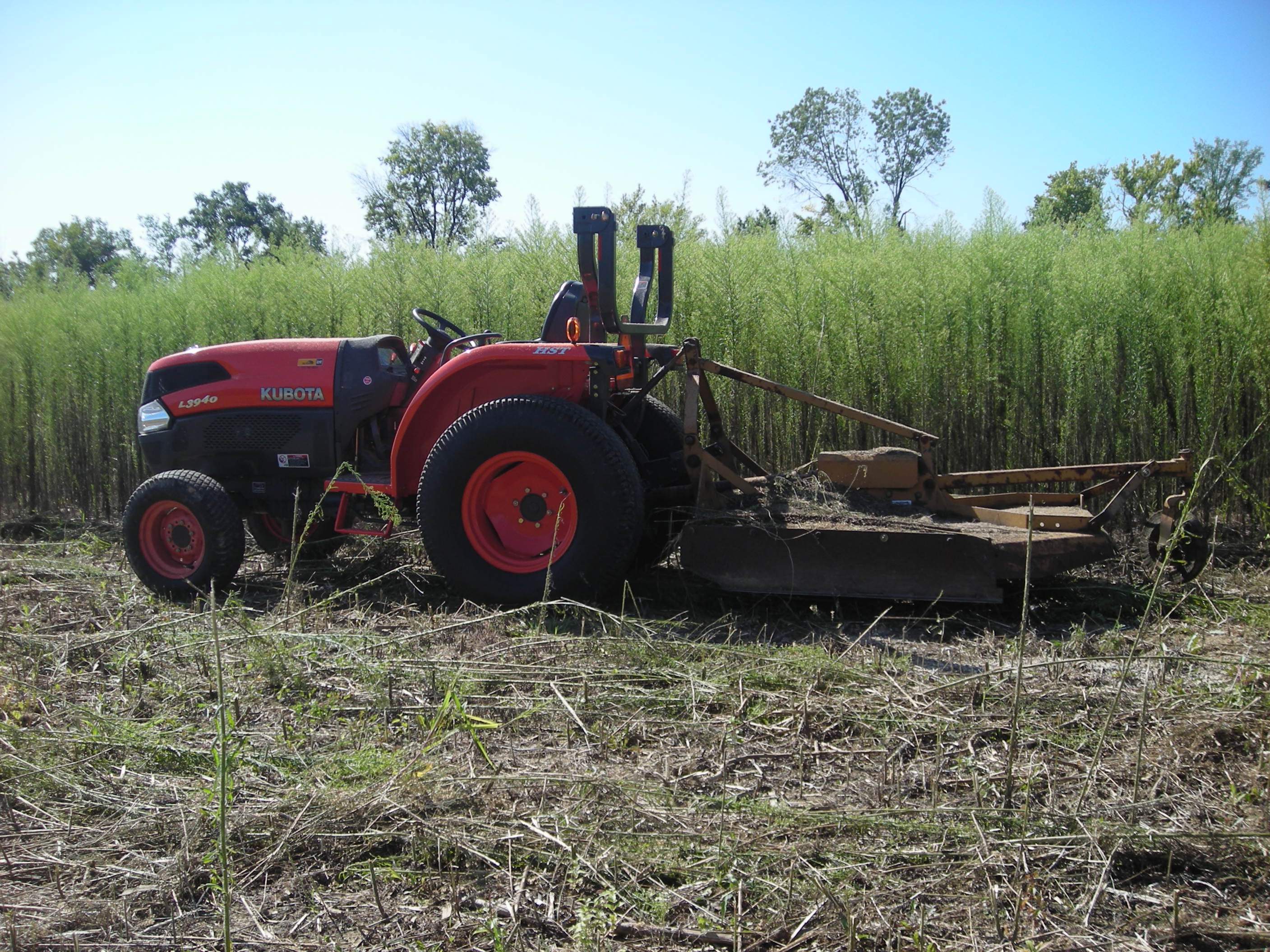

I run an old Ford 6' hog on my L3940 without front ballast, is a little light on the front, but it handles just fine. Philip.
