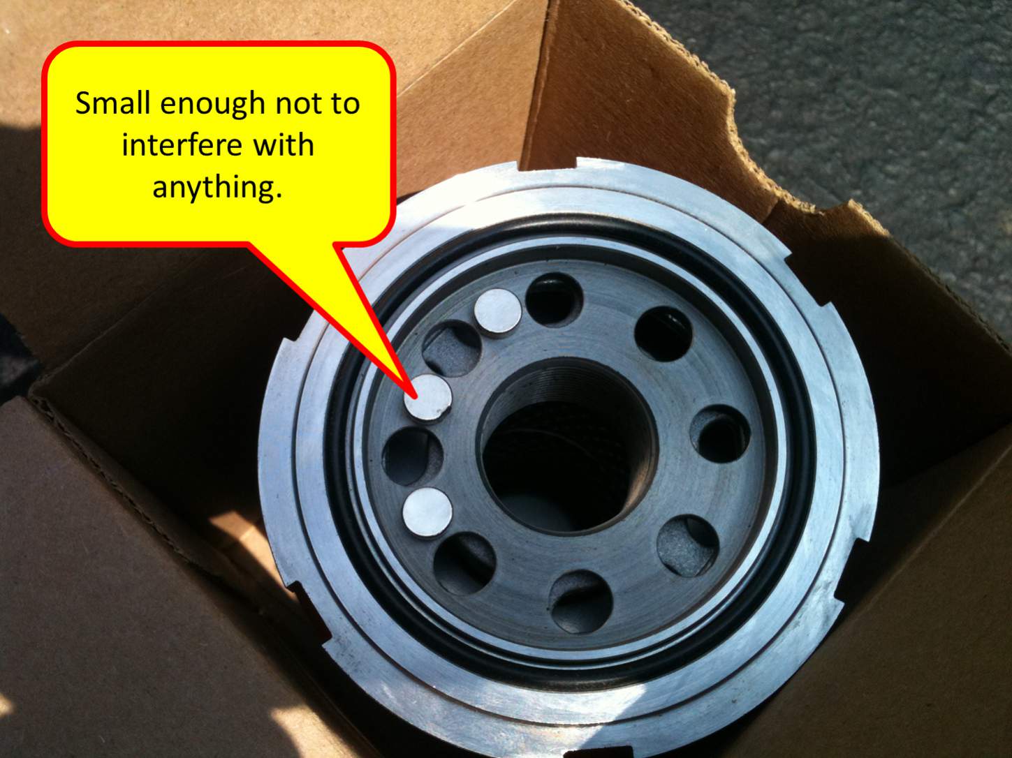

Just did the 400 hour service on my L3240 and have a little issue with my hydraulic filter. I crossed the OEM filter (HHTAO-37710) over to a NAPA gold 7098. Upon removal of the old filter, I noticed a magnet, so I cleaned it and put it in the new filter. The new filter is leaking because the magnet is too thick for the NAPA filter and isn't letting the O-ring ger enough "crush". Looking for opinions:
1. Go get a Kubota filter.
2. Take the magnet out and drive on.
2. Measure the difference in filters and surface grind the magnet to fit the NAPA filter.
Thanks

orangeandgreen,
I've used several small rare earth (neodymium) magnets in place of the stock Kubota magnet. They are much stronger and take up less space. I thought I had pictures to describe, but couldn't find them. Along those lines here is a link showing how the same type of magnets were used on the drain plug http://www.tractorbynet.com/forums/owning-operating/295384-kubota-b3300suhsd-maintenance-post3524969.html#post3524969
If you're interested in this possible solution, I'll look for the pictures... Just let me know. Found the picture.

I think you well see that is a hyd filter not a trans filter.
