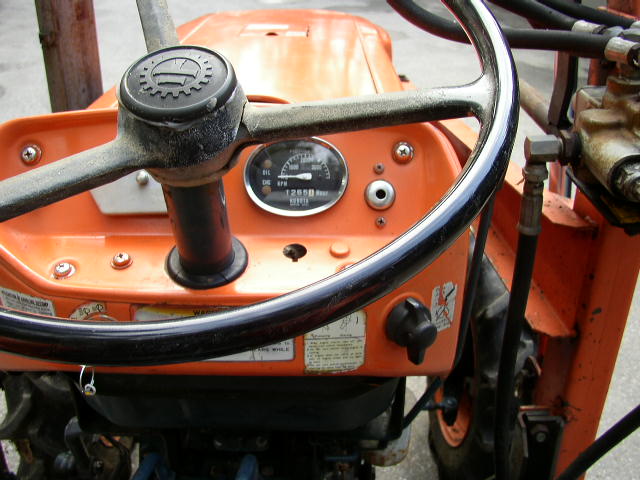

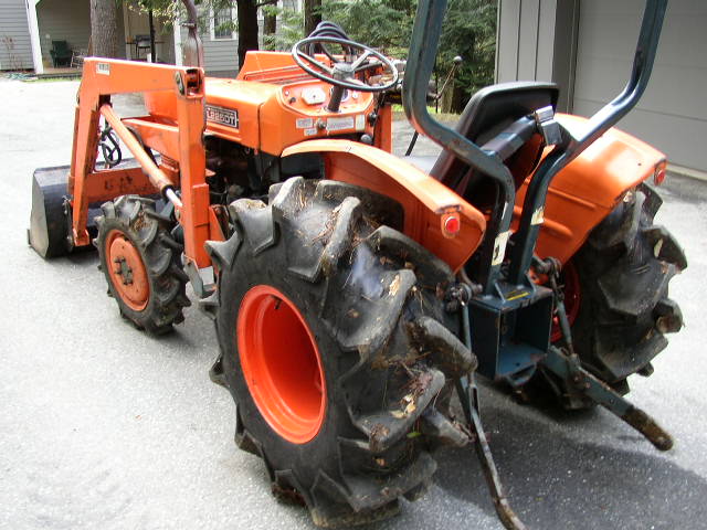

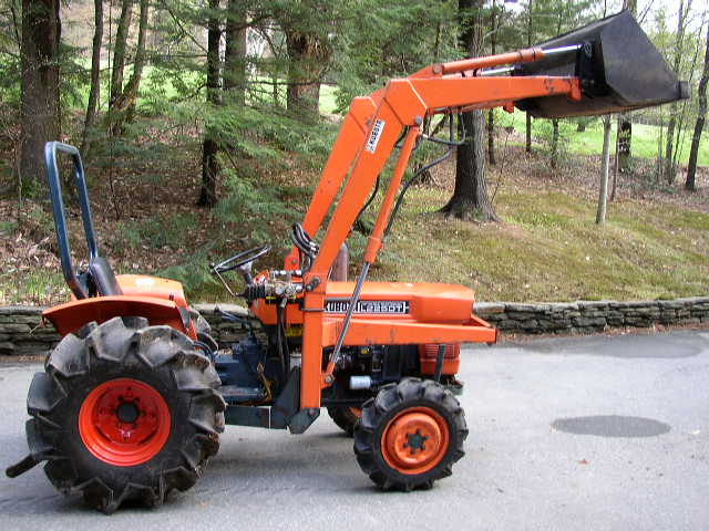

Here are some pictures showing the condition and a .pdf with data for the L275DT from Tractor data.
  • L275_Data.pdf
