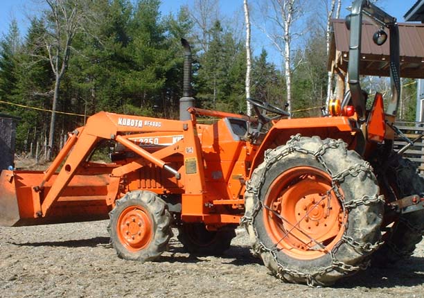

Good Luck Dave and let us know how it turns out. Be sure to post some pics if you get the tractor. Attached is a pic of my L2250.
Dave
