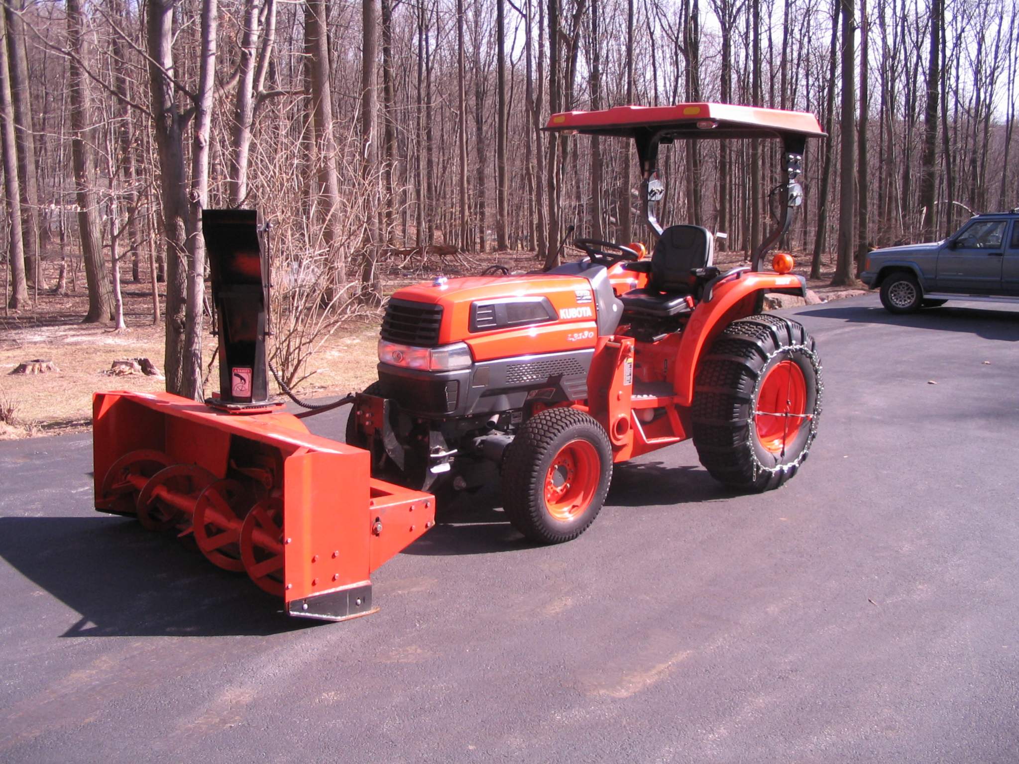

I just wanted to update everyone who offered advice and assistance on installing a used L2185 72 snow blower on a L3130HST tractor.
In a word the blower is awesome! After going in reverse for many years it is really nice snow blowing moving forward. The hydraulic chute rotation and electric chute deflector seemed like overkill at first, but they are really nice to have. Pushing the control lever left past the detent to rotate the chute still seems odd, but I知 getting use to it.
The shortened fixed drive shaft (off a L4330) seems to be running smoothly and doesn稚 have any unusual dynamics. Hopefully it will stay this way.

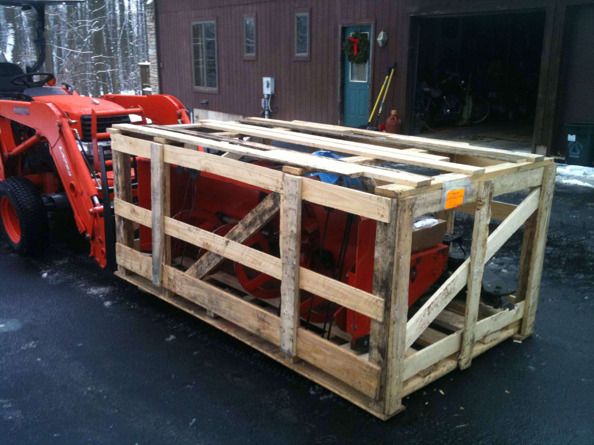

The snow blower arrived in a middle of a snow/ice storm package in a crate measuring 4 x 8 and about 4' in height. Getting it off the truck was a bit tricky since it could not be turned to get it on the lift gate. We had to lower it long ways by balancing it between the tractor and truck lift gate. Thank goodness for the forks I bought two days earlier! Hats off to the Kubota dealer who verified everything worked prior to crating and doing a fantastic job labeling all the bolts and putting them in separate zip-lock bags. Every part was accounted for down to the smallest cotter pin.

This past Monday was the first snow fall (6-8? since getting everything installed.. After 2.5 hours of use I知 very pleased with it and very glad I went with the larger blower. The local dealer said the 72 would not work and recommended the smaller unit. After getting feedback from other forum members with similar setups and doing other research, I was very comfortable going with the larger unit despite the dealer痴 opinion.
If anyone else with a L3x30 is considering the bigger L2185 versus L2174A, I say go for it. If you are looking for used do not shy away from blowers off the larger L4x30 tractors. Everything is the same except for the mid fixed driveshaft. This is the shaft from the mid PTO to the sub frame. One can be purchased from Kubota for $255 or it can be shortened if you have the equipment. [fixed driveshaft assembly is $255 while the shaft alone can be purchased for $150 if you want to disassemble the u-joints]

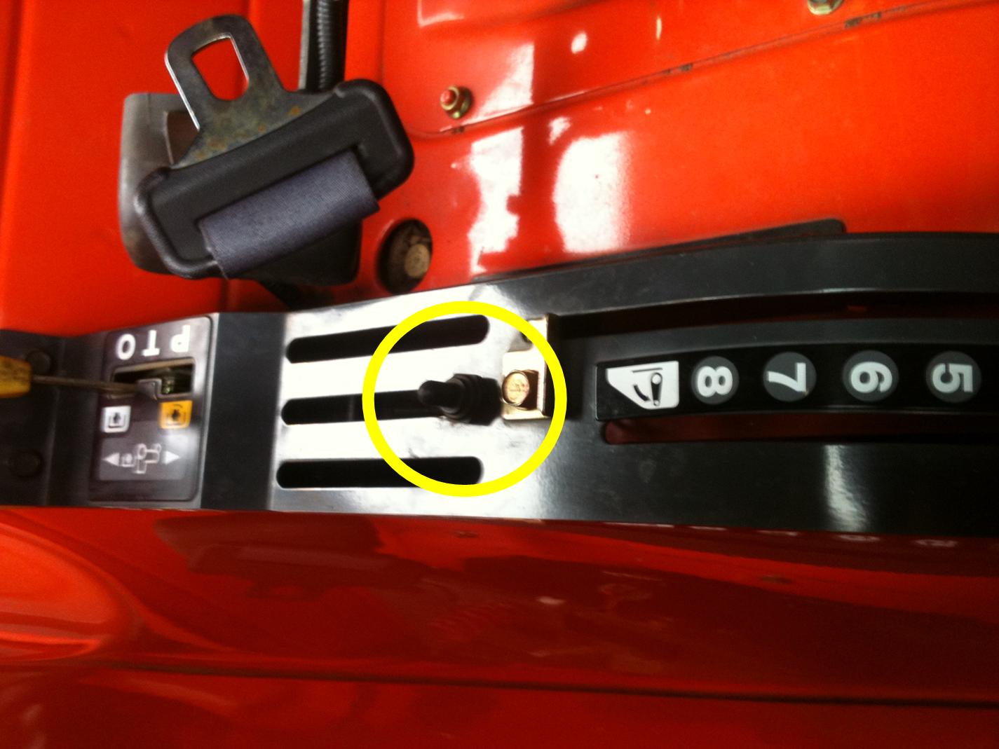

In the event someone uses this thread for future reference...
The chute deflection switch was mounted in the PTO panel to the right of the seat. An available slot was used to mount the switch. Reference attached photo.

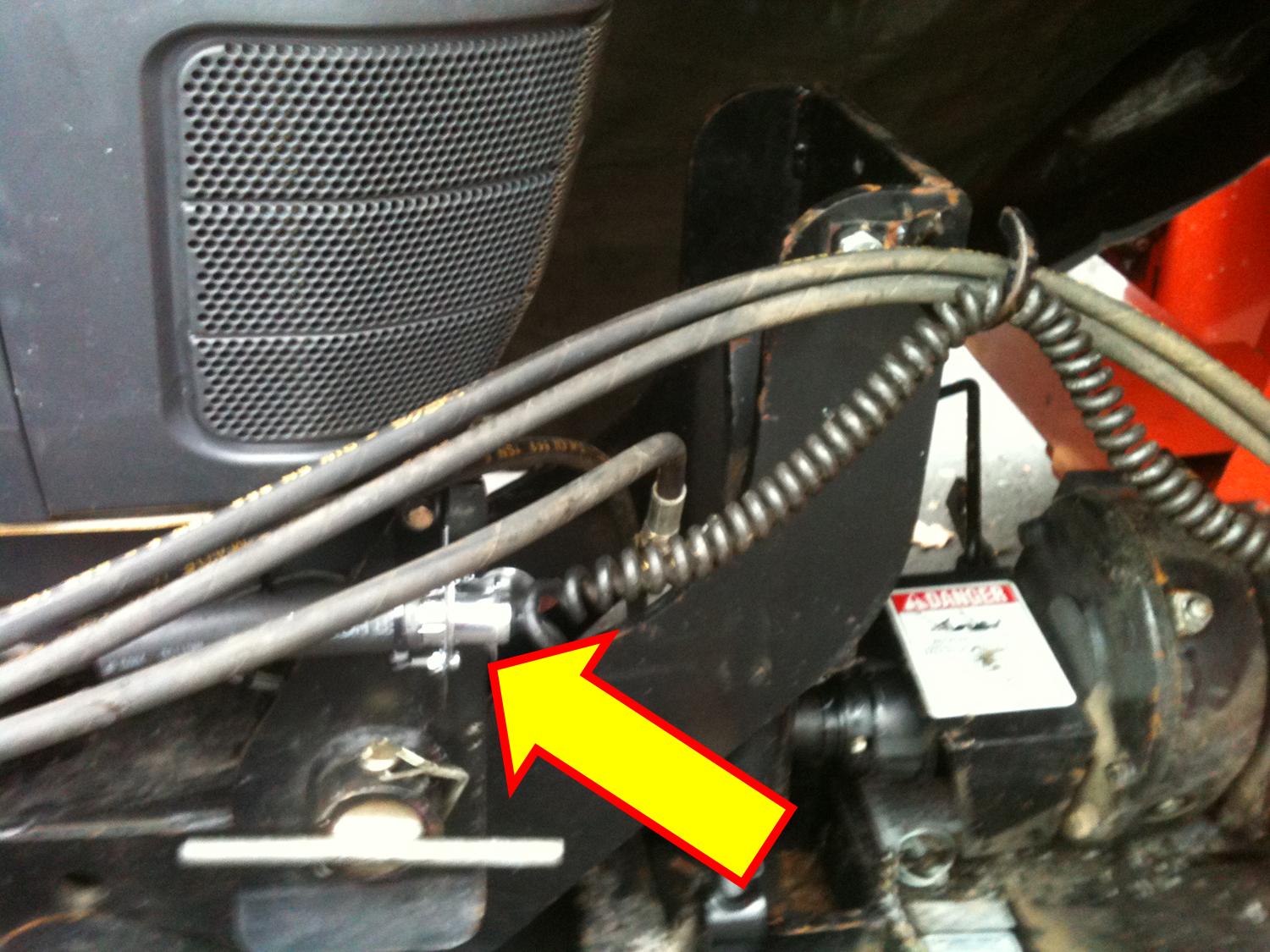

On the front of the tractor a 4 pin metal trailer connector was used along with a coiled wire to the chute deflector motor. The Quick Hitch part that stays on the tractor is drilled and tapped to accept the bracket for the metal wire connector. Reference Photo below.
