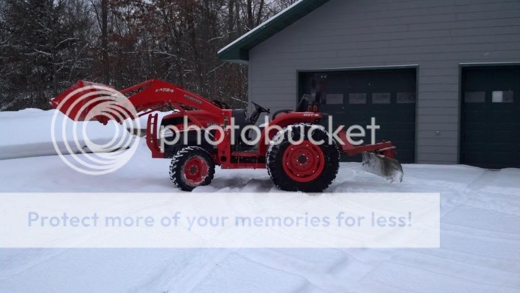

I have a 2010 L 3400 4x4 gear drive with 292 hours, best tractor I have ever had.
Good looking tractor. Any more pics that you could post?
