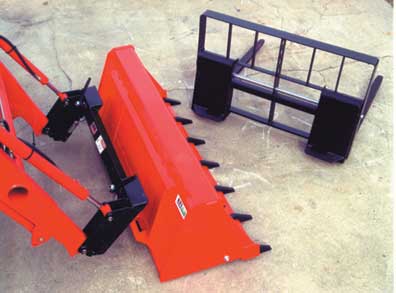

I'm trying to gather info to help my dad with a new tractor purchase. He has recently priced the L3400 and L4400 (loader, 4wd, gear tranny). As far as guiding him on options, though, there is really one major issue that I'm still not understanding: QA Loaders.
For the L-series, talk me thru exactly what the QA feature is and how it's beneficial. Is it the entire loader assembly or just the bucket that is "quickly" attached/detached? Are a std version AND a QA version available thru Kubota? If so, what is the rough cost of the upgrade?

The QA system is installed with pins to the loader in place of the bucket, the QA style bucket (or grapple, rockrake, etc.) is then attached with the QA system.
I'll let other posters answer your other questions.
The second picture is from ATI " Tach-All " ATI Corporation - Tach-All(tm) Quick Attach

So it is the bucket that is quickly attached/detached, not the actual arms, etc.? Not all QA loaders/buckets are skid-steer compatible, though, correct?

The loaders are quick detach as well. The skid steer quick detach is a bucket option(shown in previous post). By the way get the SSQD option it is worth it.

Think of it as 2 seperate systems. The loader arms on all new Kubota tractors quickly attaches/detaches. The buckets also are available with the Skid Steer Quick attach option. This allows you to remove and attach the bucket it 30 seconds or so. It also allows you to use skid steer buckets, forks bale spear etc. If you add hydraulics up front you can use some additional attchments such as grapples.
Definitely add it. Cheap option now. Not really a down side but lots of up side. Especially expensive if you decide to add it later.
