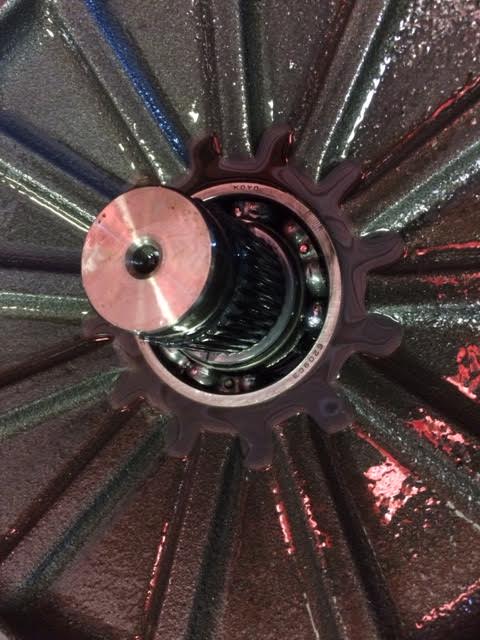

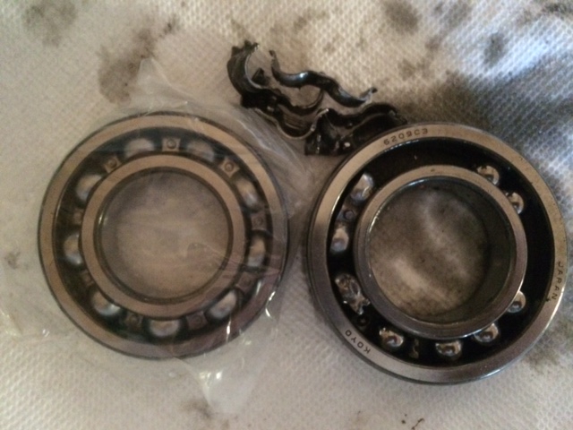

Hen I finished plowing snow today I oil dripping from the bottom of the LH front axle. Oil collected at the bottom cap but noticed most of the oil was on the inside of the rim. That can only come from a leaking axle seal. Tractor is a L5740hstc-3 with 630 hours. Replacement looks pretty straight forward except removing the inner bearing in order to slide off the gear for access to the outer bearing and seal calls for a special puller due to the limited clearance between the gear and the bearing. I have multiple 2 and 3 jaw pullers plus multiple crow foot bars that might do the job. Has anyone replaced an L series front axle seal? Is it as easy as it looks or am I going to do a lot of swearing. Heated garage so that part of the battle is okay. I tried going a search but any way I tried searching ended up with a minimum of 4,000 posts, most over 10,000 posts.
/ L front axle leak
I did my L4400 this spring. Not too bad. Replace the O ring around the case too while you are in there. Here's the thread. http://www.tractorbynet.com/forums/kubota-owning-operating/318552-l4400-front-axle-leaking-grrrrr.html
Thanks! Just what I was looking for. Interesting to find that my response was immediately after the picture of your bearing failure telling how I had changed to 75W-90 synthetic in my axle. I have given my tractor quite a workout for the small tractor it is. Lots of load and carry and before I got my M135GX, rounded up big round bales on this end of our farm, a lot more load and carry. I still think it should have handled it but likely my bearing was one of those outliers with a material flaw that sent it on its way. Thank goodness for a heated garage to work in.

I started this thread, seep due to a failed bearing, play noticeable when I raised the front end with the loader and wiggled the wheel in every direction. Cost was $90 for 2 bearings, seal, and large o-ring sealing the case halls. Standard sockets, couple small pry bars to pull the inside bearing off. One of the simplest jobs a person can do. I wouldn't have needed the inner bearing but safety first as it was running misaligned when the outer bearing failed.
