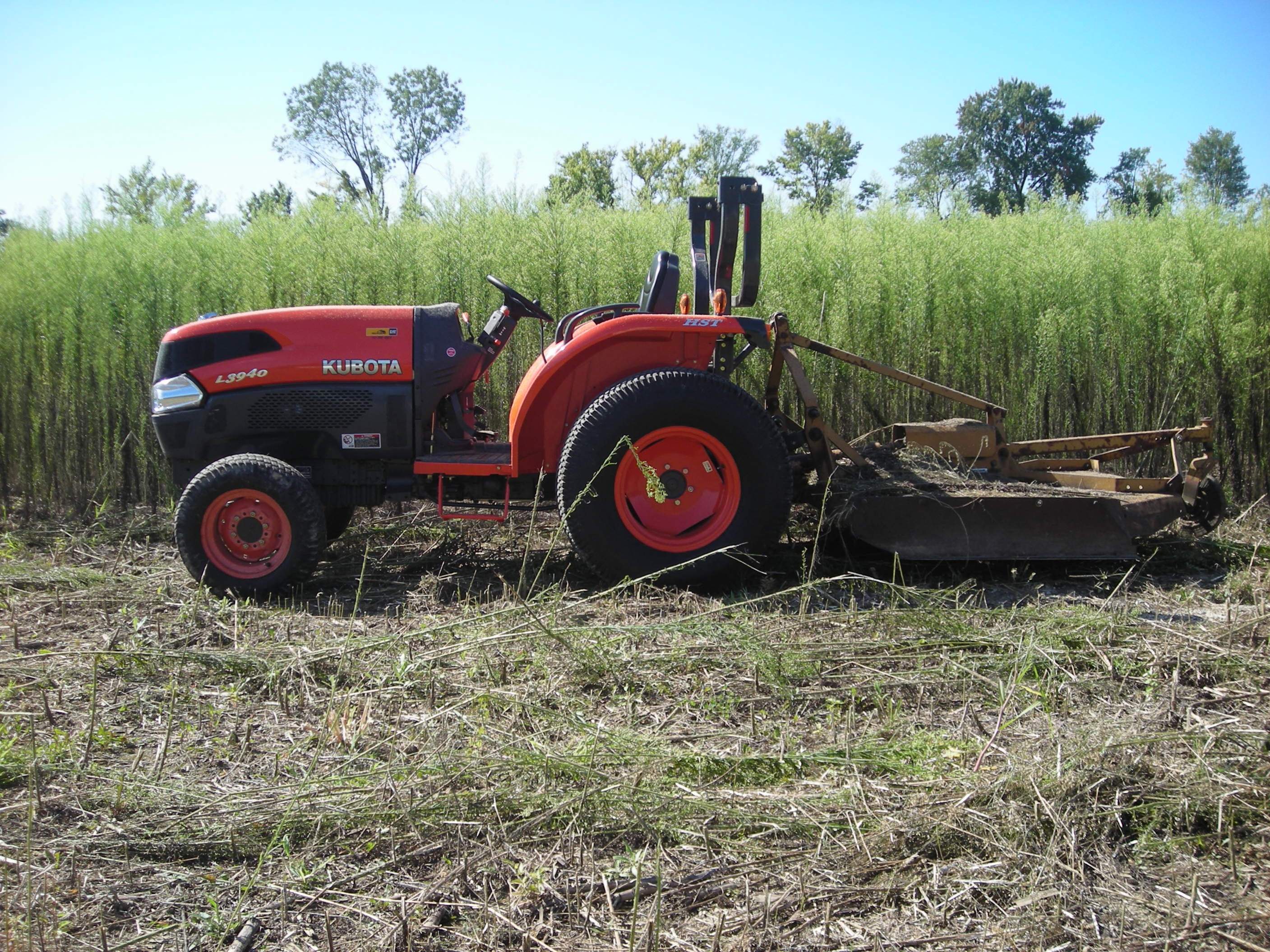

We recomend a 6ft cutter on any L40 Kubota's. Its no problem at all.
I do not agree with that statement. I pulled a 6' cutter behind my L3940 in this and found the limits of the pto hp. Had to go slooow thru the thickest areas. Philip.

okay... yes, if your cutting grass as high as your ROPS as in that picture... you're gonna need all the power you can get! For most applications, 25 pto hp is fine... older tractors used a lot less.
