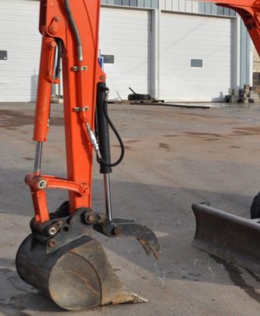

Assuming a cylinder is operating to its full system ability, but is weak, in general, you can go up a size in cylinder diameter, or move the thumb cylinder pin farther from the hinge pin. But the second option would change the thumb swing arc some.
Does yours look like this?
Bruce
