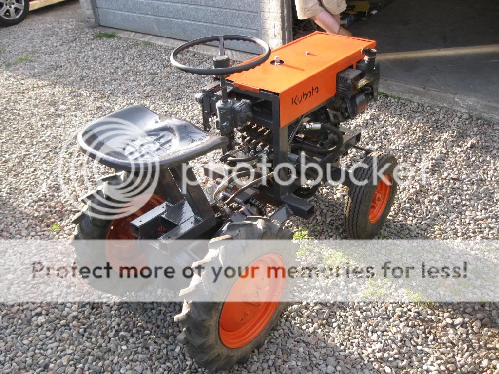

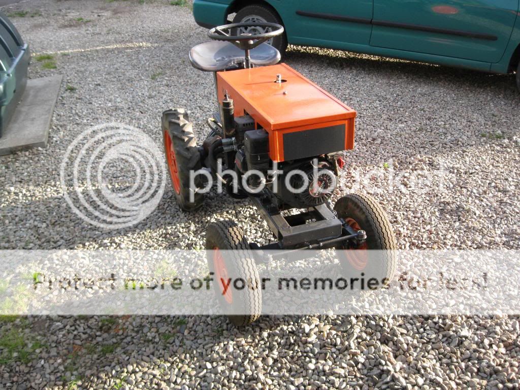

And a couple of bad pics of the tractor as it stands (with pedal control) more to come!

#65
As promised, here is the pictures of the finished article; Complete with three point linkage, oil filter and now a handle AND foot control for direction.
