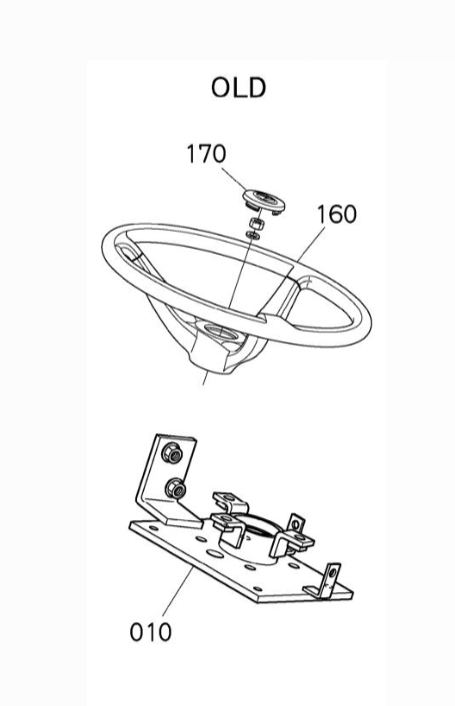

First thing I would do when I take my tractor apart is to get a parts diagram so I can see how it was put together. Messicks has a very good parts diagram for a lot of the tractors.
You didn't mention which model so I pulled up a random one which shows you have to remove the center plug, the nut and a washer before the steering wheel will come off.
Messicks search

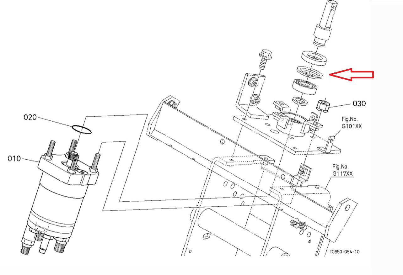

You are correct. I should have approached it that way. I removed a nut and a lock washer. But I did not fish out a large washer under that which may have been hiding a C clip? I found 2 diagrams there, one marked Old looks like my 2018 and has no Clip. But the other newer (?) model has a clip but no nut? I'll go back in and have another look. If it has a C clip I will return sheepishly and report. Thank you

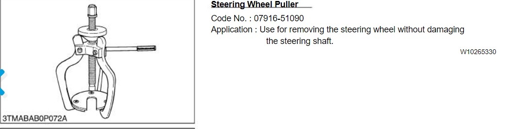

Kubota made a steering wheel puller, part no.07916-51090, but it has been discontinued. Saw a price for it as slightly over $1k. Probably did not sell many of them at that price.​
/ Kubota Steering wheel removal help needed. #18
Doesn't look like it should be $250 / pound:)
