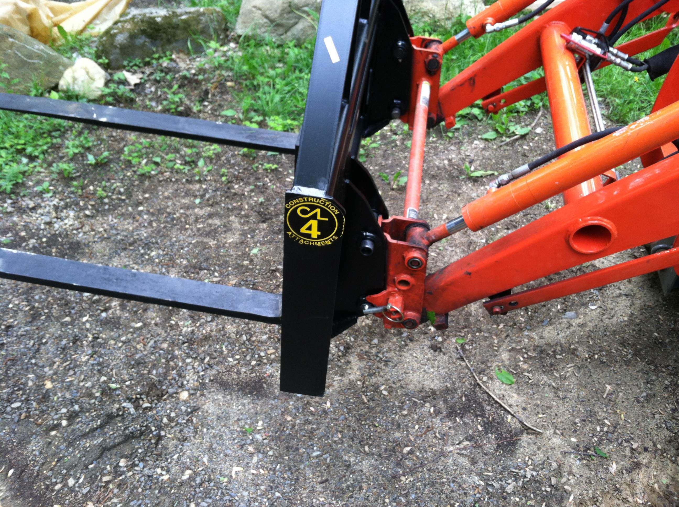

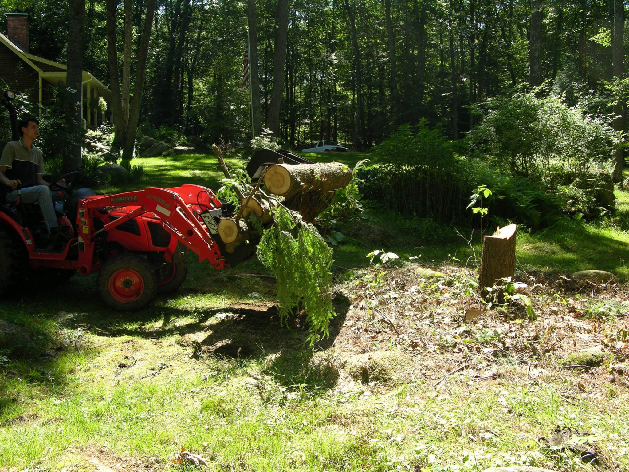

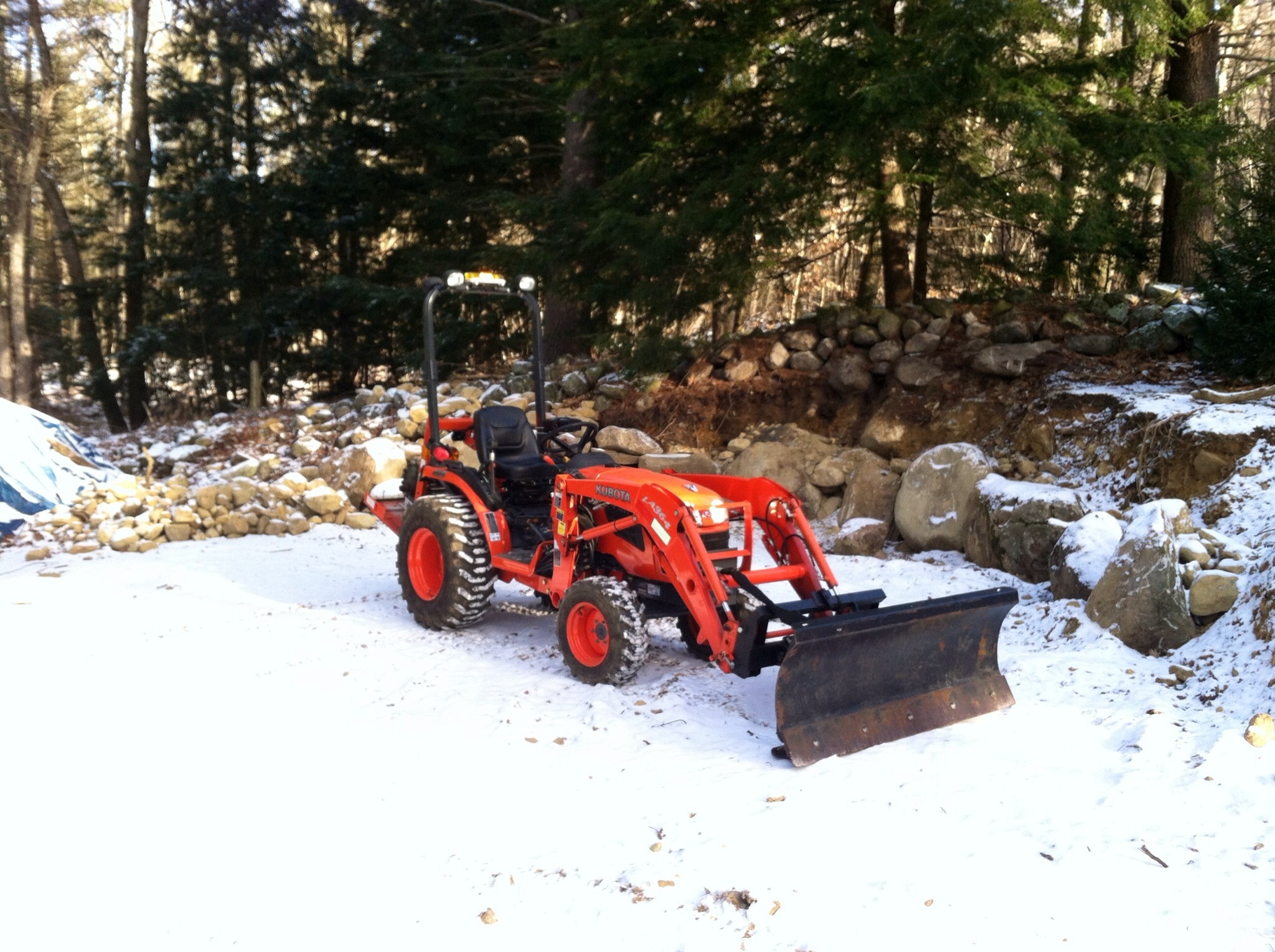

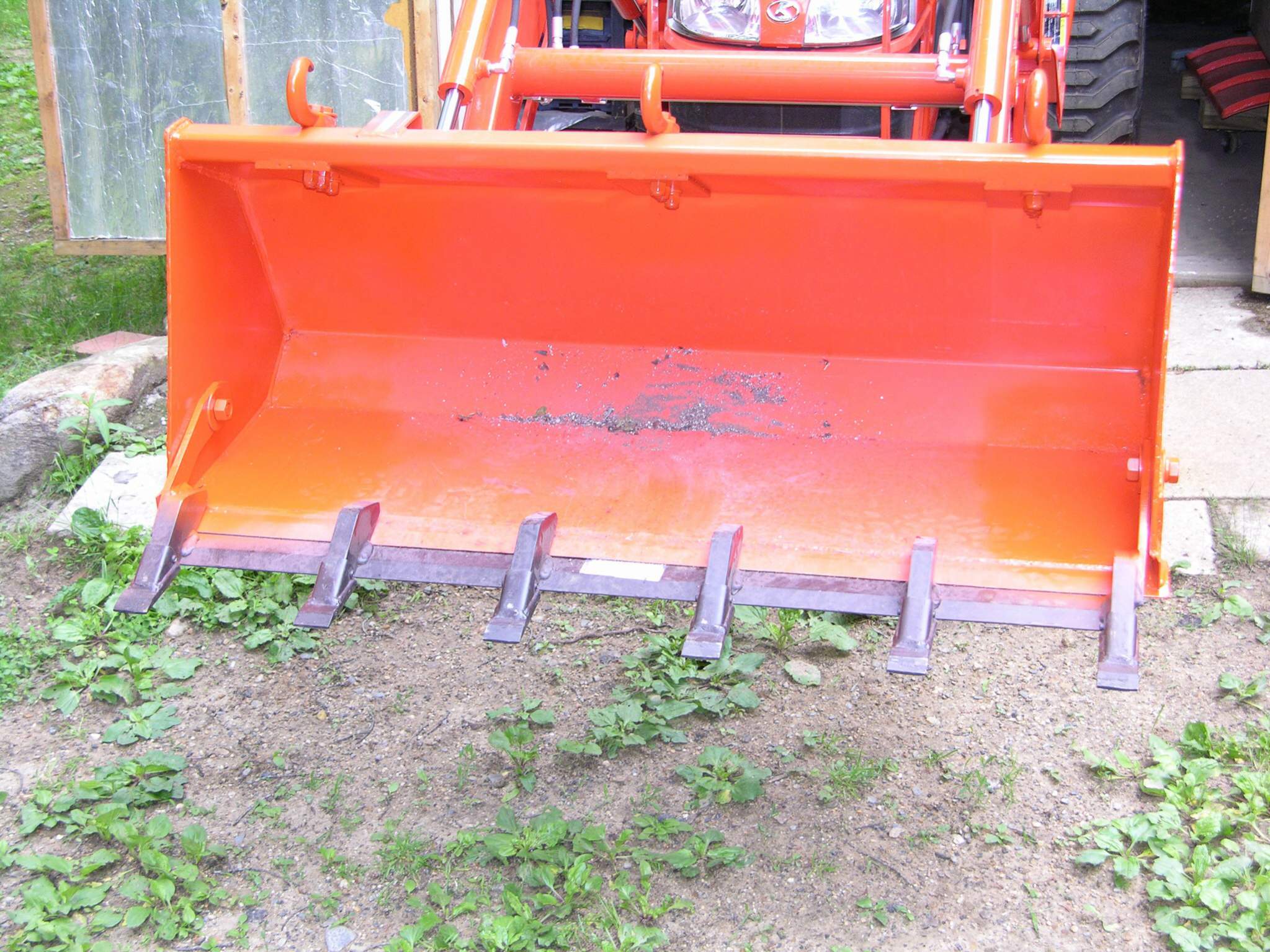

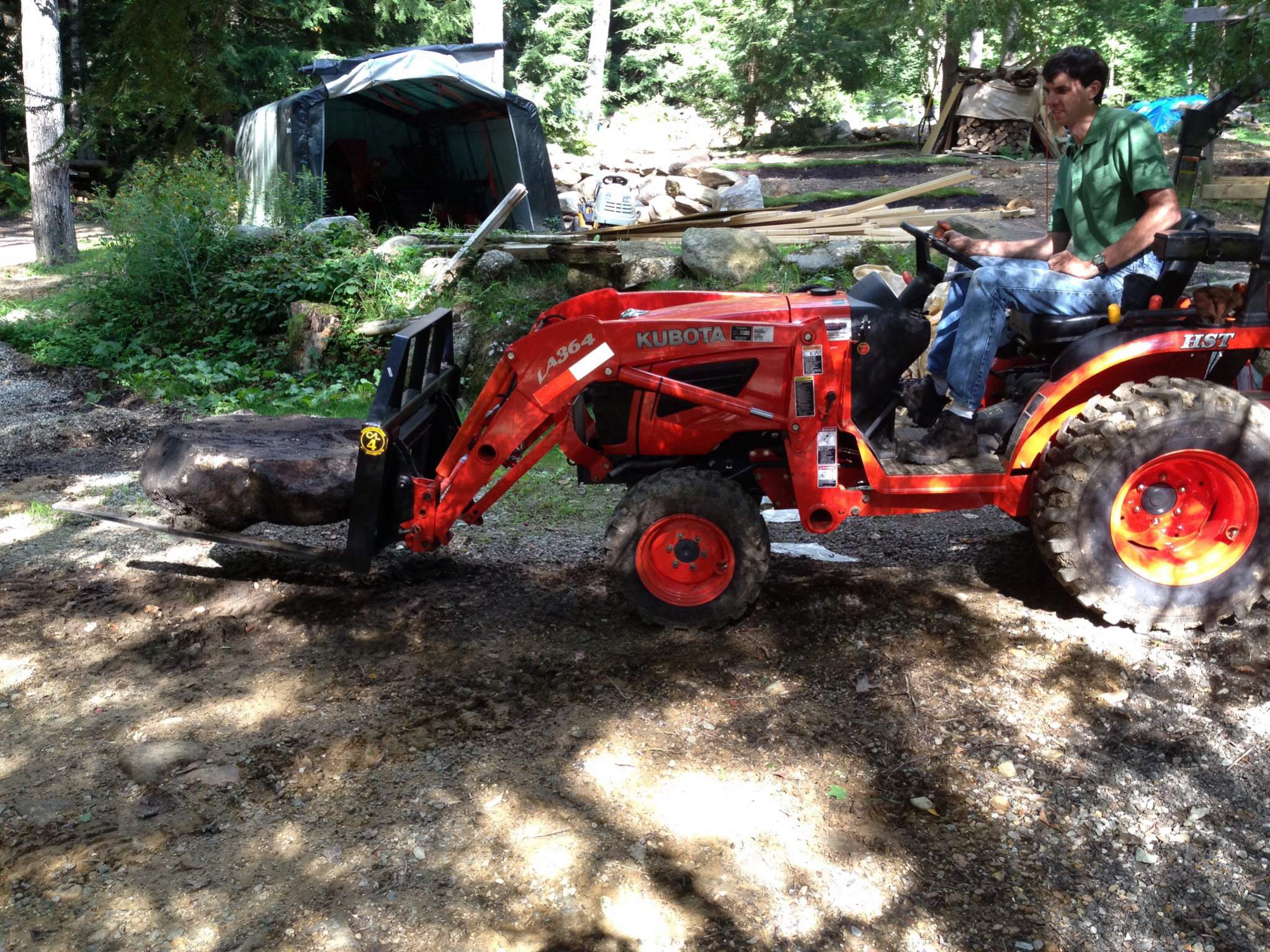

dano08 I don't know if the quick attach for the b2650 will fit on the la364 but I have Kubotas old quick attach that is made for the b3200 la504 loader and fits on the b2620 la364 loader. It works great on my b2620 TLB. I have four attachments I can put on the loader. standard 50" bucket,W.R.Long 48" OBG2 grapple, construction attachments 42" compact pallet forks,W.R.Long 60" front blade. Here is some pics cal2620.

Thanks for the pics. It definitely gives me an option but I am hoping for the kubota skid steer style. The good news is if the attachment you have was made for a 504 and it fits on your 364 then at least the pin spacing of a 364 & 504 are the same. Unless you had to make some modifications for it to fit?
/ Kubota SSQA on a LA364 loader? #4
no modifications have been done to the loader or the quick attach.

For now I am looking to buy a new bucket (54"). Don't know what to do with the old one, probably end up selling it off. It's a shame though, only used it for one load of gravel for the driveway and to move a bit of mulch and snow. Even got a tooth bar made for it. As fas as other ssqa, I looked around at others but kubota is asking around $480 for theirs so price wise I am going with kubota brand. Their price shocked me as well.

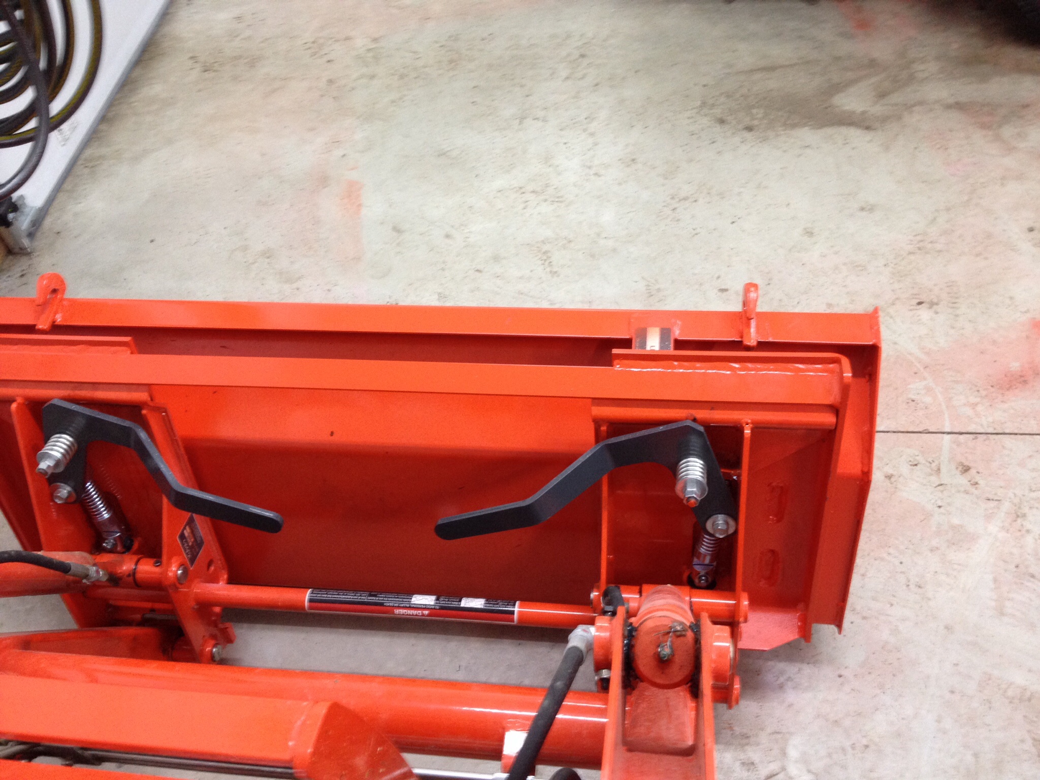

$100 for a plate and a little welding makes converting your existing bucket easy.
Universal Skid Steer Loader Weld on Quick Attach Adapter Plate Standard Duty | eBay
Don't try to cut your brackets "off" the back of the bucket, its a frustrating waste of time and energy. Cut around the bracket "thru" the back of the bucket leaving 2 rectangle windows. When you put the plate on it will cover the holes and give a good edge to weld to.

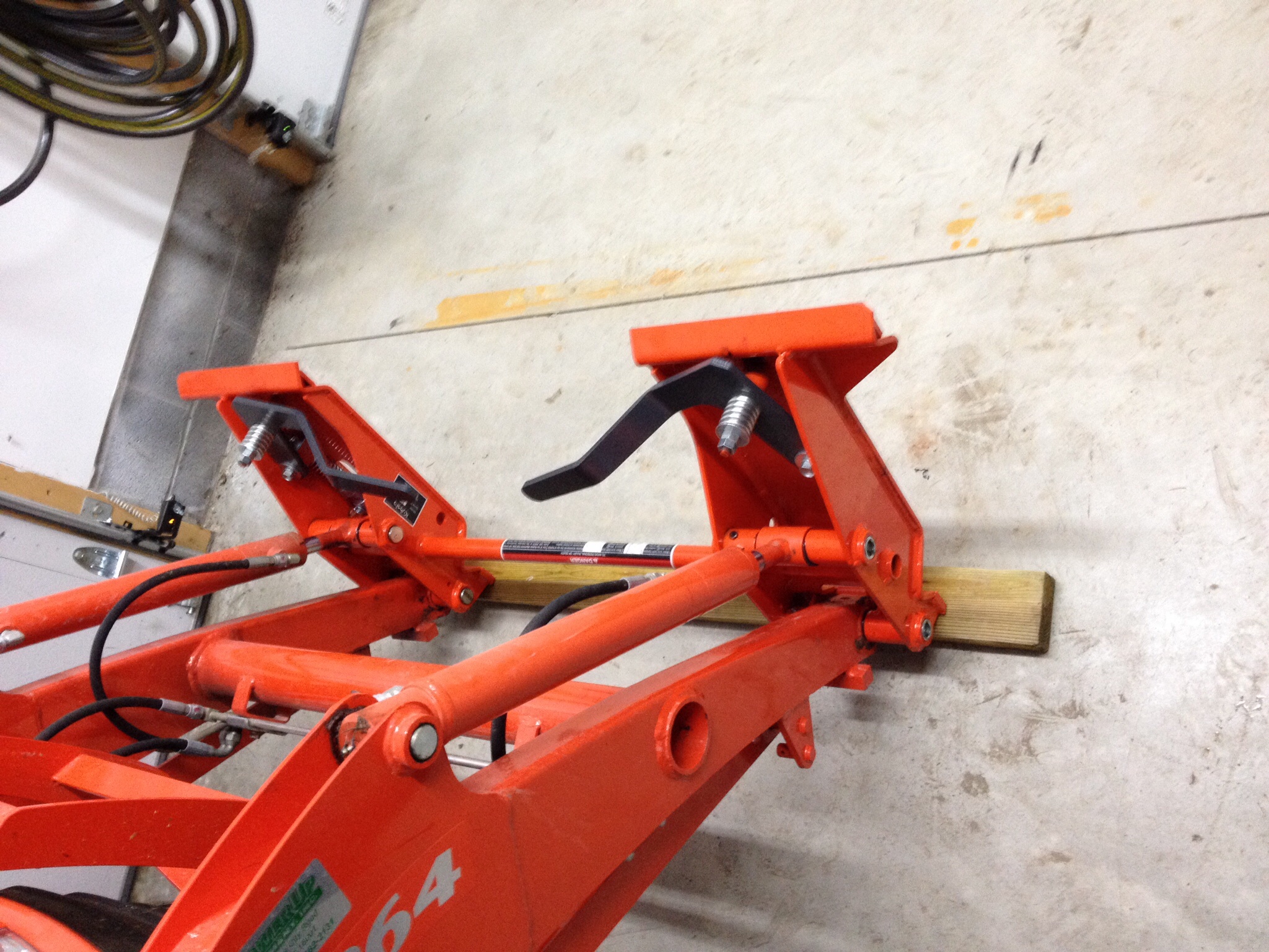

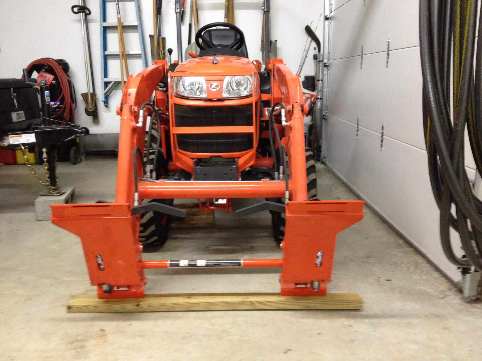

Thanks for all the help Sierradmax. I went out today and ordered my SSQA. I also decided to take bandaidmd advise and ordered a plate for my existing bucket. Figured since it has little use on it and a tooth bar I might as well keep it and use what I have plus save some $. Just have to wait till everything gets in and get to work on it.
#18
That is the exact same plate I ordered today. I even called them to make sure it would cover the pockets I cut when removing my pin set up. And it will. Hope yours works out for you. Post some pics after you have made the change.
/ Kubota SSQA on a LA364 loader? #19
Has there been any progress on this project? I'd like to see some pictures of the SSQA and the plates some of you have been using to convert the buckets.
#20
I will see if I can get some pics posted. But my project is done and it worked out great.
