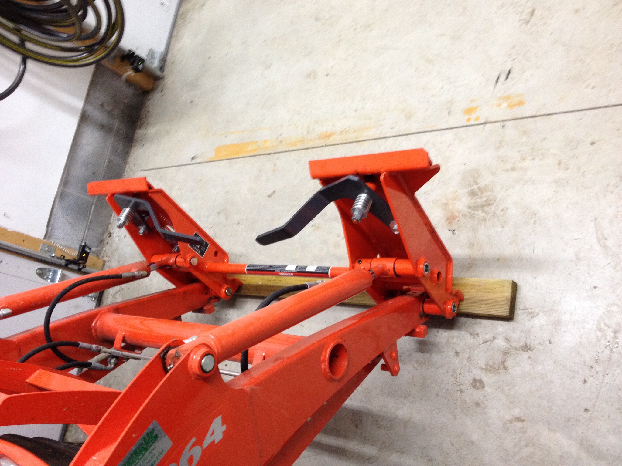

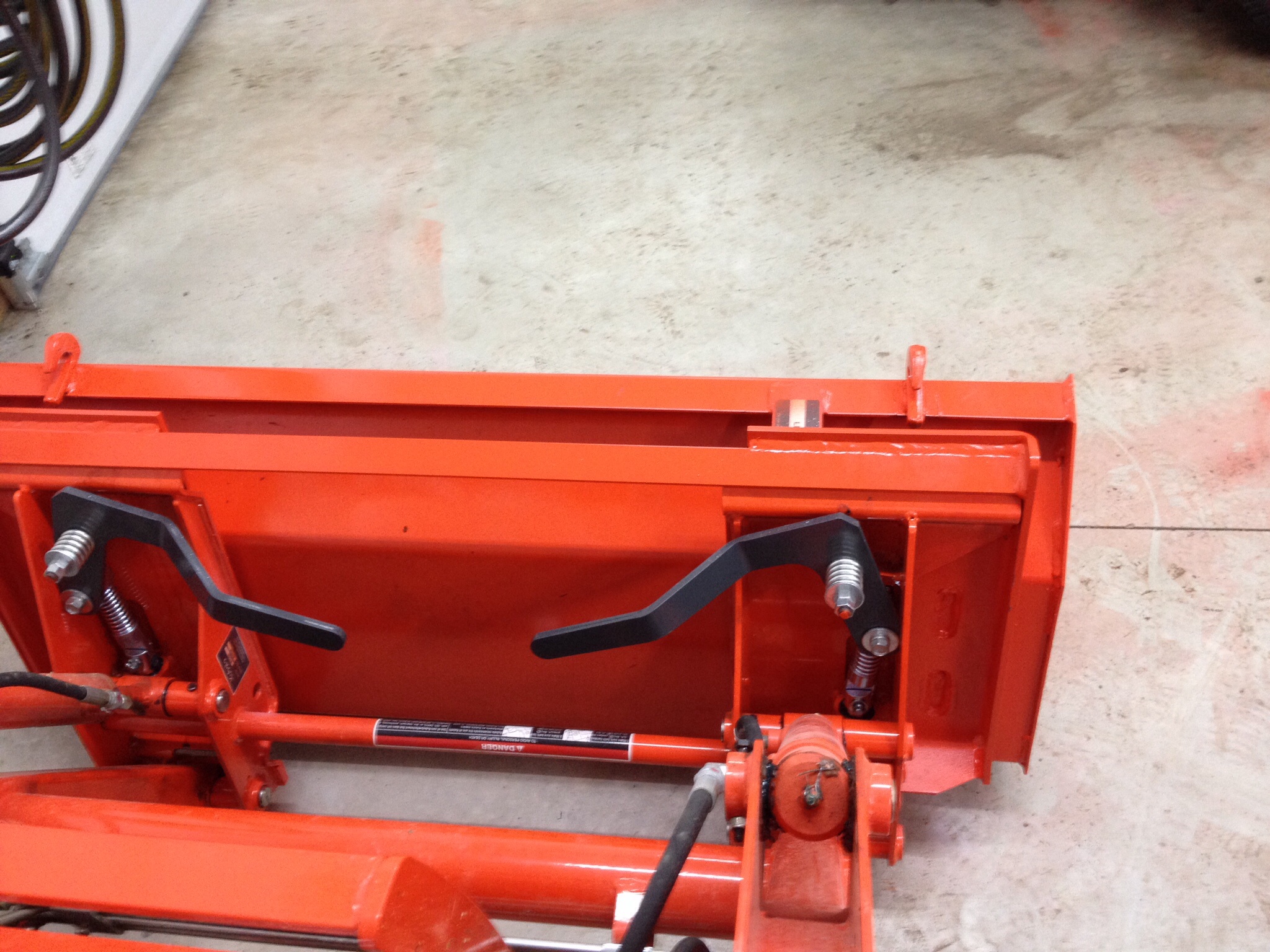

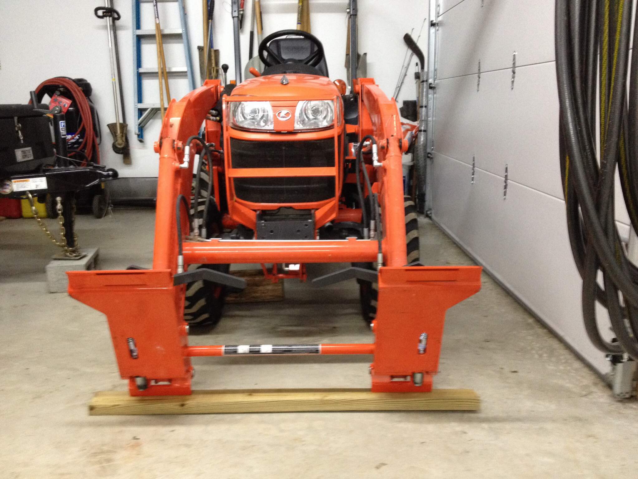

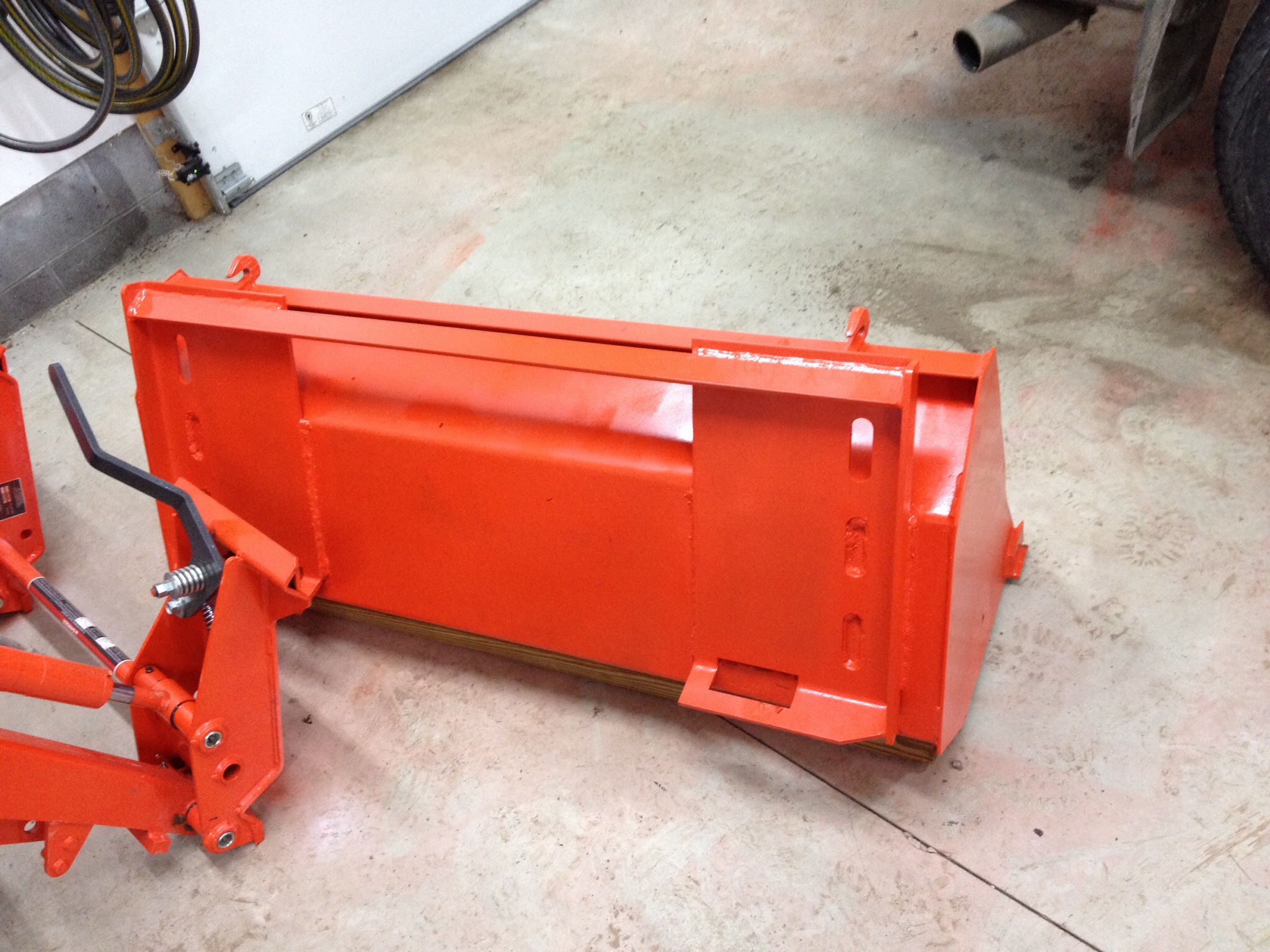

Here is how I did it:
- bought SSQA arms from Kubota (part #B2366)
- bought universal SSQA plate off ebay
- took out old bucket pins and removed old bucket
- put new Kubota SSQA arms on tractor (goes on easy, no modifications required)
- used gas powered chop saw and ran down existing welds on bucket brackets then hammer and chisel to remove brackets
- used hand grinder to clean up any remaining metal and to remove some paint where new welds will go.
- put new SSQA plate on Kubota SSQA arms
- slid the bucket up to the plate and marked with a sharpie where to weld the SSQA plate to the bucket (just remember to do it on level ground so you don't weld the plate on too low. I actually sat my arms on a 2x4 so it kept my plate up a little on the bucket)
- took SSQA plate off Kubota SSQA arms and welded to bucket
- hit with some primer then Kubota Orange II paint and called it done.
Total time spent on the project, about 6 hrs + beer breaks

TomSeller, I considered that as well, but with a 2620 I was worried about the added weight. I also wanted to be able to see the top of my existing bucket for leveling purposes. From the pics it looks to be in the way but when I sit on the tractor I see right over the plate and can see the top of my bucket. I have put it through the paces with some good snows and so far so good. Plus, there has been no issues with added weight.

Right, you did good. Mine was a bigger loader so weight was not an issue. Yours looks perfect. Nice work.

Finally posting a picture of my 48" bucket adapted with a SSQA bracket
