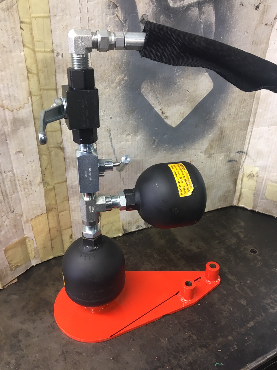

From the Kubota KRS kit only used the accumulators, one loader tube bracket and maybe eventually the control panel for a upper bracket.
From the hydraulic shop adapter nipples for the accumulators, tee, needle valve, ball valve and fitting for JIC-8 hydraulic line that will tee into bottom of the lift cylinder.
Mounting. The bottom orange mounting plate will be cut on the black line. Holes will be drilled to match the 3rd function mounting solenoid cover tabs inside the right loader tower. Might modify the KSR plate for another bolt. Also consider welding or bolting the KSR plate and 3rd function cover together for combined strength.
This might be a good time to add a gauge. I like measuring devices but the information can be confusing. Why manufacturers like simple gauges or idiot lights. A gauge on the lift cylinder can also be calibrated to tell how much weight you are lifting. Often used in big end loaders. Farm Show magazine had an article about a startup company making such a thing for tractors. Any feedback from others would be welcome.
Sorry not moving fast on this modifications but life seems to know when you are in a hurry.

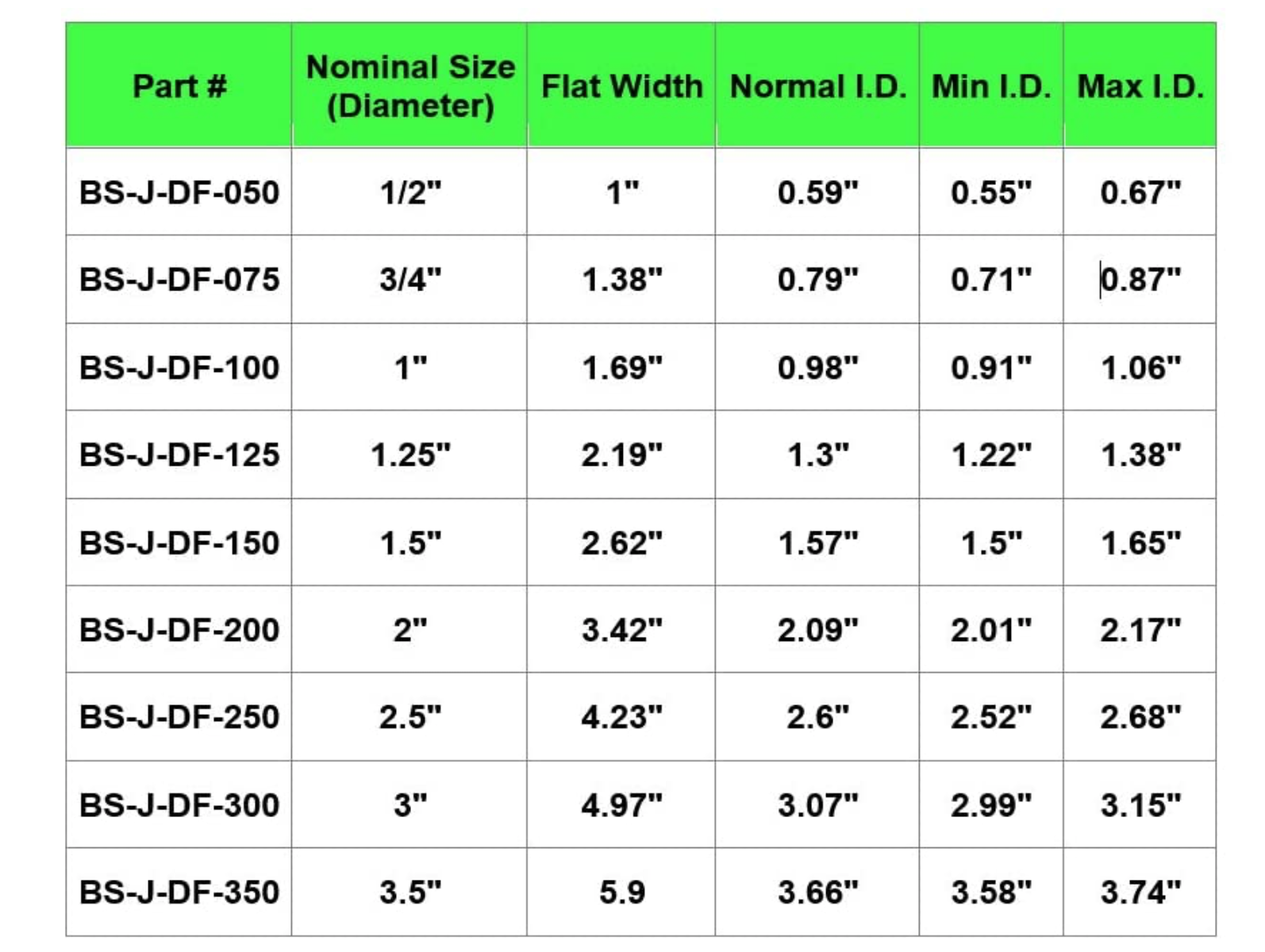

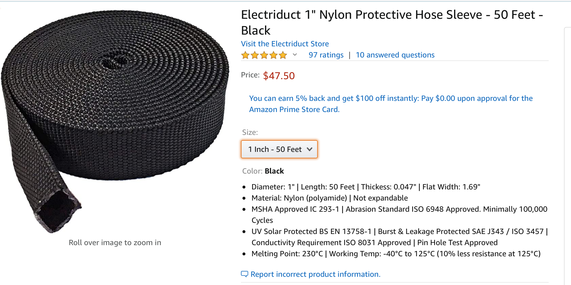

Your picture reminds me that I made myself this promise... Each time I unfastened the end of a hydraulic hose for any reason, I was going to add a length of nylon protective hose sleeve if it didn't already have one.The good sleeving is kind of expensive - about a dollar a foot - but for the price of the one hose I ruined reaching past a tree trunk, I could have bought quite a bit of hose. Even ignoring abrasion, just keeping the sun off the hose will probably double their life. Use a zip tie each end to secure it.
I found the covering below on Amazon. It's not the cheapest, but the specs looked good; so does the sleeving. And now I have it handy in the workshop just waiting... and waiting.....

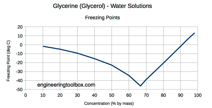

Pressure gauge:
A regular old pressure gauge in a Tee anywhere along the lift cylinder line at ought to give a ballpark convertible for static load. I've got one of those in my old JD which will lift about a ton. It's fun to watch, & my intention was to to put a measured weight in the center of the bucket to calibrate it, but haven't done so yet. So far the change in pressure with height is more interesting to watch. I was concerned that the pressure would spike driving over bumps and break the 5000 psi gauge, but that didn't happen. The real problem turned out to be the freezing point of the pure glycerin damping fluid.
Pressure gauge:

I'm thinking that the purpose of the glycerin is to not show the pressure spikes in order to protect the gauge mechanism.
